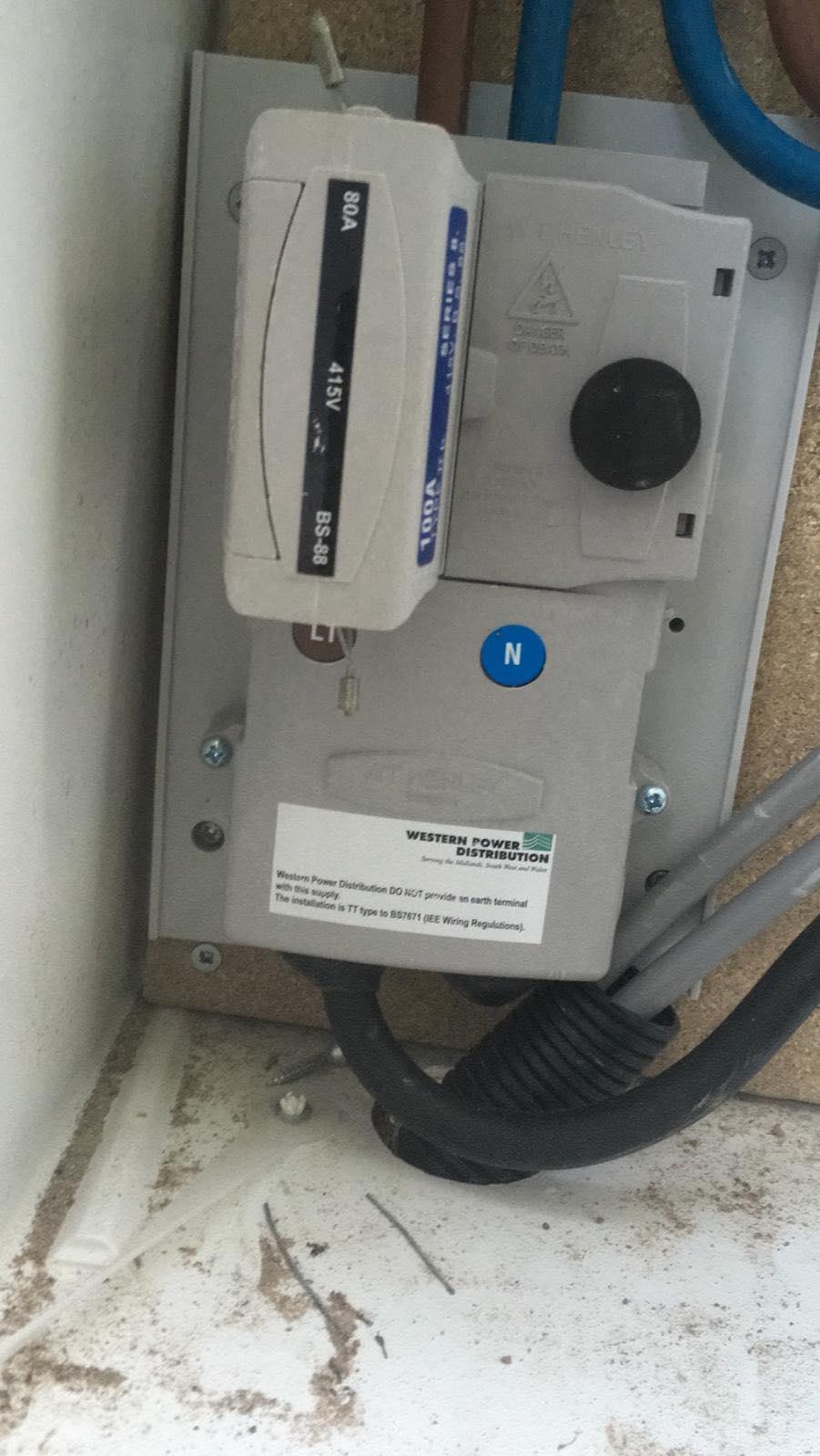

ProDave Posted July 29, 2019 Posted July 29, 2019 Do you KNOW you only have a 60A fuse? We were only offered a 12KVA supply which you would think came with a 60A fuse, but it connects to the same 100KVA transformer as all our neighbours houses, with the same size cable, and I asked the DNO when they installed the supply, what rating fuse they are fitting and they said "100 Amp" Happy days.
Roz Posted July 29, 2019 Author Posted July 29, 2019 On 29/07/2019 at 14:16, ProDave said: Do you KNOW you only have a 60A fuse? We were only offered a 12KVA supply which you would think came with a 60A fuse, but it connects to the same 100KVA transformer as all our neighbours houses, with the same size cable, and I asked the DNO when they installed the supply, what rating fuse they are fitting and they said "100 Amp" Happy days. Expand No idea....it's just what the electrician said. this says 80A on it?
Roz Posted July 29, 2019 Author Posted July 29, 2019 On 29/07/2019 at 14:21, Roz said: No idea....it's just what the electrician said. this says 80A on it? Expand oh it also says 100A around the side of this?
Jeremy Harris Posted July 29, 2019 Posted July 29, 2019 Unfortunately they all say 100 A on the fuse carrier, it's the rating of the actual fuse fitted inside that matters. This can't be accessed without breaking the seal, though. That does look as if it's fairly new and has an 80 A fuse, rather than a 60 A one, though.
Roz Posted July 29, 2019 Author Posted July 29, 2019 On 29/07/2019 at 14:24, JSHarris said: Unfortunately they all say 100 A on the fuse carrier, it's the rating of the actual fuse fitted inside that matters. This can't be accessed without breaking the seal, though. That does look as if it's fairly new and has an 80 A fuse, rather than a 60 A one, though. Expand If it was 80A would the 45A instant water heater be manageable? Recognise I might not be providing enough information I should ask Western Power what they installed I guess
Jeremy Harris Posted July 29, 2019 Posted July 29, 2019 On 29/07/2019 at 14:27, Roz said: If it was 80A would the 45A instant water heater be manageable? Recognise I might not be providing enough information I should ask Western Power what they installed I guess Expand If you can give that list of circuits that are being run from this supply then it's five minutes work to tell you the answer. It may be that your electrician has misread the main fuse as being 60 A rather than 80 A, but it's easy to calculate whether you can have the instant water heater connected without a priority switch. 1

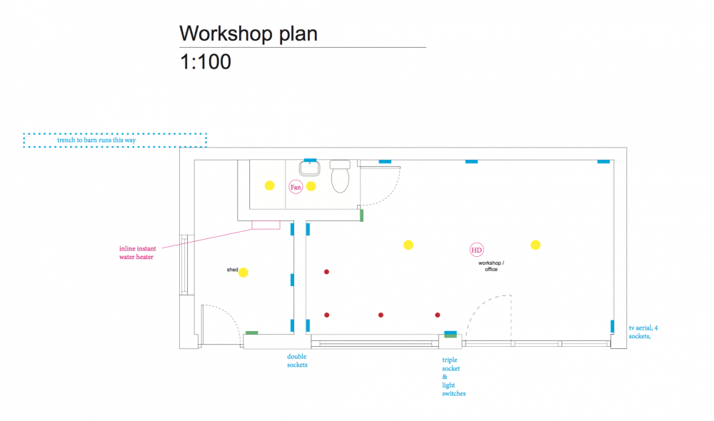

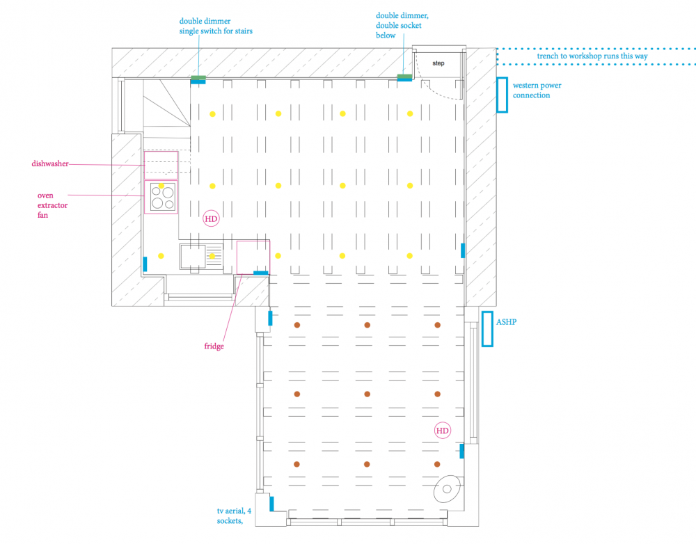

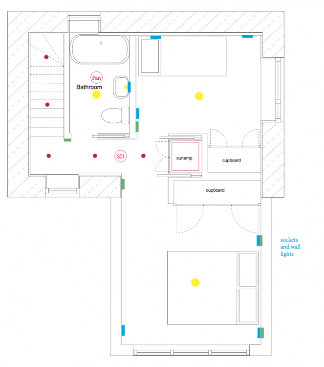

Roz Posted July 29, 2019 Author Posted July 29, 2019 (edited) On 29/07/2019 at 14:30, JSHarris said: If you can give that list of circuits that are being run from this supply then it's five minutes work to tell you the answer. It may be that your electrician has misread the main fuse as being 60 A rather than 80 A, but it's easy to calculate whether you can have the instant water heater connected without a priority switch. Expand So I don't totally know the answer to this but I can list what we have going on House: 3 areas of downlights (one room but two areas that you can switch on and off separately, plus landing/stairs) Various plug sockets Oven Fridge Dishwasher 2 bedrooms each with a pendant and plug sockets, one with wall lights too Bathroom with shaver socket, extraction fan, main light Air Source Heat Pump direct to underfloor heating Sunamp for domestic hot water direct electricity overnight no water tank Outdoor socket Studio: (have been told it will have its own consumer unit but will be run off same house supply) 1 pendant light 2 pendant lights same switch various plug sockets washing machine Inline water heater Is that enough info? Edited July 29, 2019 by Roz
Jeremy Harris Posted July 29, 2019 Posted July 29, 2019 On 29/07/2019 at 14:36, Roz said: So I don't totally know the answer to this but I can list what we have going on House: 3 areas of downlights (one room but two areas that you can switch on and off separately) Various plug sockets Oven Fridge Dishwasher 2 bedrooms each with a pendant and plug sockets, one with wall lights too Bathroom with shaver socket, extraction fan, main light Air Source Heat Pump direct to underfloor heating Sunamp for domestic hot water direct electricity overnight no water tank Outdoor socket Studio: (have been told it will have its own consumer unit but will be run off same house supply) 1 pendant light 2 pendant lights same switch various plug sockets washing machine Inline water heater Is that enough info? Expand It's really the circuits coming from the consumer unit that are needed. You should have a set of circuit breakers that are labelled, one for each circuit. Typically these would be something like two ring final circuits (maybe upstairs and downstairs) with 32 A MCBs, two lighting circuits, again upstairs and downstairs, with 6 A MCBs, a circuit for the ASHP (need the rating of the MCB, probably about 16 A I suspect), the cooker circuit (typically about 40 A), the water heater circuit (probably about 50 A), The Sunamp circuit (probably 16 A). If you can check what you have in the consumer unit then it's a pretty quick job to do the diversity sums and see what the maximum load is.
Roz Posted July 29, 2019 Author Posted July 29, 2019 On 29/07/2019 at 14:30, JSHarris said: If you can give that list of circuits that are being run from this supply then it's five minutes work to tell you the answer. It may be that your electrician has misread the main fuse as being 60 A rather than 80 A, but it's easy to calculate whether you can have the instant water heater connected without a priority switch. Expand When the electrician rang he definitely said 60A but I have just seen a text from him that says 80A, so there's some confusion!
Jeremy Harris Posted July 29, 2019 Posted July 29, 2019 On 29/07/2019 at 14:44, Roz said: When the electrician rang he definitely said 60A but I have just seen a text from him that says 80A, so there's some confusion! Expand 80 A might still be too low to allow the water heater to be connected without a priority switch, best to check. If you can take a photo of the consumer unit then that should show all the circuits well enough to do the sums.
Roz Posted July 29, 2019 Author Posted July 29, 2019 (edited) On 29/07/2019 at 14:46, JSHarris said: 80 A might still be too low to allow the water heater to be connected without a priority switch, best to check. If you can take a photo of the consumer unit then that should show all the circuits well enough to do the sums. Expand We haven’t got our consumer unit yet as the main house isn’t done. We just have a little garage consumer unit I think so we have a power socket running off that. We are trying to complete the studio first so we have somewhere to sleep while we finish the rest would the priority switch just give priority to everything else over the water heater to save things tripping? Edited July 29, 2019 by Roz
Jeremy Harris Posted July 29, 2019 Posted July 29, 2019 On 29/07/2019 at 14:52, Roz said: We haven’t got our consumer unit yet as the main house isn’t done. We just have a little garage consumer unit I think so we have a power socket running off that. We are trying to complete the studio first so we have somewhere to sleep while we finish the rest would the priority switch just give priority to everything else over the water heater to save things tripping? Expand OK, so I'm guessing here that your electrician is planning ahead and has worked out that the sum of the loads, allowing for diversity, exceeds the 80 A fuse. I've listed what I'm guessing you may have in the consumer unit (once it's fitted): 1 off ring final circuit at 32 A, allowing for diversity = 10 A + (50% of (32 A - 10 A))) = 21 A (these are your 13 A outlets, I'm assuming there will be only one circuit as the house is a modest size - need the number of outlets to do a proper calculation, really. If your floor area exceeds 100m² then you need a second ring final circuit) 1 off lighting circuit at 6 A, allowing for diversity = 6 A x 66% = 3.96 A (same assumption as above, just one circuit assumed) 1 off Sunamp circuit at 16 A, allowing for diversity and assuming the heating element is rated at 3 kW = 13 A 1 off ASHP circuit at 16 A (need to check this, and need power rating of ASHP) = probably around 10 A (could be a bit lower) 1 off electric water heater at 60 A (48 A appliance load, no diversity allowable) = 48 A 1 off cooker circuit at 40 A (might be 32 A, or could possibly be 50 A, need the maximum power on the appliance(s) label(s)), allowing for diversity = 10 A + (30% x 30 A) = 19 A (add 5 A to this if there is a socket on the cooker outlet switch plate). The sum of all the above comes to 21 A + 3.96 A + 13 A + 10 A + 48 A + 19 A = 114.96 A This is way over the 80 A supply limit, and also way over a 100 A supply limit too. Fitting a priority load switch so that the cooker and electric water heater share the same circuit (needs care over circuit protection devices to do this) would allow you to stay under the 80 A limit, but would mean that the cooker and the electric water heater couldn't be used at the same time. You can choose which you wish to take priority over the other. The alternative is to get rid of the water heater. There isn't enough spare capacity (based on the rough and ready estimates above) to allow any reasonable size of instant water heater to work OK really. Without the water heater the maximum demand comes down to about 67 A, well within the limit of the supply. 1
Roz Posted July 29, 2019 Author Posted July 29, 2019 On 29/07/2019 at 15:16, JSHarris said: OK, so I'm guessing here that your electrician is planning ahead and has worked out that the sum of the loads, allowing for diversity, exceeds the 80 A fuse. I've listed what I'm guessing you may have in the consumer unit (once it's fitted): 1 off ring final circuit at 32 A, allowing for diversity = 10 A + (50% of (32 A - 10 A))) = 21 A (these are your 13 A outlets, I'm assuming there will be only one circuit as the house is a modest size - need the number of outlets to do a proper calculation, really) 1 off lighting circuit at 6 A, allowing for diversity = 6 A x 66% = 3.96 A (same assumption as above, just one circuit assumed) 1 off Sunamp circuit at 16 A, allowing for diversity and assuming the heating element is rated at 3 kW = 13 A 1 off ASHP circuit at 16 A (need to check this, and need power rating of ASHP) = probably around 10 A (could be a bit lower) 1 off electric water heater at 60 A (48 A appliance load, no diversity allowable) = 48 A 1 off cooker circuit at 40 A (might be 32 A, or could possibly be 50 A, need the maximum power on the appliance(s) label(s)), allowing for diversity = 10 A + (30% x 30 A) = 19 A (add 5 A to this if there is a socket on the cooker outlet switch plate). The sum of all the above comes to 21 A + 3.96 A + 13 A + 10 A + 48 A + 19 A = 114.96 A This is way over the 80 A supply limit, and also way over a 100 A supply limit too. Fitting a priority load switch so that the cooker and electric water heater share the same circuit (needs care over circuit protection devices to do this) would allow you to stay under the 80 A limit, but would mean that the cooker and the electric water heater couldn't be used at the same time. You can choose which you wish to take priority over the other. The alternative is to get rid of the water heater. There isn't enough spare capacity (based on the rough and ready estimates above) to allow any reasonable size of instant water heater to work OK really. Without the water heater the maximum demand comes down to about 67 A, well within the limit of the supply. Expand Gosh, thanks for that Jeremy! So even if we brought the water heater / electric shower down to 30 amps it still wouldnt be OK. So the only option is to run them on the same circuit (starting to understand this, thanks), but can this be done if the cooker is in the house and the water heater is in the studio which has its own consumer unit (i think)? It's not an ideal situation anyway. I wanted an instant water heater to avoid the installation costs of an unvented cylinder, plus the studio will be used irregularly once we are in the main house. I'm starting to think we should have buried a hot water pipe between the house and the studio so it could just use the regular hot water from the house. At the time we didn't think this was worth it as the studio would be done first, but an installer told us we could have just installed the sunamp in the studio and then moved it over into the house when we were ready. Now a;; the ground is back in place so would mean re-digging (7 metres or so) For installing a say 90L unvented cylinder (?) would we be looking at hundreds in labour?
Jeremy Harris Posted July 29, 2019 Posted July 29, 2019 The maximum rating for any water heater (if the assumptions I've made above as to the loads is accurate - it may not be!) would be 13 A, just about enough for an immersion heater, but not enough for an instant water heater. If you can get the supply uprated to 100 A, then you have about 33 A available, so could then install a 7.5 kW instant water heater. This all depends on the actual loads you have though - if you have two ring final circuits and two lighting circuits the load will increase a fair bit. Splitting a priority load switch across two locations is possible, but not ideal, really, as it would make things a bit messy. A lot depends on the physical arrangement of the studio relative to the main house. Also, if the studio has it's own power and lighting circuits on a separate consumer unit, fed from the same incoming main fuse, then these have to be added to the load calculation above, so will impact on the total load and may even take you close to, or over, the allowable limit with an 80 A fuse, without any water heater. Do you know what the input power rating of the ASHP and the cooker is? I've just guessed numbers for those, so may have over-estimated. Also, do you know the floor area of the house? If over 100m² then two ring final circuits may be needed, in addition to any circuits in the studio.
