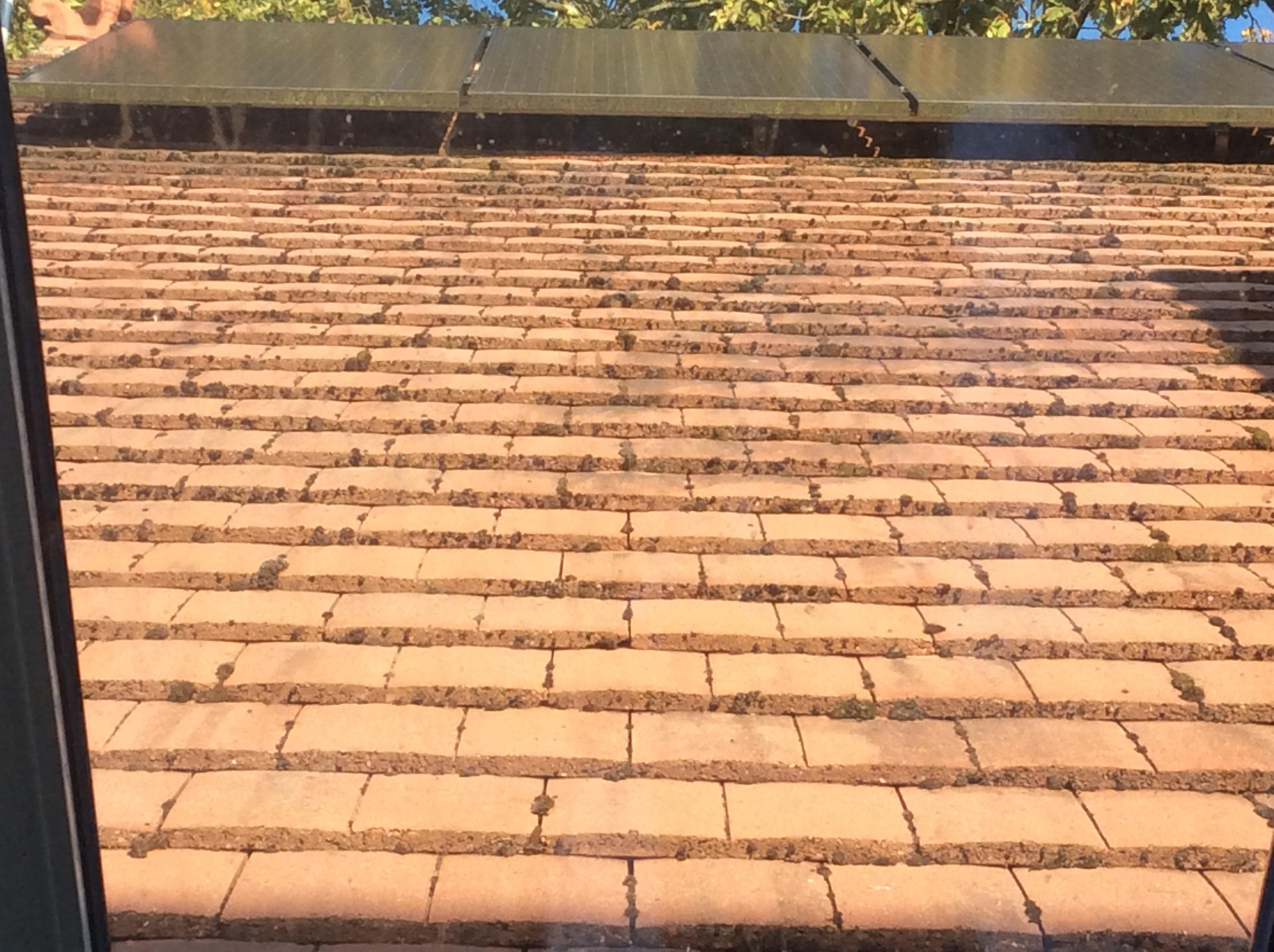

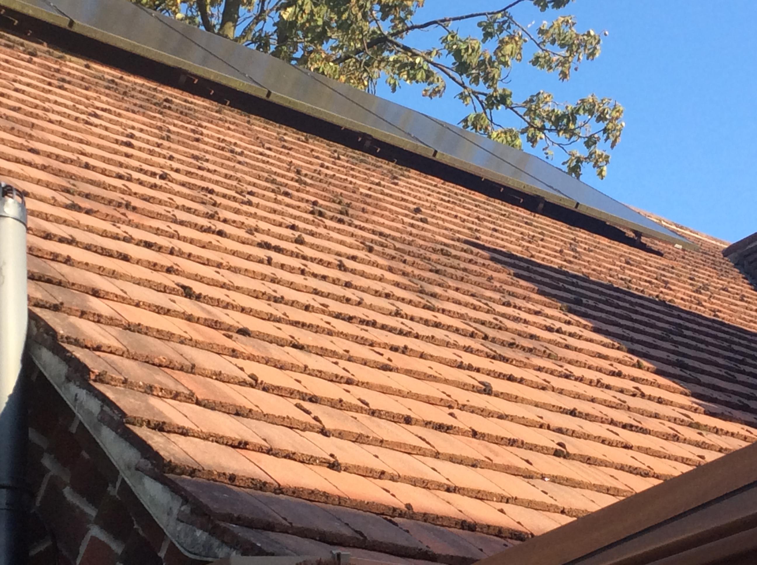

Ferdinand Posted September 13, 2020 Share Posted September 13, 2020 (edited) incidentally, the sun is out so I popped out for a couple of photos of the same roof. To me the larger clumps of Moss are fewer, and it seems to have kept it down. For a roof which is very tricky to access ... top is at about 8-9m and there is a conservatory right across the bottom, I a. Reasonably happy with that. Edited September 13, 2020 by Ferdinand Link to comment Share on other sites More sharing options...

Ferdinand Posted July 12, 2021 Share Posted July 12, 2021 Updating this. What my tile roof look likes 2 years after treatment with copper sulphate solution and a Super Soaker. I'm surprised at the extent of contrast, but it certainly seems to have worked to keep the moss down. EIther it is strong enough to have bleached the tiles a little, or killed small bio-wotsits that darken the roof a little, or similar. I think I need to try with a weaker solution or a more precise instrument if I am to do it again, particularly if I try the front which is seen from the lane. 1 Link to comment Share on other sites More sharing options...
