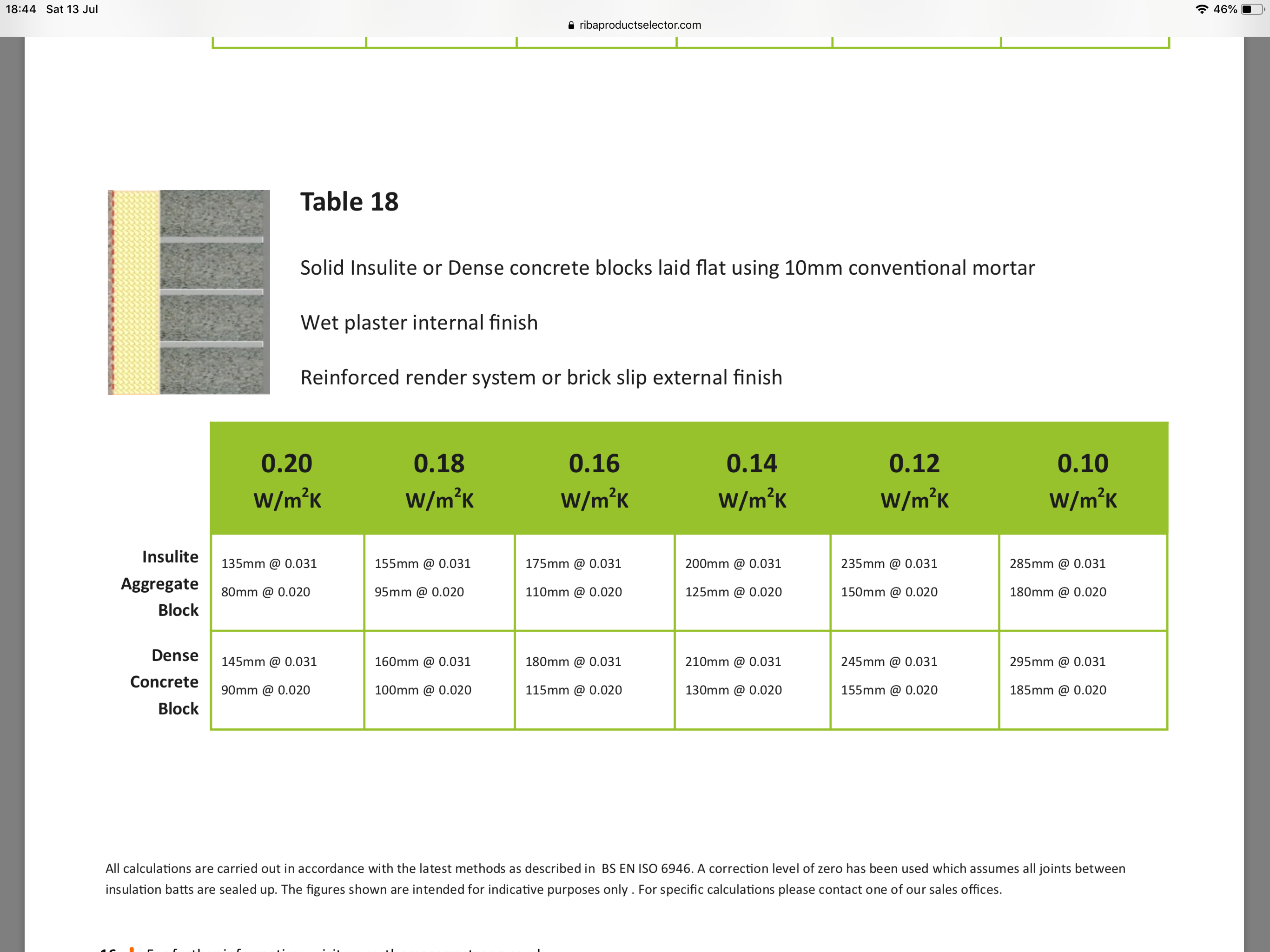

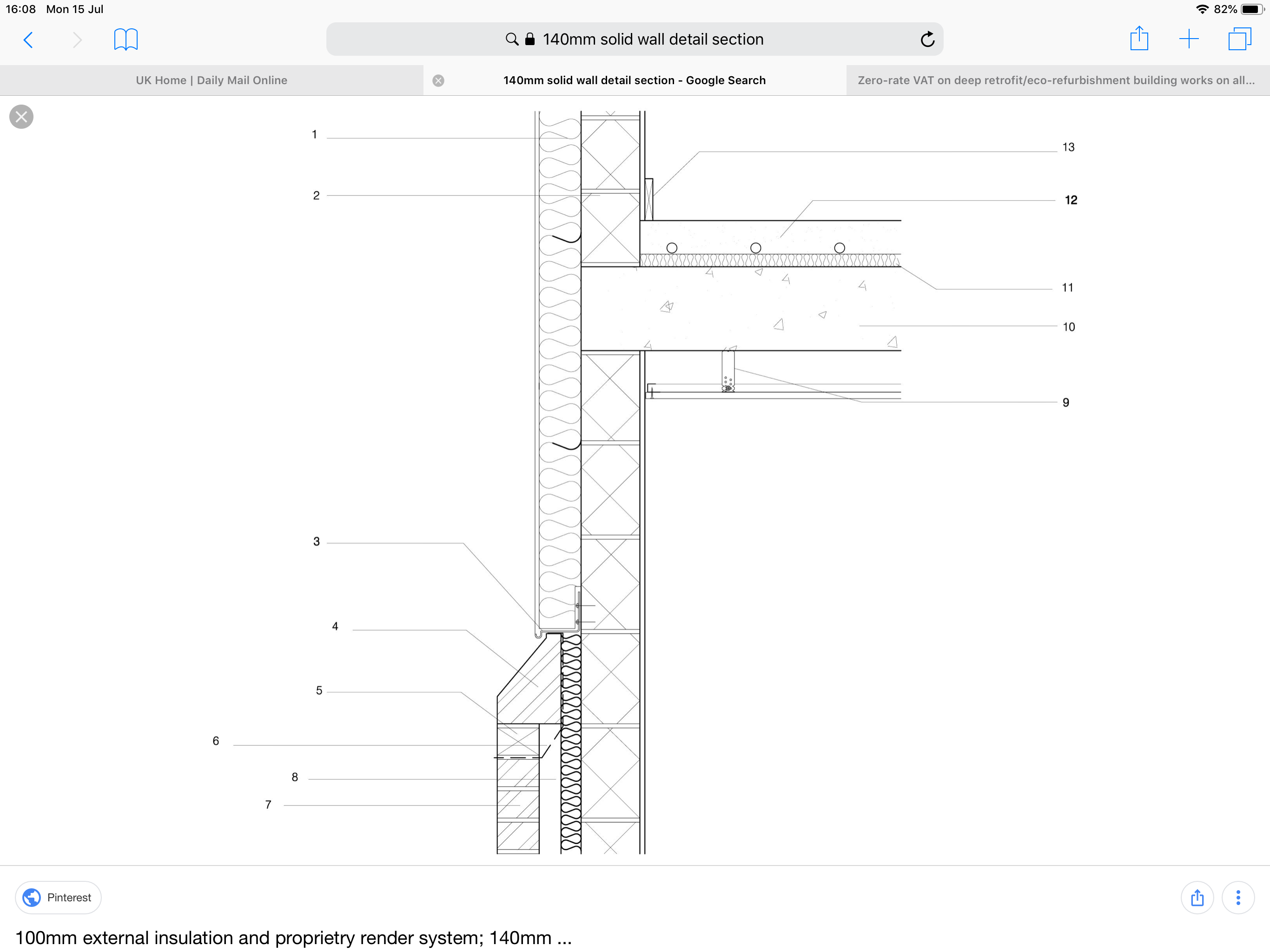

K78 Posted July 16, 2019 Share Posted July 16, 2019 I’m really struggling to find section details of 140mm block walls with EWI. This is all my search has uncovered. Can anyone point me in the right direction? Thanks Link to comment Share on other sites More sharing options...
PeterW Posted July 16, 2019 Share Posted July 16, 2019 What are you actually looking for ..?? structural designs..?? BBA approved designs ..?? Standard details only work where you have a standard build (think developer / NHBC) and are only useful to illustrate a point. If you are planning to use this design - which would need Insulation both sides from what we have discussed previously - then your architect / Structural Engineer need to sign off on it or produce the calculations needed. Once you have that, and you are using the manufacturers standard installation methods for the insulation, you have everything you need. Link to comment Share on other sites More sharing options...

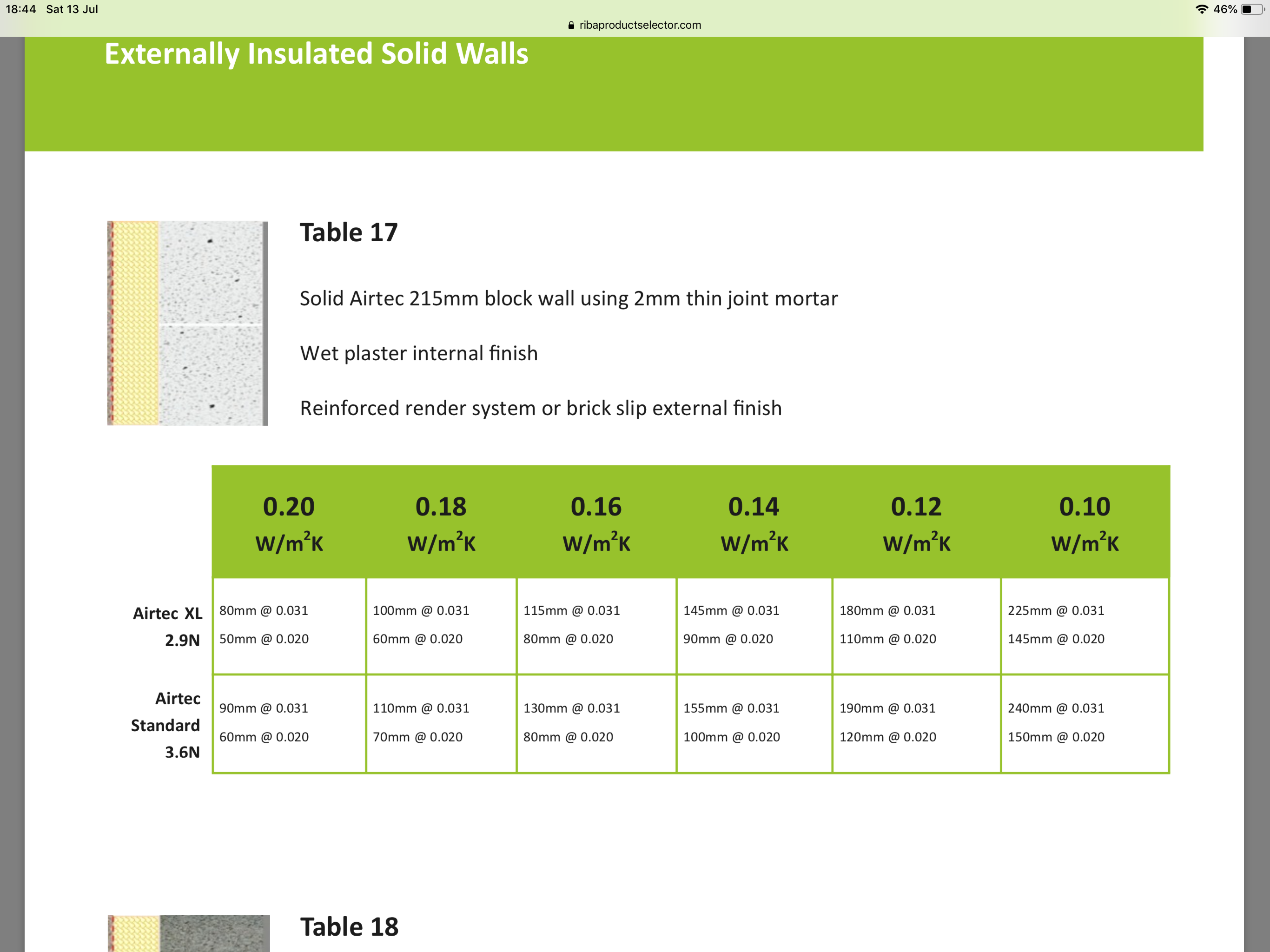

K78 Posted July 16, 2019 Author Share Posted July 16, 2019 I wanted something to show a builder I’ve been discussing it with. He’s not convinced and says it should be 215mm (block laid flat). He says that BC won’t like 140mm without a approved detail. Ive read similar on another forum which is why I was considering joining the AECB. They have silver standard examples of 140mm externally insulated walls. Link to comment Share on other sites More sharing options...
Miek Posted July 16, 2019 Share Posted July 16, 2019 140mm is the minimum width for a two storey single skin IIRC. But 140 is non standard and costs more so it can be simpler to use a standard 215 block instead. 1 Link to comment Share on other sites More sharing options...
K78 Posted July 16, 2019 Author Share Posted July 16, 2019 1 hour ago, Miek said: 140mm is the minimum width for a two storey single skin IIRC. But 140 is non standard and costs more so it can be simpler to use a standard 215 block instead. This is exactly what I’ve been thinking today. No need for internal insulation either which I really want to avoid. Less problems if I ever sell too. Link to comment Share on other sites More sharing options...

PeterW Posted July 16, 2019 Share Posted July 16, 2019 Cost of fixing system will start to outweigh your thicker insulation costs. Also consider final finish on the insulation and how you will manage windows and doors. 215 on flat will be 50% more expensive on blocks and mortar too. 1 Link to comment Share on other sites More sharing options...
Miek Posted July 17, 2019 Share Posted July 17, 2019 I looked into building to passive standard with single skin and EWI thinking it would be cheaper and simpler. But I changed my mind and went for a 300mm full fill cavity instead. EWI to passive thickness was a bit pricey and quite a fiddle to install, also needs more specialist trades when compared to a cavity build which is far more common. I also felt that external block and render was more durable than the thin coat EWI render systems, and far easier to fix things to, like downpipes or overhead cables. 1 Link to comment Share on other sites More sharing options...
K78 Posted July 17, 2019 Author Share Posted July 17, 2019 (edited) 19 hours ago, PeterW said: Cost of fixing system will start to outweigh your thicker insulation costs. Also consider final finish on the insulation and how you will manage windows and doors. 215 on flat will be 50% more expensive on blocks and mortar too. The blocks are a higher expense no doubt. I can get 100mm locally for 90p but the cheapest 140mm I can find are £1.60. I’m sure I can find a better price on the 140mm. My windows are big so I’m not too worried about lack of light. I’d have them sat in boxes situated between the wall and insulation. Doors ive not thought about tbh. Finish will be timber cladding with insulation between batons. 2 x 50mm (horizontal then vertical) rather than 1x 100mm. Edited July 17, 2019 by K78 Link to comment Share on other sites More sharing options...

K78 Posted July 17, 2019 Author Share Posted July 17, 2019 2 hours ago, Russell griffiths said: You don’t need a baton at all you are thinking house when you need to think office block, lots of commercial systems that use aluminium bars fitted to the outside of the insulation with long fixings, I think a lot use a counter bracket fitted through the insulation. Still not convinced on your 140mm blocks, good luck getting someone to lay them. ‘I’m going 215mm. The saving isn’t worth the hassle. Link to comment Share on other sites More sharing options...
