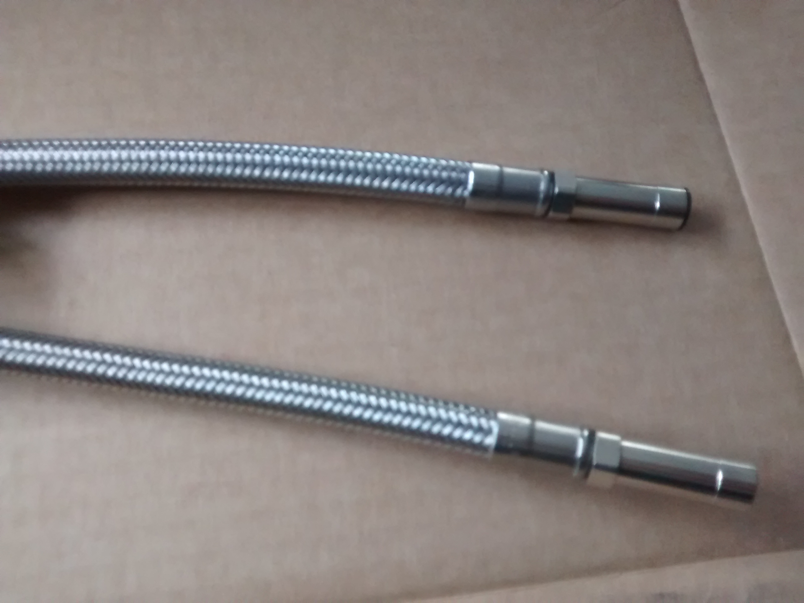

JanetE Posted September 19, 2016 Posted September 19, 2016 (edited) We've got this continental tap with these connectors and I'm struggling to work out how to connect them to our hep20 pipework. They are 10mm. I've tried the hep20 connectors the metal is too hard and they don't work. Suggestions gratefully received. Edited September 19, 2016 by JanetE
PeterW Posted September 19, 2016 Posted September 19, 2016 One of these... http://www.screwfix.com/p/reducing-coupler-fitting-15mm-x-10mm/51238 Either stick the Hep20 into it, or use a short length of copper then into a standard Hep20 coupler
TerryE Posted September 19, 2016 Posted September 19, 2016 Thanks Peter, I've already advised Jan that you can use any push fit connectors with chromed fitting as the chrome surface is too hard fro the steel ring to bite. I've also read compression fitting work OK, but that you should use brass olives and PTFE. We've got 5 basins in the new house with M10 monoblock mixers and the connections for 4 of these are hidden by boxing -in or semi-pedestals. The last has a bottom hung shower mixer on it, so the chromed M10 connectors will be visible so we've been looking for something like this (though this one is designed for PEX): The valve isn't really necessary since the other end is connected to a HEP2O manifold, but it's the general look that we are seeking.
Nickfromwales Posted September 19, 2016 Posted September 19, 2016 11 hours ago, JanetE said: We've got this continental tap with these connectors and I'm struggling to work out how to connect them to our hep20 pipework. They are 10mm. I've tried the hep20 connectors the metal is too hard and they don't work. Suggestions gratefully received. Just bin those and buy some standard flexis ?
TerryE Posted October 8, 2017 Posted October 8, 2017 A year later and we are just finishing the fit out of or last ensuite, and we have the issue of what to do to finish the Duravent wall hung basin. We chose a one that doesn't come with a semi-pedestal, because Jan has chosen a monobloc tap with hand shower attachment. So now we have an immaculate wetroom ensuite with the guts of the under-basin exposed. We've got a nice smart chrome waste, and we are now faced with the challenge of how to mount flexible tap connectors to the supply without the overall effect looking totally naff. The best way if I had thought this through properly would have been to terminated the 15mm tails with a pair of tile-flush ½" BSP female tap connectors and use a pair of the vales shown below (or the like ). However, I don't have a Tardis and the tiling has been done so there is no simple way to add one even if we use a deeper cover plate. So the only thing that I can think of is using a pairs of the shower plate mounts that slip over the 15mm tails and present a pair of ¾" BSP male heads. I can get 10mm × ½" BSP female flexible connectors and also a pair of 90° ¾" BSP female to ½" BSP male chrome elbow, but I feel that this will still look naff. Has anyone, esp the Welsh wizard (a.k.a. @Nickfromwales) have a better idea.

JanetE Posted October 8, 2017 Author Posted October 8, 2017 @Temp I think that this is the perfect solution
Nickfromwales Posted October 8, 2017 Posted October 8, 2017 11 minutes ago, JanetE said: Copper 15mm coming out of the wall Bingo. ??
