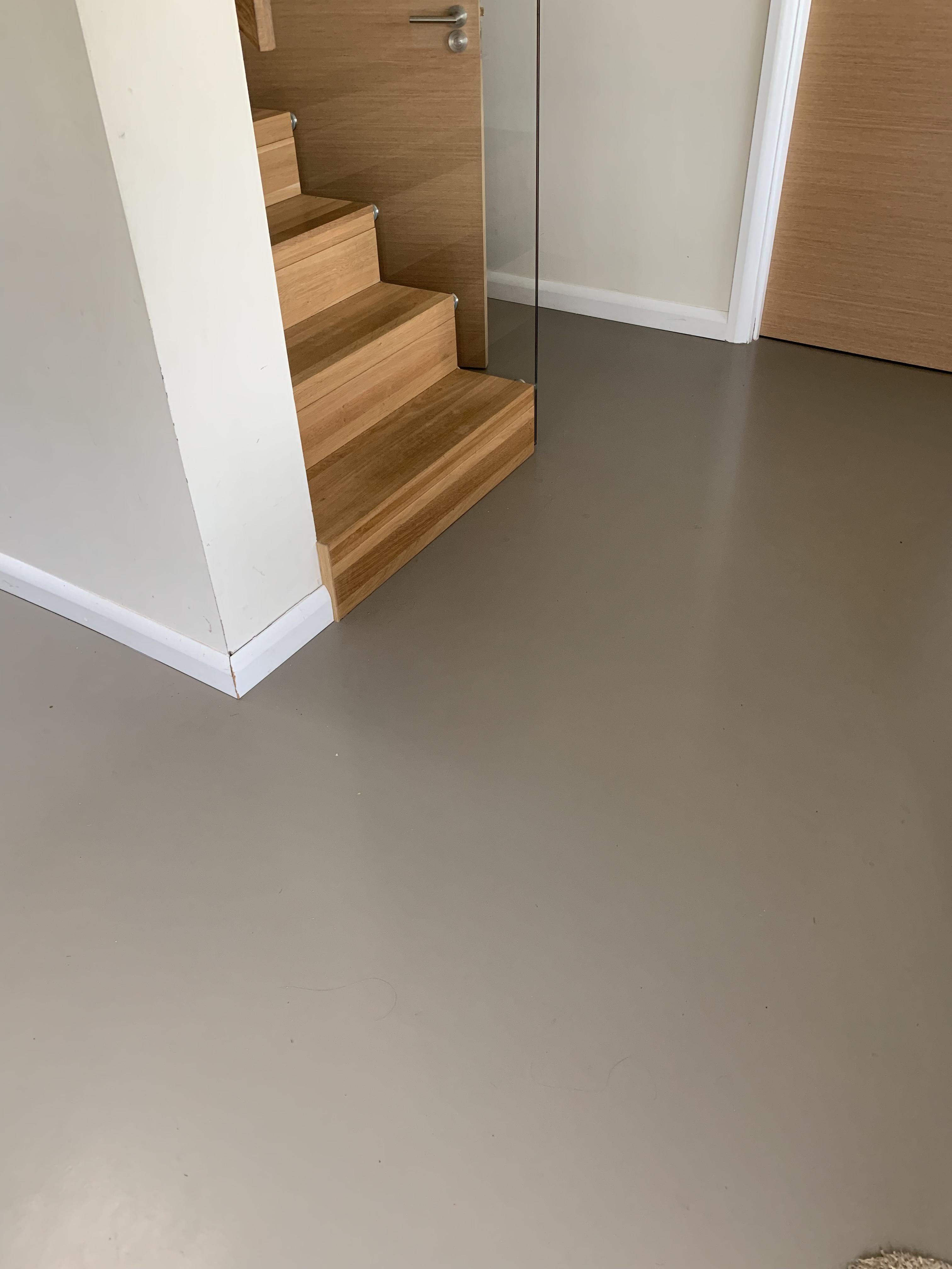

Big Jimbo Posted July 9, 2019 Share Posted July 9, 2019 On 08/07/2019 at 14:52, Bitpipe said: I put UFH in my suspended floor but had it underneath the floor deck on alu spreader plates. We put a resin floor on top (ply subfloor to minimise flexing). Is your UFH constrained to that area? Bitpipe. Show us your resin floor please. Link to comment Share on other sites More sharing options...

Bitpipe Posted July 10, 2019 Share Posted July 10, 2019 11 hours ago, Big Jimbo said: Bitpipe. Show us your resin floor please. Sure - this is a continuous surface through the whole 110m2 ground floor, inc WC. 1 Link to comment Share on other sites More sharing options...
Big Jimbo Posted July 10, 2019 Share Posted July 10, 2019 1 minute ago, Bitpipe said: Sure - this is a continuous surface through the whole 110m2 ground floor, inc WC. Thanks. I think that looks fantastic. I normally use either Karndean, Amtico, etc, as i won't have carpets downstairs, and engineered wood etc is prone to being damaged easily. I would'nt expect you to tell me how much it cost, but is it very expensive ? Link to comment Share on other sites More sharing options...
Bitpipe Posted July 10, 2019 Share Posted July 10, 2019 (edited) 19 minutes ago, Big Jimbo said: Thanks. I think that looks fantastic. I normally use either Karndean, Amtico, etc, as i won't have carpets downstairs, and engineered wood etc is prone to being damaged easily. I would'nt expect you to tell me how much it cost, but is it very expensive ? Worth saying that it’s been down 3 years now and is wearing very well - quick mop and it’s back to new. Was about £100/m2 so not much more than a large format tile when you include the labour Edited July 10, 2019 by Bitpipe 1 Link to comment Share on other sites More sharing options...
