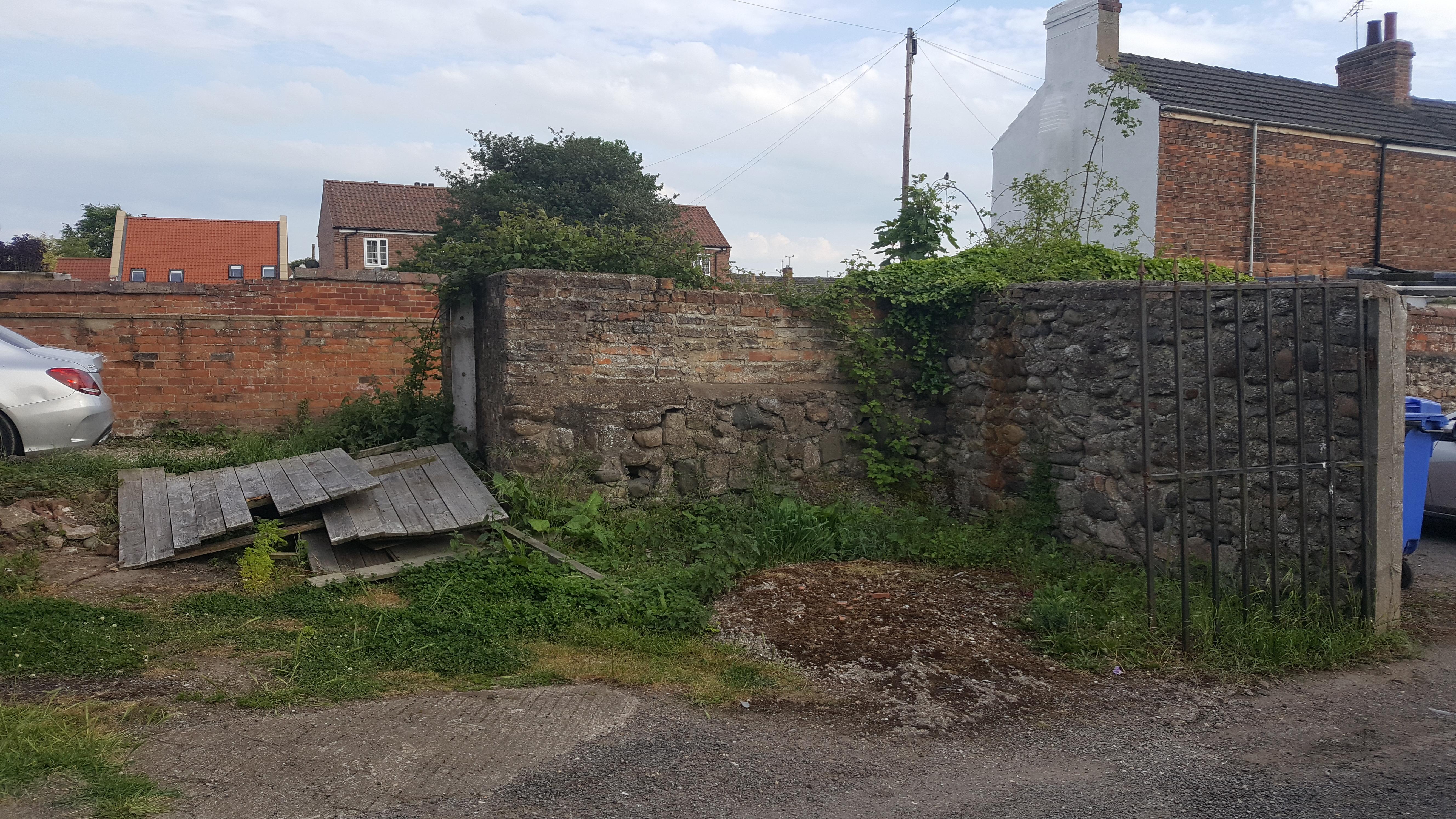

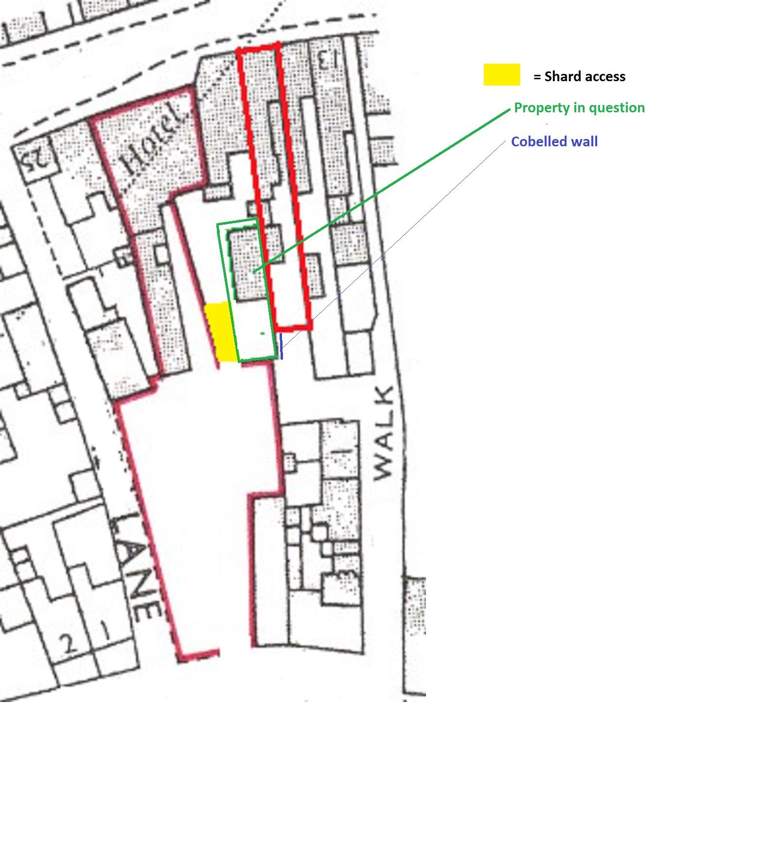

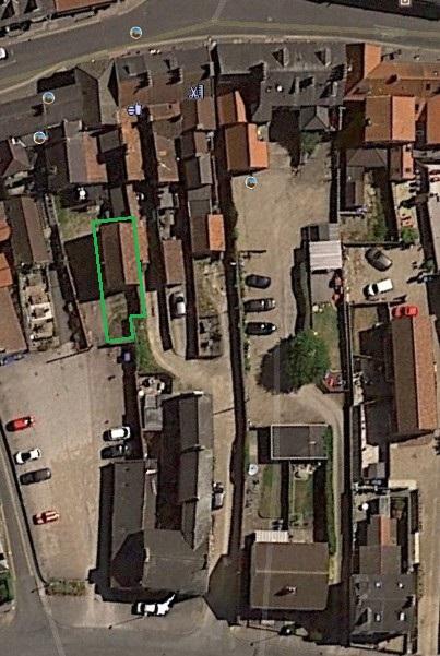

legepe Posted July 5, 2019 Author Share Posted July 5, 2019 (edited) Thanks everyone for all your replies Ive attached a picture taken from the title deeds showing properties either side and their boundaries The property in question is unregistered and part of it (marked with green) is being sold off All the properties here are commercial on ground floor and they all have flats above them - both the residents of these flats and the businesses below them get access through the public house (hotel) car park I would prefer to have access through the other side.. however this is an adopted road and not registered. the best way in through this is where ive marked in blue however there is a cobbled wall there and the property is in a conservation area so there would be little or no chance of it ever being removed I guess the only way to this property would be through the pub car park.. and with it sharing rights of access would they stand a chance of success in objecting to my proposed application to change it from B1 to residential? The B1 license was only issued in DEC 2018 and if Im correct it needs to have had this long before then for it to be considered for "Prior Approval Application" process Thanks again legepe Edited July 5, 2019 by legepe forgot to attach pic Link to comment Share on other sites More sharing options...

ProDave Posted July 5, 2019 Share Posted July 5, 2019 I would first be getting the deeds for all adjoining properties from the Land Registry first to see what they say. Particularly that pub car park. If you are saying there is already a door in the side leading onto that lane, then why not put that back into use? You could always (once you know exactly what the deeds say) see if you can enter a lease with the pub for a parking space and right of access? Link to comment Share on other sites More sharing options...

ProDave Posted July 6, 2019 Share Posted July 6, 2019 4 hours ago, legepe said: The wall at a guess is around 1.5m so going on the info in the link i could knock it down assuming it would be mine to do so What am I missing? Why do you want to knock part of the wall down? there's a dirty great big gap where it looks like an old fence has blown down. Reinstate the fence with a gate through to where that car is parked. Job done. Link to comment Share on other sites More sharing options...
Jeremy Harris Posted July 6, 2019 Share Posted July 6, 2019 1 hour ago, ProDave said: What am I missing? Why do you want to knock part of the wall down? there's a dirty great big gap where it looks like an old fence has blown down. Reinstate the fence with a gate through to where that car is parked. Job done. If I've read the drawing correctly, then it looks like the broken fence leads to another bit of land, outwith the boundary of the property. Link to comment Share on other sites More sharing options...
legepe Posted July 6, 2019 Author Share Posted July 6, 2019 6 hours ago, JSHarris said: If I've read the drawing correctly, then it looks like the broken fence leads to another bit of land, outwith the boundary of the property. Yes thats correct.. the fence boarders the boundary of next doors land.. but the wall does not Link to comment Share on other sites More sharing options...
