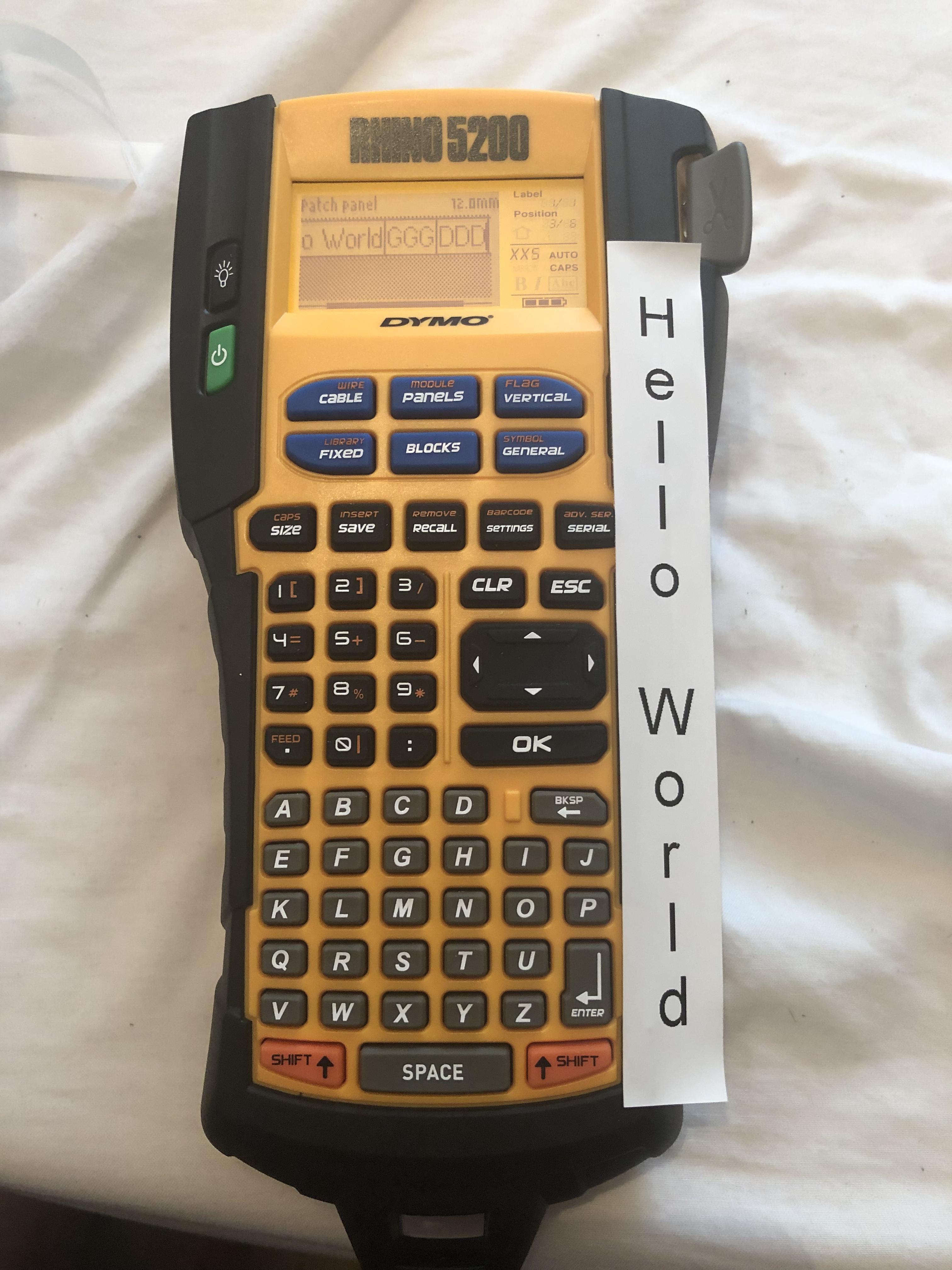

phatboy Posted July 16, 2019 Posted July 16, 2019 I use a Dymo Rhino printer, with Flexible Nylon 19mm tape. When the machine is set to wrap, it prints the text longways multiple times, so it can always be seen. Once the tape is stuck, a few hours later its a fight to remove it. It also has modes for printing entire patch panels / consumer units with proper spacing. Costs a lot, but I borrow the work one 1

phatboy Posted July 21, 2019 Posted July 21, 2019 2 hours ago, pocster said: Ordered ? I'm excited for you... it will change your cable labelling life for ever! I also got a 9mm vinyl roll of tape, which is nice for marking faceplates that don't have an obvious purpose. They also do heat shrink you can put through it ? 1
Pocster Posted July 27, 2019 Author Posted July 27, 2019 Yep - it’s very nice . I can see i’m going to use it rather a lot ! Surprised how large it is!
phatboy Posted July 27, 2019 Posted July 27, 2019 Get into Cable mode (mines older so it's called VWRAP, and you'll be sorted Yup if you drop it it will survive, less so your toes! 1
Pocster Posted July 28, 2019 Author Posted July 28, 2019 12 hours ago, phatboy said: Get into Cable mode (mines older so it's called VWRAP, and you'll be sorted Yup if you drop it it will survive, less so your toes! Will test cable mode later !!
