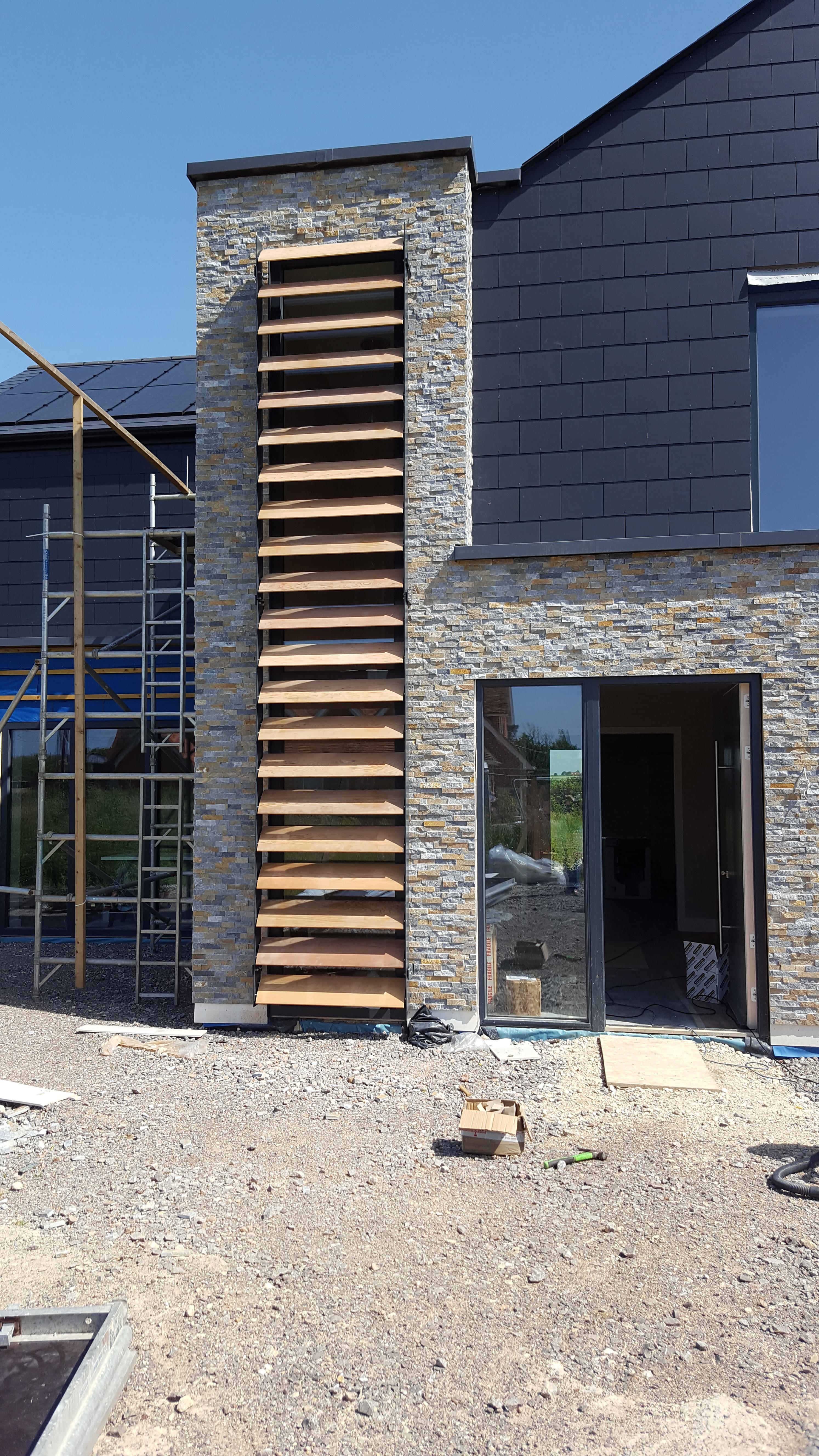

Very nice, and just the perfect day to test the effect too. A bit of ageing and it should fit the aesthetic of the stone and slate around it.
The fins seem quite wide - does it block out a lot of the light?

It blocks out plenty but you can stil see easily to the outside.  That face of the building is almost due south, so the brise is to reduce solar gain from that window as much as anything.  The other windows on that face will either have blinds or, in due course, plants in front of them.

For those interested, I sourced the brise soleil from Contrasol Ltd.  Up until recently, they only did commercial work but they are now setting up a domestic branch.  Very nice people, I would use them again.  Richard Hunt is the man to speak to.

Pending a blog update, here's a picture of my new brise soleil that had the rails and fins fitted today. Details will follow, but it's too pretty not to post a picture.
Looks really smart. Is the stone cladding you have used from Norstone?
