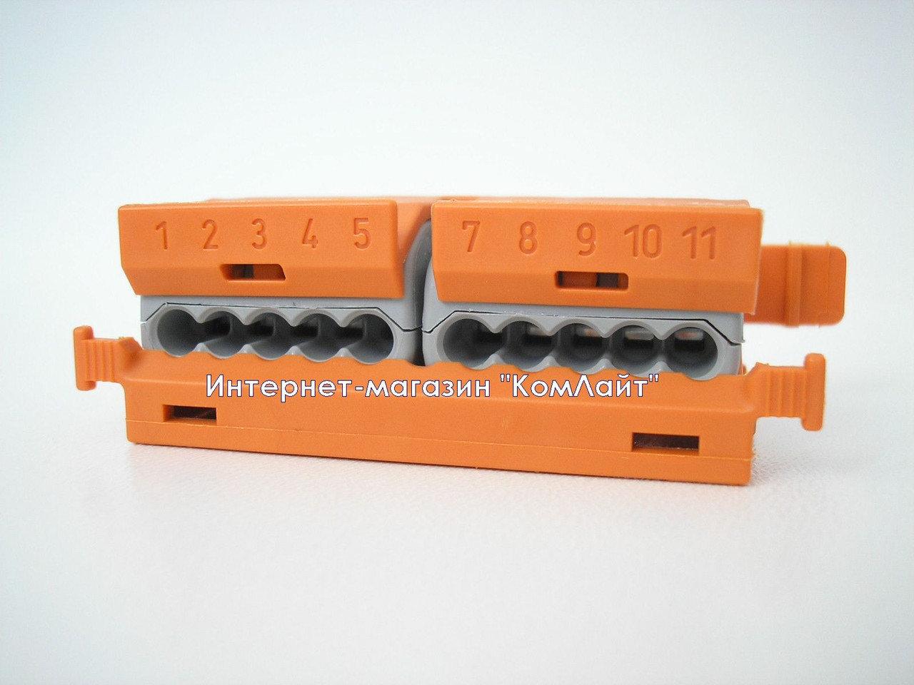

Onoff Posted June 16, 2019 Posted June 16, 2019 Best image I could find. Really annoys me that the undulations in the orange carrier don't line up properly even with two 5's. You get 10 not 11.
