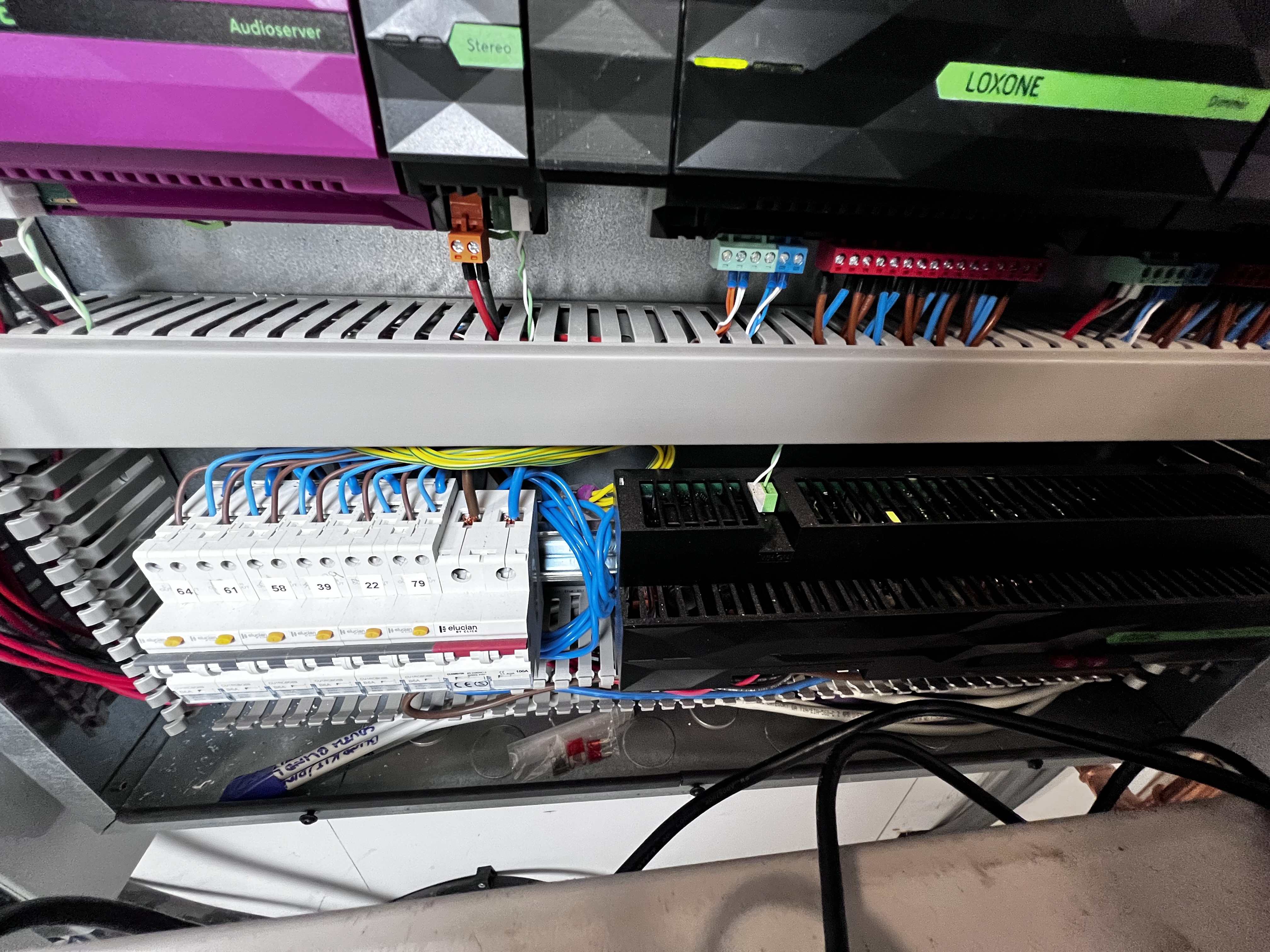

  18. The Loxone PSU is powering all the 24V Loxone devices. The lighting circuits are 230V.

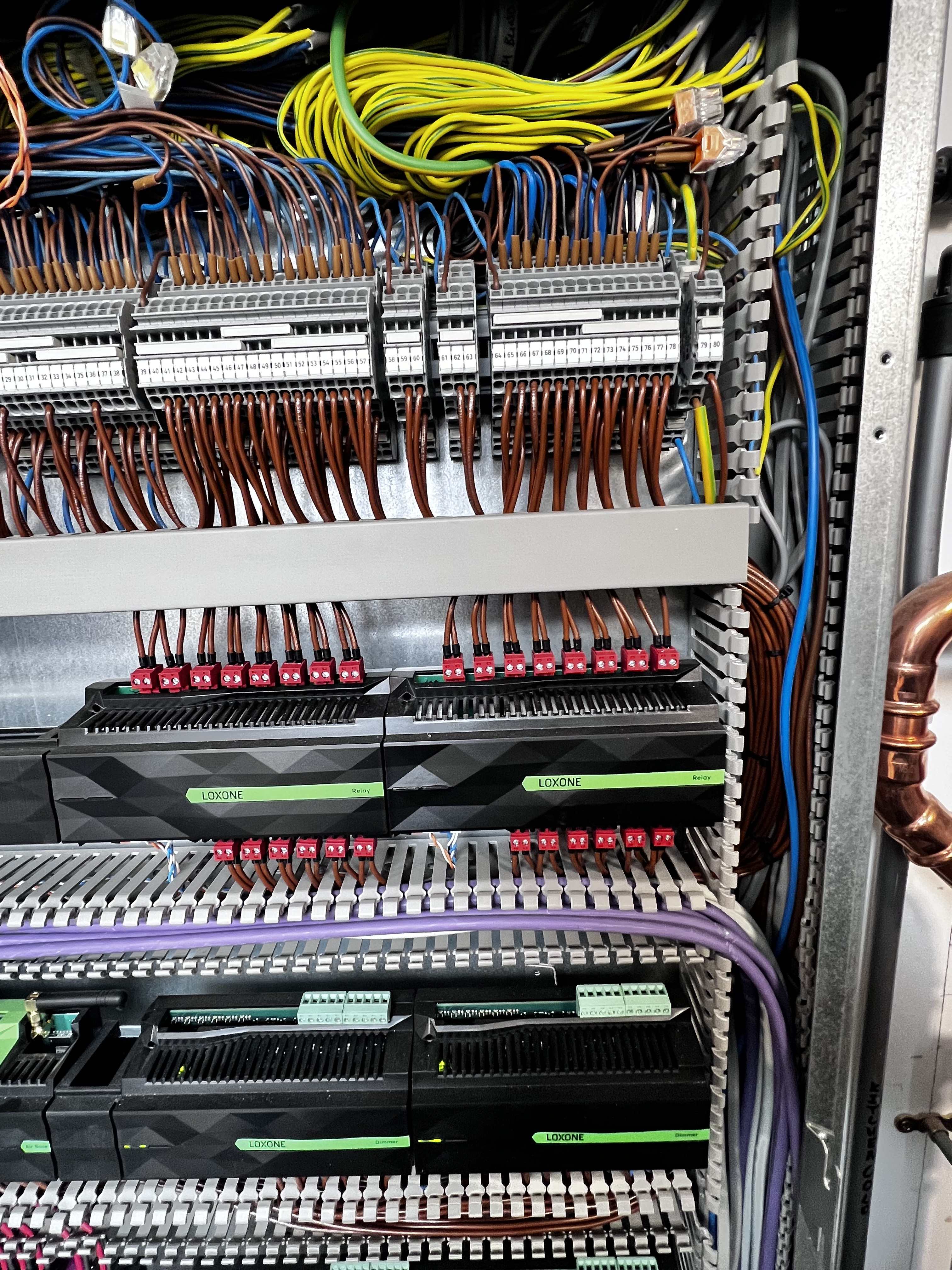

  19. Like this. The lighting circuits come back to the panel and are connected to the either relay extensions or dimmer extensions. Power comes from your CU into the panel protection and whichever PSU you decide to use. I used the rather expensive Loxone PSU there are cheaper more flexible ways to do that.
  20. You really don’t need to have individually addressable downlights. It might be something you’ll think you’ll use a lot but it’s likely you won’t in reality. We have 16 downlights in the open plan kitchen/dining area plus three pendant lights over the island, one over the dining table and an LED in the long alcove/shelf on the back wall of the kitchen. The 16 downlights are wired as 4 separate groups of 4 and the others are also on their own circuits. This allows us to have a few different ‘moods’ (as Loxone calls it) so for example when the house is in night mode after we’ve gone to bed if you get up and go downstairs only the strip by the island lights up and it’s dimmed, if I’m cooking the two strips above the island can be illuminated at full brightness etc. We have track lighting in our TV room and this is where more individually addressable Loxone lighting would have been more useful. To achieve the same result I re-used several of the Philips Hue GU10 bulbs I already had. It works well with Loxone as we have 4 tracks of lights on separate circuits, and Hue bulbs in the track above the seating position and where my desk is. I’ve set the bulbs to the colour I want above the sofa (very dimmed blue cinema styli) and daylight colour temperature above my desk. I then created a mood in Loxone for cinema and office. I never need to use the Philips Hue app and just use Loxone to control it. Same with the outside lights which are also all Hue GU10 bulbs (16 of them again because I already had them) They are the coloured type but only ever have them at warm white. I find you don’t change the lighting moods/scenes as much as you think you will once you’ve settled on the way you want everything. The Loxone stuff is good and easy to configure once you become familiar with Loxone Config. I especially like the Touch Pure glass fronted switches and we have these in the main living areas and the less expensive somewhat cheap looking Touch switches everywhere else. Overall it is relatively expensive though. Also while you can integrate some third party devices and services with Loxone it is much more limited than say Home Assistant where you can easily update devices as new products become available. Loxone also seem to be slow in developing new products. I chose not extend Loxone into the garage and decided to use what I already had managed by SmartThings but really only because I had a large box of sensors, fire alarms, smoke detectors, lighting relays, leak detectors etc I have sort of connected Loxone and this together using Matter. I will eventually move that over to Home Assistant.
