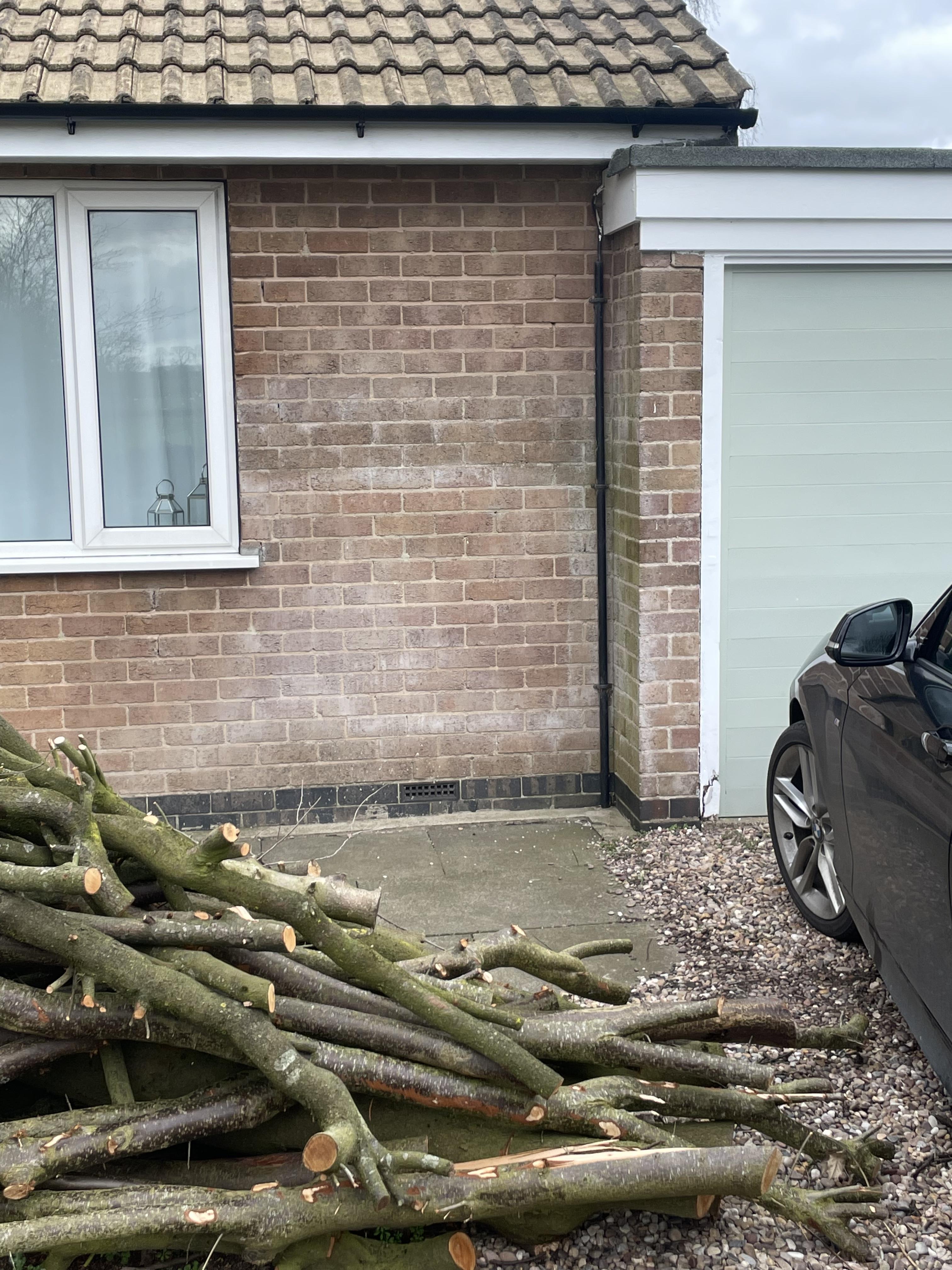

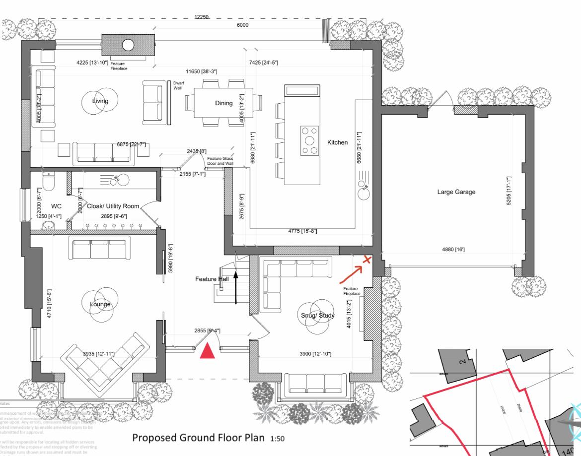

Yes I have spoke to Western Power (DNO) and they are sending me a site plan and I also have to arrange a site visit as it looks like it will need to be moved unfortunately...similar situation to ProDaves neighbour I'm guessing Thanks again
Hi All The garage is staying like it is (building wise) and in there is meter, CU and I am planning on leaving that like that It is currently in plastic conduit/pipe I was hoping to leave it in place as my previous dealings with utility companies are long winded and expensive It would left in the corner of the room in the electrical zones but was also planning and adding further mechanical protection Thanks again
Hi We are planning our extension and at the front of the house the incoming mains come up the wall and into the garage. I have attached a photo and floor plan of where is sits. Would people move this mains and re-route it? Or just leave the cable where it is? And batten the wall off so it’s behind the plasterboard? Any advice/information would be greatly appreciated many thanks
