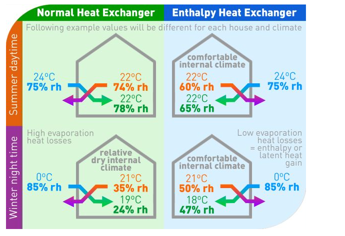

Humidity and MVHR
NCXo82ike replied to lizzie's topic in Mechanical Ventilation with Heat Recovery (MVHR)
Resurrecting an old thread... this is copied from the PAUL guide referenced. The internal RH of the summer daytime normal heat exchange is 74%. The internal RH of the enthalpy setup is 60%. So I'm not sure it's a like for like comparison? Also wondering if the enthalpy exchanger would help with dehumidification if the house is being cooled in summer? -
