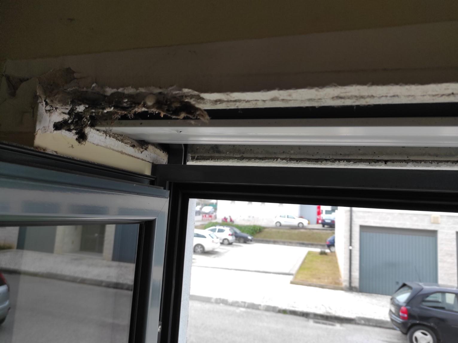

A bit off topic, but different country yet same situation. I got a quotation for replacing my windows 3 years ago. This year we have incentives for these improvements (up to 1500€ for each home) so I asked for an update of the quotation. Guess what: almost 2000€ more expensive. -
"B minus" ? To be honest I think that the evaluation was too nice. My windows are of terrible quality (just ordered new ones), the blinds and its straps have had direct connection to the outside, I didn't have any renewable energy source at the time of the inspection, ... And the only recommendations on the certificate are the walls and ceiling insulation. I'm not thinking in doing it (not for now at least), but I was trying to understand how people do it ?
I live in an apartment and I got it an "energy inspection". The resulting "energy certificate" mentions classification B- and the points to improve are mainly inside walls and ceiling insulation. The ceiling is more or less clear how to do. But what about the walls? If I was to insulate every outside wall, how does one does it especially regarding the windows frames? I mean, apart from the materials, I am having some difficulty to understand how is this insulation done regarding existing window/door frames, central heating pipes, electrical cabling and sockets, etc. The piping and electrical part is more or less obvious, but what about the walls? Is this doable in an inhabited house, or is it something to consider only when building/remodelling? (eg, the house is totally empty)

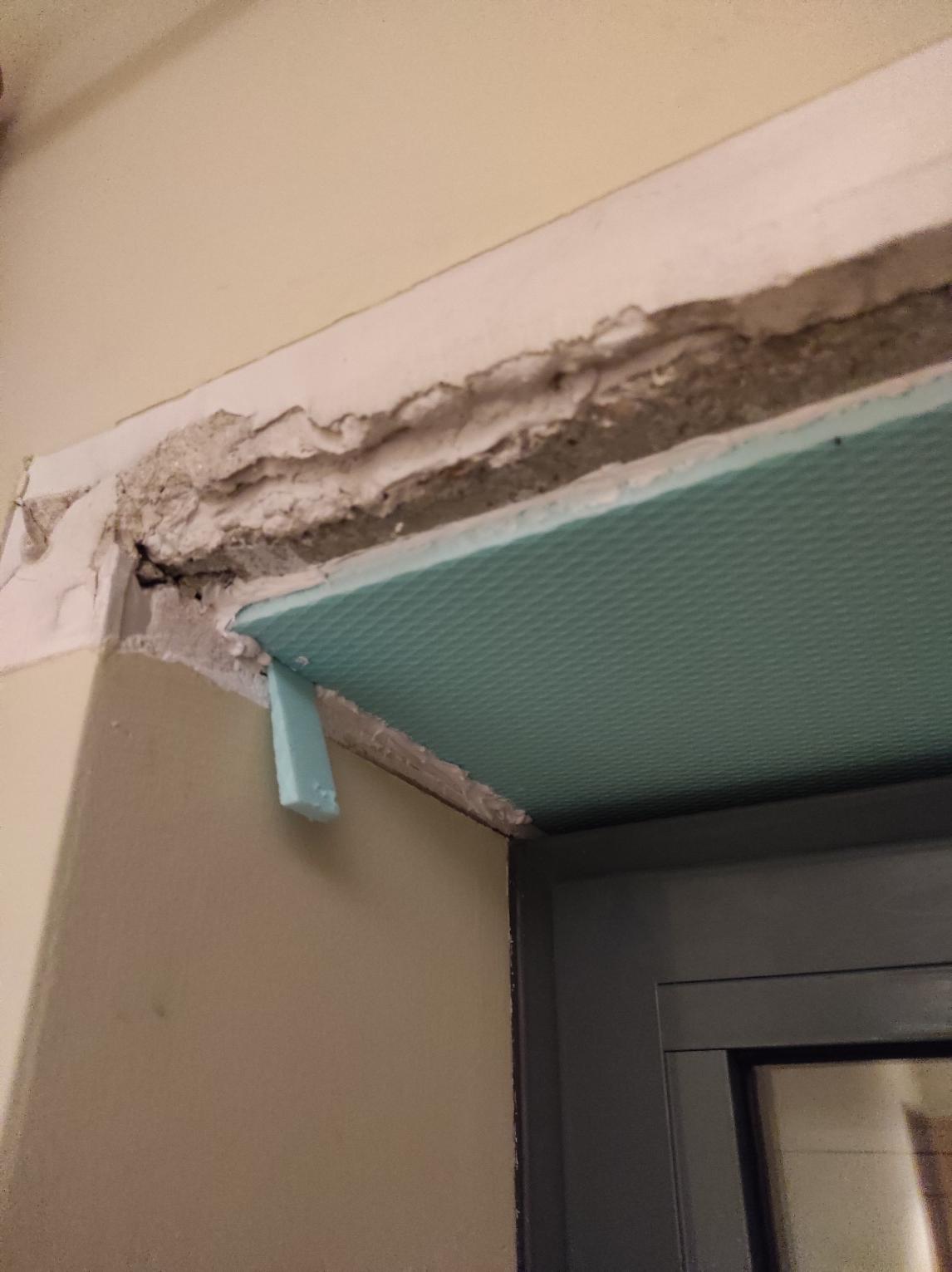

Any opinions / thoughts on STYROFOAM™ for insulation detailing.
Bruno replied to MikeSharp01's topic in Heat Insulation
Insulation of windows with XPS boards is a common recommendation here. Especially the "box" above the window where the blinds roller work. These are direct connection to the outside in both cold and dirt ? I did that myself a few weeks ago, most of my neighbours already did it (or paid someone to do it for them) with very good results. I'm extremely happy with my results, especially after also finding a cover for the blinds "strap". -
