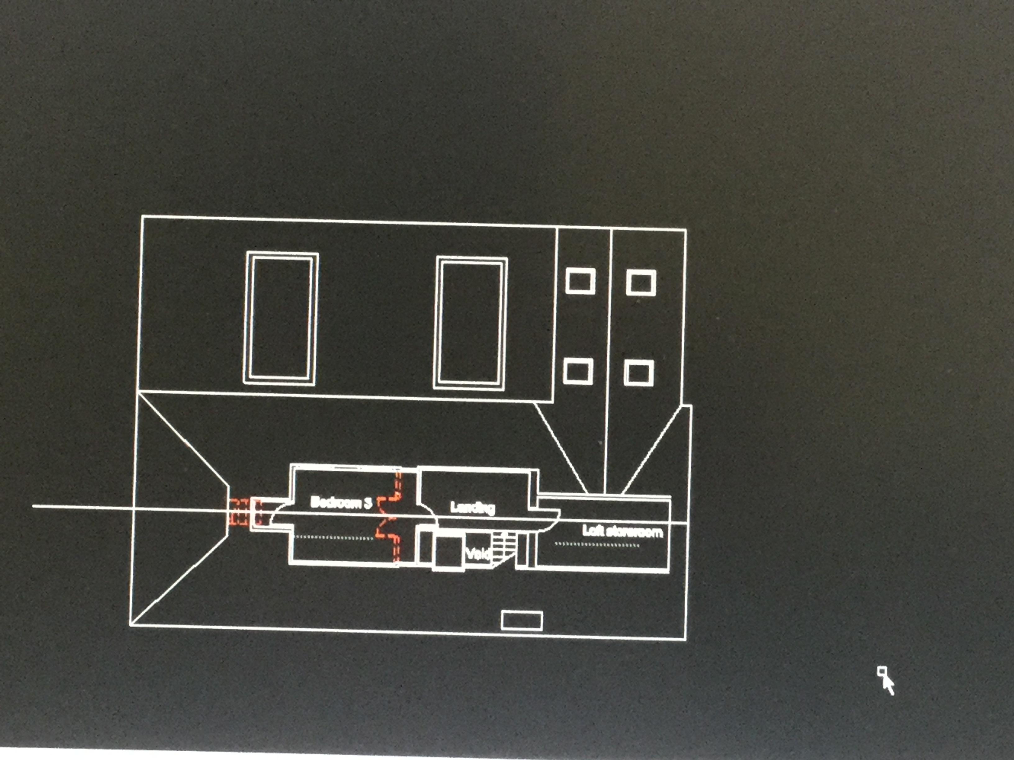

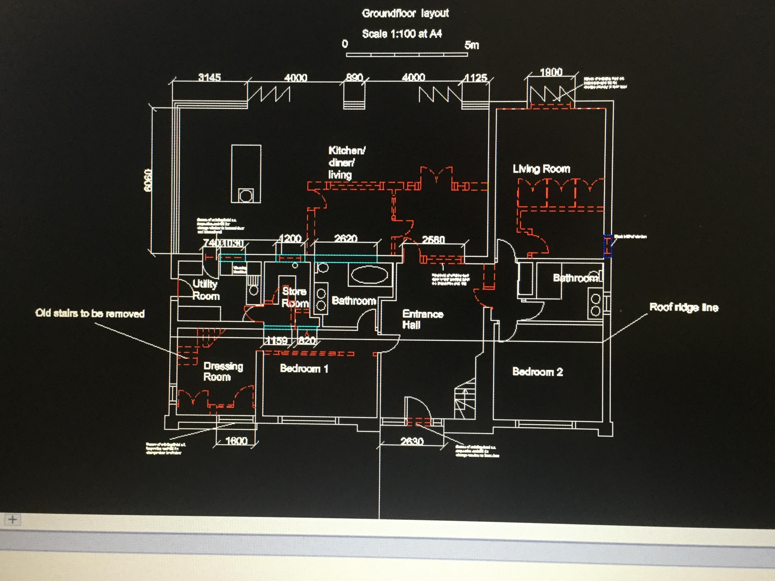

  10. Unfortunately don’t think it’s practical to add a step at the top, diagram attached. The budget would not run to demolition even with the VAT saving. We. are making as few alterations as possible and “reusing” lintels with a new floor area of approx. 60 m2 and a bit of demolition.

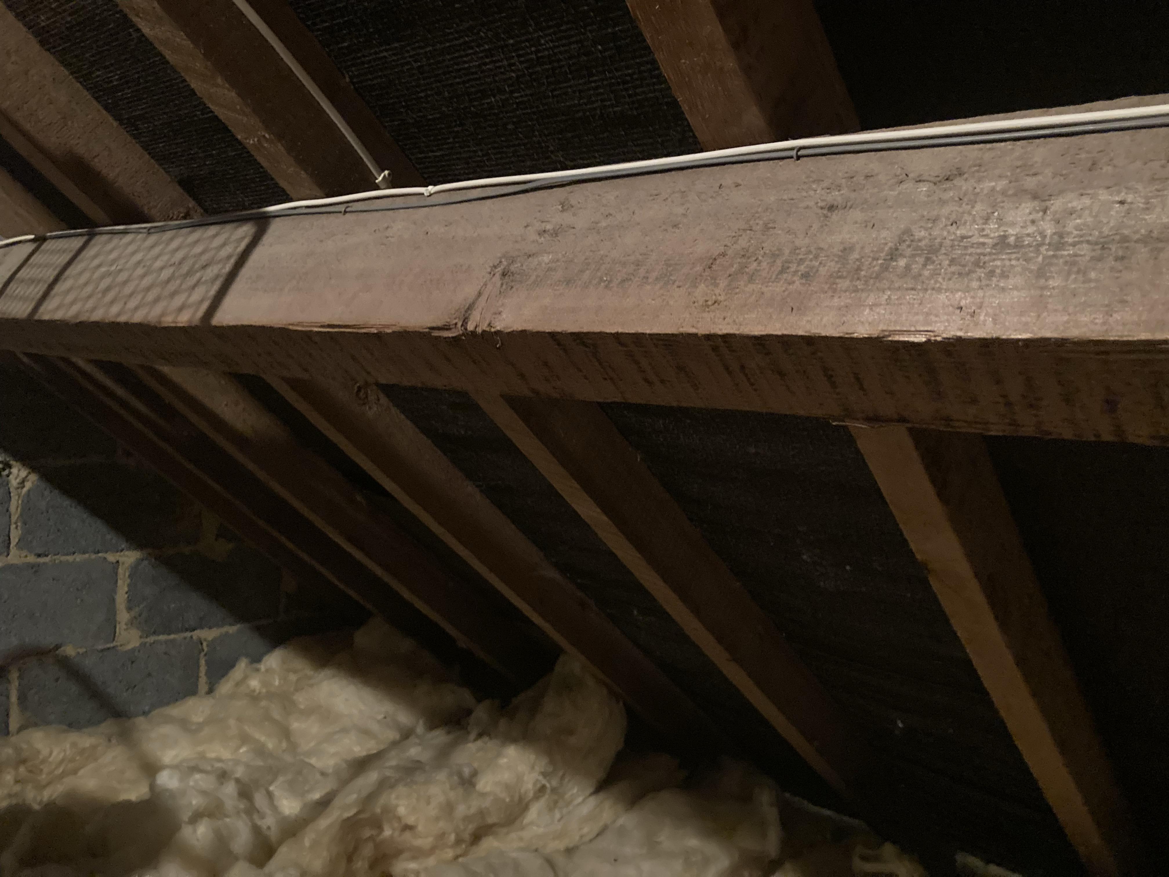

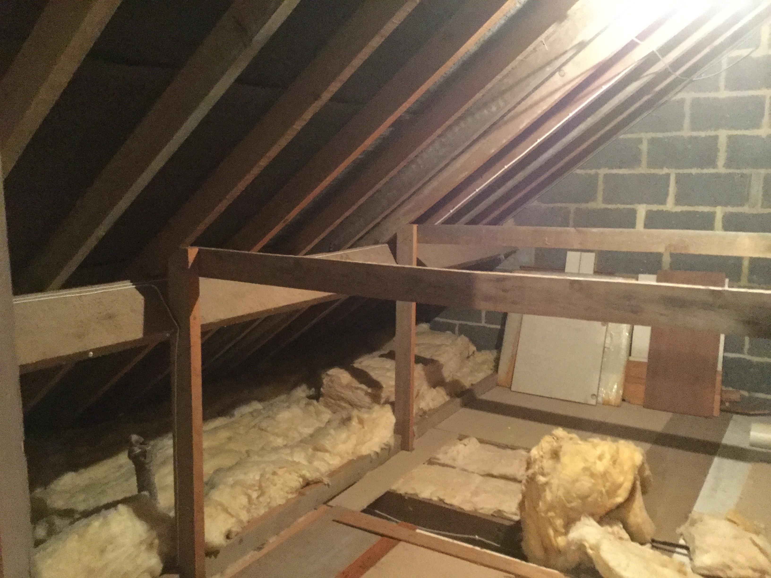

  11. Photos of collar ties There is a door through which the photo was taken which will lead to the stairs. They are proving difficult to plan, however, hence I have another thread asking for ideas on these .
  12. The bathroom idea has been abandoned, on the basis of cost and practicality. We will probably just use the room for storage. Can the 2 collar ties easily be removed or is it best just to duck under them?

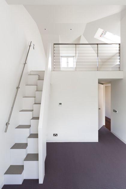

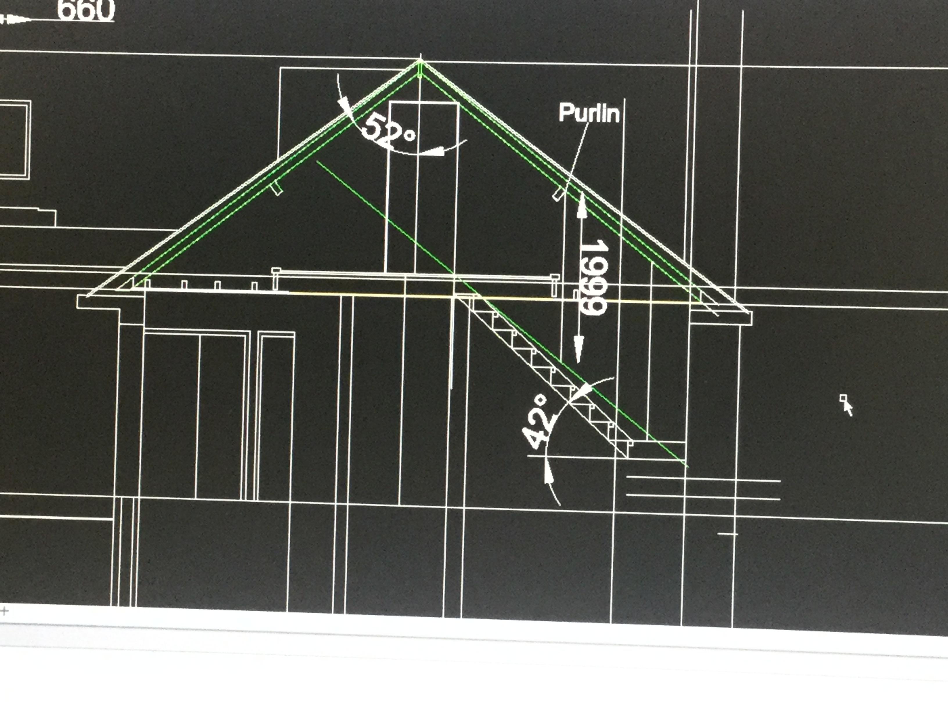

  16. Due to doors etc. there is only one place for the position of stairs to our extended loft conversion. All was going well with the design of the stairs until I realised the purlin, will create a head cracking problem, as it means the 2.0 m headroom cannot be met on the stairs. The green line on the diagram shows the 2.0m line. The stairs are at a max. of 42 degs. Any easy / simple ideas to get around the purlin? Other half thought of replacing part of purlin with steel or cable, not sure how it would work or if practical. Otherwise thinking of something like this .But as we are removing normal stairs from elsewhere, not sure how building inspectors would view it. Any ideas welcome. Cheers Jenny.

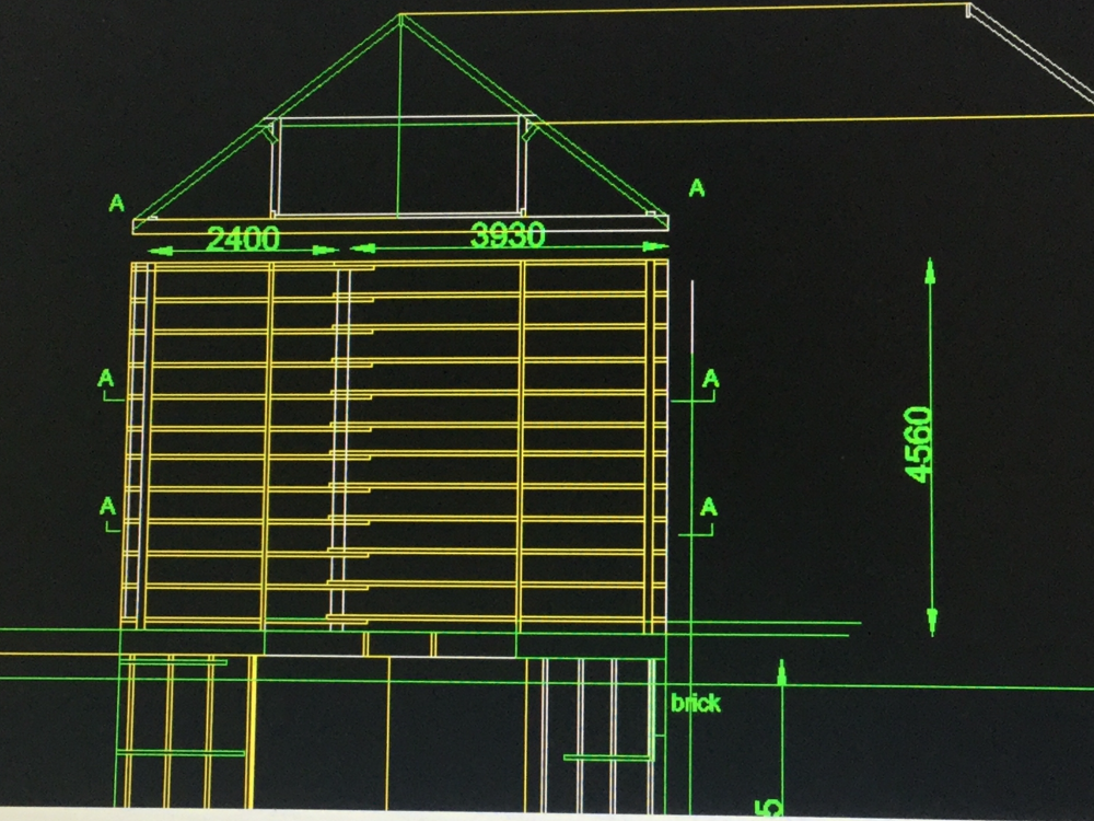

  17. Is not taking ceiling down practical? They are my CAD drawings. Correct 2 collar ties at AA for purlins down each side. Was hoping to have a bathroom in there, but agreed decent headroom a bit sparse!
  18. Span in opposite direction 4560mm as in drawing in above post. Ideally ceiling not coming down. Ceiling height a bit tight, depending depth new joists, but that sounds like a good plan, perhaps along with
  19. Drawing attached, pitched roof with pitch running top to bottom of photo, top shows section at points AA.
  20. None appointed as yet, as funds are very tight, trying to establish easiest, simplest therefore the most cost effective way to do things first Ok, so probably would need deeper joists. I assume that the current ceiling joists can stay in situ. Total span is actually over 6m but there is a structural 100mm block wall 2.4 m from one wall and 3.93m from the other on which 2 independent sets of ceiling joists rest.
