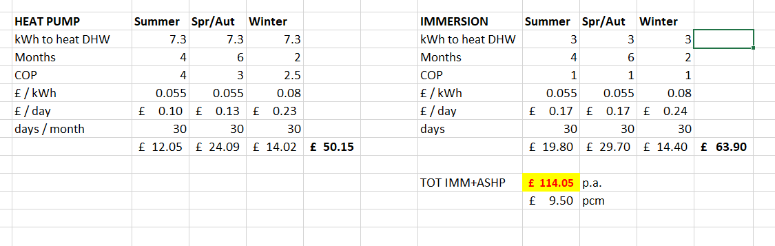

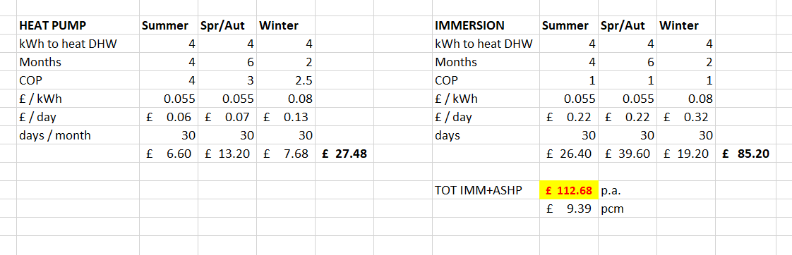

Doing some man math here. Assuming the ASHP runs at a different COP over the year between 2.5 and 4, Octopus Agile is slightly more expensive over night in winter (which it is for Jan so far) and 4kWh per day needed to heat to 48c for ASHP and top up immersion at 4kWh (to whatever temp that top up gets me), I get to about £112 per annum cost for DHW (excl. standing charge): Barking up the right tree? -

Interesting info @canalsiderenovation. I am trying to look at DHW costs for an install that is yet to be planned, and am assuming I can heat the water tank to 48 degrees C with the ASHP and if I need to get up to 60+ degrees would use the immersion for the top up. On the basis of your latest figures are you able to estimate what your latest two-hour afternoon top up strategy is costing you per day? In kWh and £? Much appreciated. -
