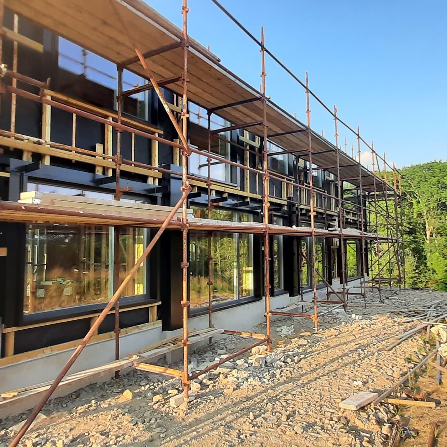

	@joth OK, do I understand correctly that in practice and in your experience - it is not necessarily the volume of cooled airflow to the room that will make a difference to the cooling experience but the rate of return of this cooled air that is important? Or are you saying both flow and return are important and it is important not to overlook return? Not sure if this clarification adds any clarity ?

	Hi Bitpipe, I am hoping this will work for me. I have no Velux or atrium but I have a two large tilt only upstairs on the North aspect- one at the head of the stairs. And a few more smaller casement windows in the bedrooms - so hopefully I can still get a breeze running through. Thanks for suggestions.

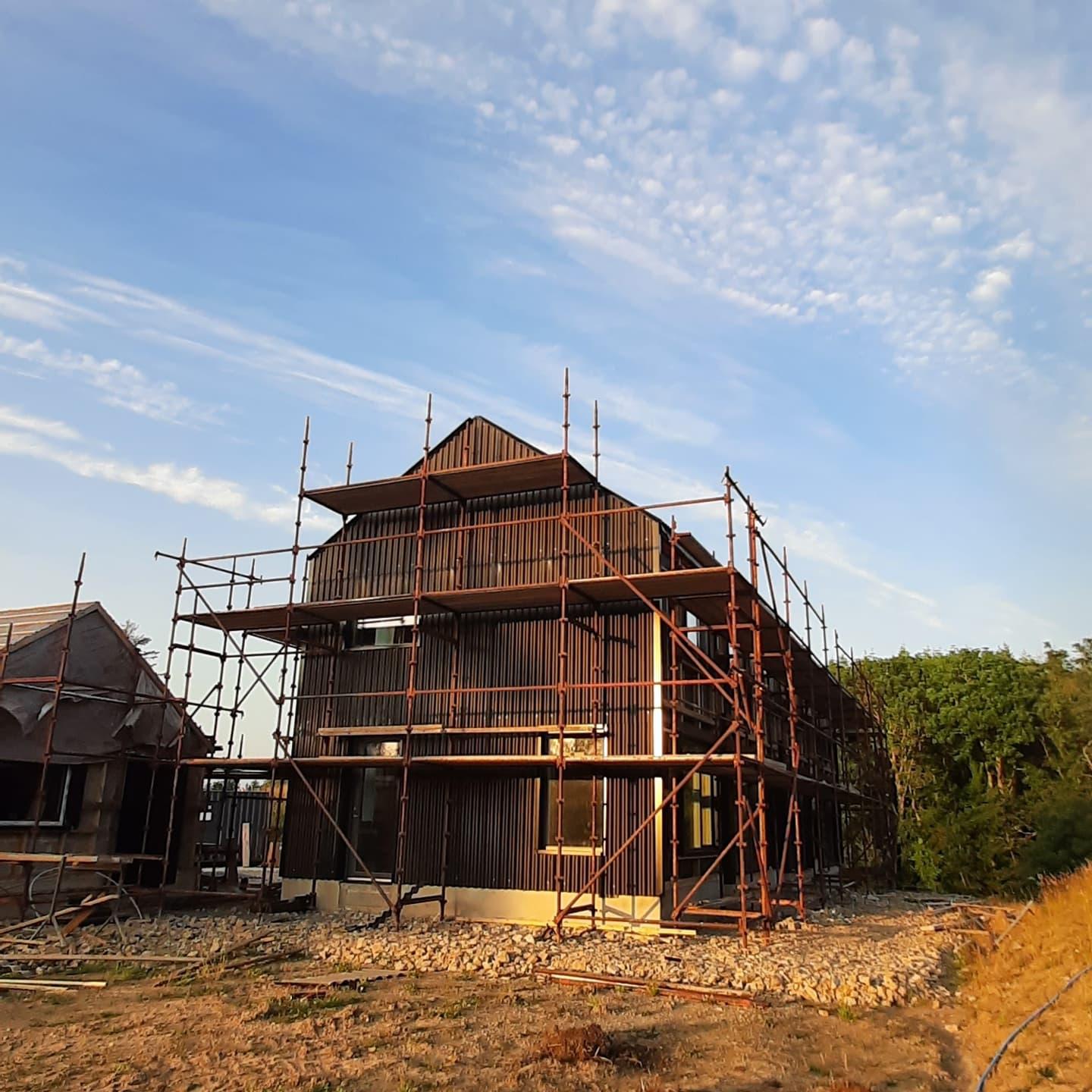

	Hi Nick, I just had a look - There is a company in Ireland doing it. It's going to a bit of a pain to have fit it retrospectively - we had modeled lower gain glass but we started to run into problems with heating load going above pH levels. I guess if I wasn't going to stick to pH recommendations for glazing proportions then I should have been willing to accept the need to heat the house by a tiny bit more. With reduced solar gain in summer my cooling load would have reduced and the total energy use would have been similar. Oh well. I'll get brackets for brise-soleil fitted and I can decided next year if I need the canopy itself. The brackets are black against black cladding so shouldn't be seen even if no canopy fitted. Pic below of downstairs brackets

	L20 is 0.39, R22 was not checked - it is now, but it doesn't change the cooling demand or load or frequency of overheating. I guess if the problem is excess glazing I won't be using MHRV to solve it. I agree. I guess he essentially has given me a stress test model. If I have a 3kW cooling capacity (through ASHP) then all overheating dissapears and the house is PHPP compliant. It ignores the risk of room specific overheating though. But the underfloor loops will only really work downstairs - Adding Brise-soliel upstairs reduces overheating risk from 8% to 3.9% (b4 active cooling) Assuming I can reasonably use the ventilation figures from 1st post. We are out in the countryside, noise won't be any issue so I can maximise night ventilation when necessary.

	Thanks Dan, You gave me the initial figures - I was reluctant to fit brise-soleil upstairs at that stage. The scaffolding shades the downstairs windows pretty well and it was comfortable downstairs over the past week but overheating upstairs. My useless laptop is shut down, I'll look tommorow and report back.

	Hi, I am in the middle of building a timber-frame house (awaiting first fix electrics and plumbing). The recent hot spell has convinced me to get brise-soliel on the south facing upstairs windows. I have them planned for downstairs already. But I played around with PHPP and although my overheating reduced it didn't disappear. My phpp consultant has no figures inputted for L31 window ventilation air change rate and P59 Window night ventilation (in summer vent sheet) Has anyone got 'typical' figures for these? I have used 0.35 and 0.15 respectively and my overheating drops down to 3.9% (with all southern windows shaded). Apart from fitted brise-soliel there isn't much else I can do as all doors windows are fitted and insulation is in place - so I just want to check if the ventilation figures are reasonable. Thanks
