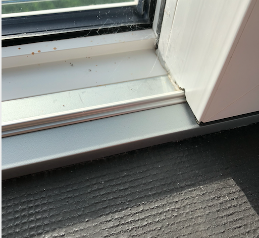

  6. yeah this sounds familiar... we've issues with ours due to above. Our branch pointed fingers at builder error and they pointed fingers at window company not doing correct job. Builders assume a slider can be packed up, were as window co want perfect level and no work. Have you scope for window to come out and go up? Might be easier than trying to lower floor? I take it there's UFH in the screed? Sounds like your John Knight will be able to advise if it's too low.

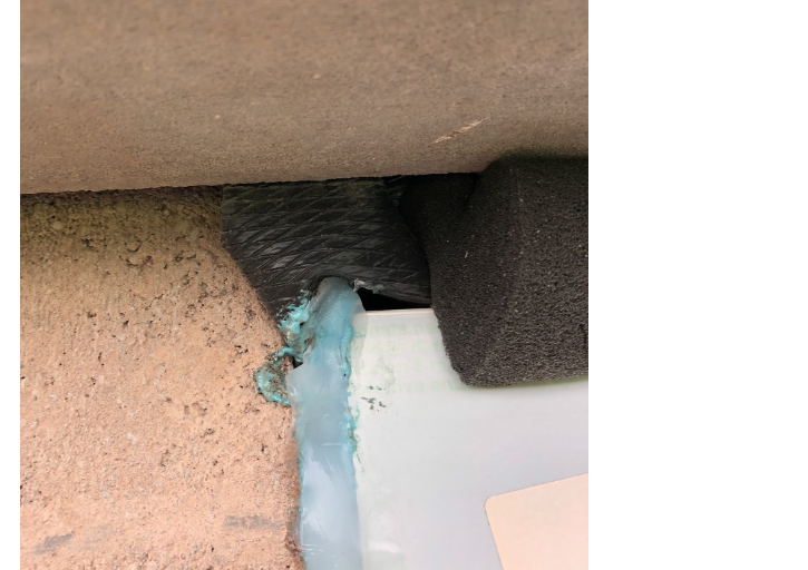

  7. Aye its definitely been bodged from day 1 when house was built (we're putting an RSJ in living room as joists are failing). It was just fact the compriband has never dried out, that made me think. I totally agree getting the wooded head out, pVC trims off and having a good look would be the best start. I can't see how its getting into the cavity.. the pointing is brand new and perfect.

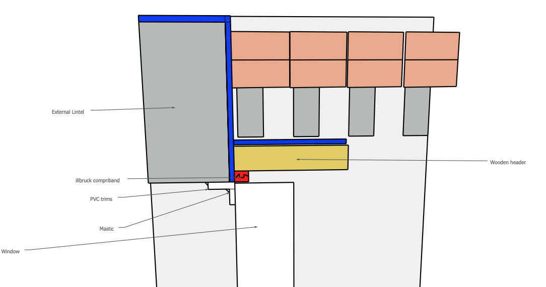

  9. Yeah.. cavity tray is prob last resort, but what should really be there. I've been recommend Stormdry cream.. but had hoped the re-pointed would have fixed this. The property does have a cavity, but all this issues are before cavity, as it's old stone walls (+700mm), with a timber kit on the inside. The window's installed in/under the stone, 150mm before the cavity starts.

  11. Hmmm... I would have definitely expected there to be some mm on the threshold, above finished floor level. I know the desire is to have it completely flat/seamless finish between floor and window. But to help with water ingress, we were told to have it as high as possible, but max is to have floor finish at threshold aris. Yours looks to be above this. Who specified the finished floor level? What threshold depth did you go with? I take it the window moves freely? Here's ours, if that's of help. (the finished floor is a currently bathroom board, but its exactly floor level finish, give or take 5mm). On a side note, how well protected are your external drainage holes? There's a known issue with drainage on these doors. Under storm conditions, the internal channel can fill up with water. I was told that Internorm have been able to create the issue in their Lab! 2 years on, no fix!

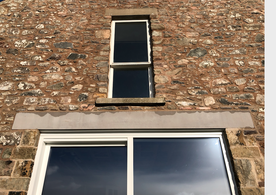

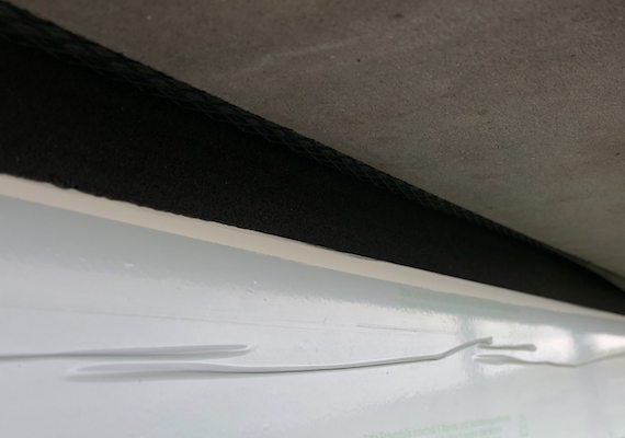

  12. the lower lintel is a replacement. Top lintel has +20 years on the lower one, even though they "colour matched". However you can see how wet the gable end is, and where the moisture is still lurking. Above the new lintel its been repointed and totally packed with mortar, just a few months ago, in NHL 5 lime. It was originally poorly done in portland cement and not really smeared into the back. Hence me being utterly at wits end.. sorely tempted to brick up the whole window! ?

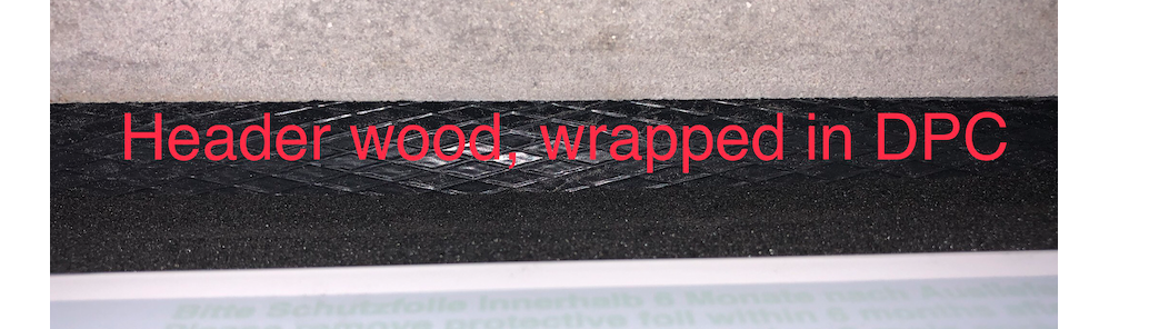

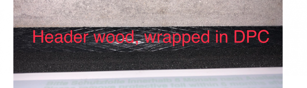

  14. there isn't one no.. but builder said its not normal practise for a have a drip on a lintel. The sill obviously does...
  15. after last nights storm there's a puddle on the window head that's been dripping on the floor. Window is south/south-south-east facing. Photo below.
  16. finished PVC trim & stone quoins
  17. Had a window installed last year, the head is permanently wet. Any advice or thoughts would great be appreciated as we're nearly 2 years into this debarcle. There was a cock up in measurements/builder installation error, which meant a new lintel ranged from 0 to +10mm above the new window head. (Window company blamed builder, builder blamed window company). It reality, the window company are not picking up any of the slack or blame and could have done a hell of lot more to help the builder, but the builder did cockup and put a new lintel in 5/10mm higher than original one, and then wrapped back in DPC. If the window company hadn't taken 30mm off vertical measurements "to aid installation", we'd not have these issues. 30mm seems ridiculously excessive. The window company sealed the gap above the window (badly) with illbruck compriband, then installed PVC trim over the top to bridge gaps (pictures are before gaps filled and PVC trim went on). The illbruck compriband is always wet and is now utterly sodden after the storms. It almost dried out over the summer, but is now soaked again. The window head is currently open to the internal air temp, so I was initially (wishfully) thinking it might just be a condensation build up, but there's too much water now to just be condensation. The whole wall where this window is located has all been repointed, so there should be any water ingress from there. My thoughts are, there should be a drain installed somewhere... Should the illbruck compriband be ripped out, so its not serving any purpose? (PVC trim acts as weather protection). Help!!! this gap was filled, prior to PVC trim going on. Stone quoins now cover the jambs.
