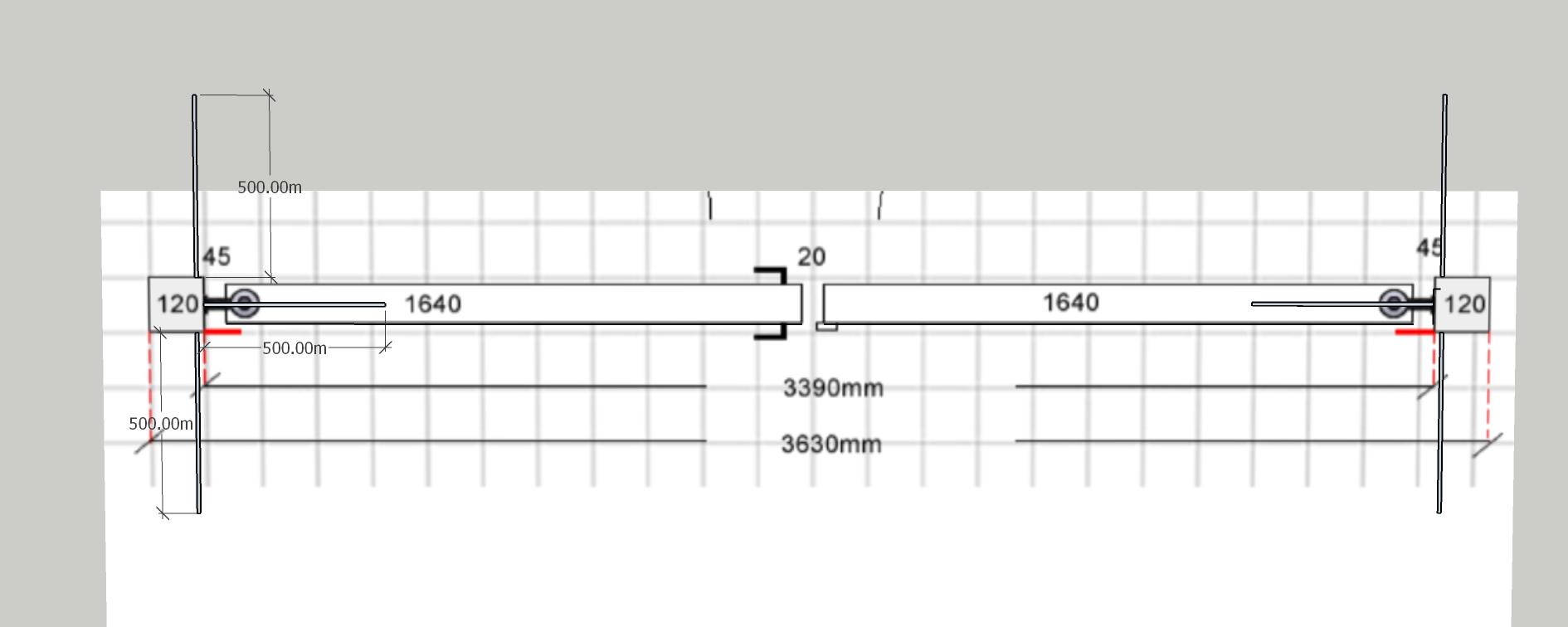

Tks to all. Done the deed in half hour, with 40N readymix after all. Labourer could go on to other tasks, which helps claw back some of the readymix cost. Thin rebar buried without fixing to posts, just to reduce the risk of concrete buttresses cracking. Yes, ducting embedded in concrete to facilitate automation later. Ditched the dpm idea as being further overkill. Will report following gale.
Each steel post will have to withstand the weight of a >50kg heavy driveway gate leaf, 1640mm wide and tongue&groove construction (sail effect in gales). That's why considered strong concrete approx 450 x 500mm & depth 700mm. With additional resistance to deflection of post using buried 500mm rebar rods in tripod configuration, to act as buttresses. (plan view attached) Would something other than 40N concrete do the job better? (approx 0.7 cum concrete for 2 driveway gateposts). And is dpm lining of the hole advisable to reduce rapid drying and shrinkage of the concrete?
Steel gate posts 120mm square. Need to be buried 700mm in ground. Concreted in. What concrete to specify (ready mix)? Would 40N be inappropriate?

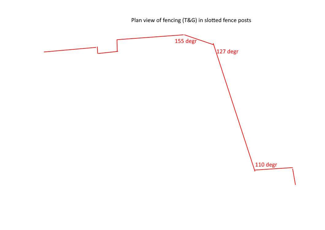

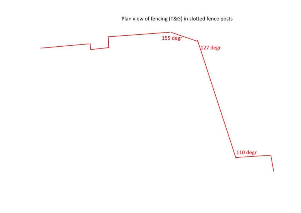

Fence posts for odd angled corners
WWilts replied to WWilts's topic in General Self Build & DIY Discussion
Reporting back. Used galvanised fence clips. Easy to angle any which way. Time will tell how many need replacing how quickly. -
90 degree corners no problem. Slotted fence posts with T&G panels. How to deal with odd angles? How to get/improvise fence posts?

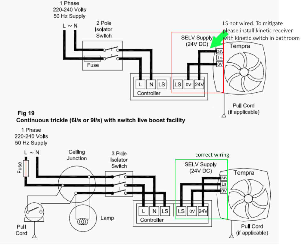

Faulty installation or faulty unit?
WWilts replied to WWilts's topic in Electrics - Kitchen & Bathroom

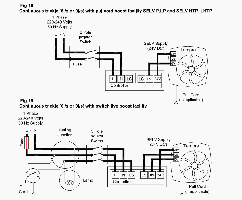

Initially the wiring seemed to be as shown in Fig 18 (no light, pull cord on fan, but no isolator switch) Then instead of the separate light switch an isolator switch was installed, plus a PIR that when triggered also switched the fan on. Depending on the fan pull cord toggle position, the fan starts at either slow extract (for few mins, then goes to max extract rate) or max extract rate from the very start. Thereafter stays on, until the isolator switch is turned off. The wiring from the loft SELV supply to bathroom fan was installed on the ceiling beams that are now under 400mm high loft insulation. Electrician asked to be let in after hours and (peculiarly) to be left alone in the new build house yesterday. Came well after 6 pm. Thereafter builder announced that the unit was faulty because in the electrician's words there is no switched live output from the loft. Builder also stated, peculiarly, that electrician came over to look at the fan and along with the fan manufactures support team went through all the possible reasons why it wasn't working properly and together they concluded that the fan was faulty and needs replacing. However, when I rang the manufacturer's Tech Support Team they said they close at 4:30 pm and nobody from their team spoke to any tradespeople yesterday. Seems that there may NOT be a switched live output from the loft, but only because the electrician initially wired according to Fig 18, that too apparently hardwired without an isolator switch. Some months later tried to wire according to Fig 19, but the wiring from loft to fan was buried under 400mm loft insulation. What to do, if that is the case? Builder seems to be trying to shift the burden of remedial work to me, perhaps assuming I don't know anyone who understands these things. -
19 SELV supply unit is in the loft -

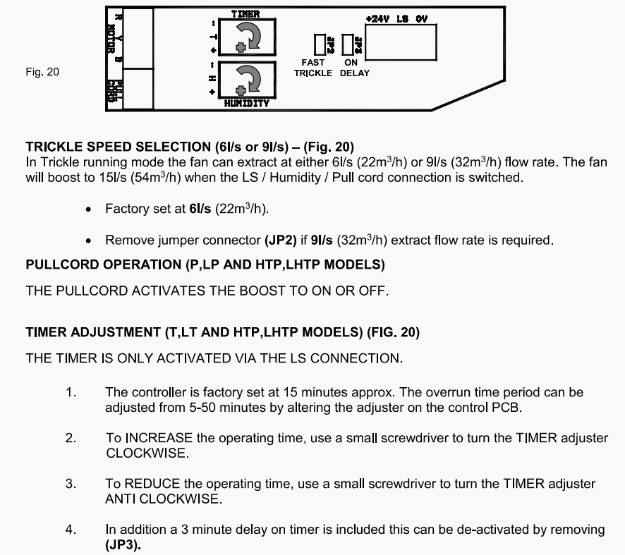

Have asked the sparky to clarify which diagram. PS When we go into the bathroom, a PIR switches the ceiling light on and sets the fan off at relatively low speed (with pull cord toggle in position 1). After a few mins the fan goes automatically to high speed even if the ceiling light goes off. Then stays on high speed. Only by switching off the isolator switch can it be stopped. -
Vent Axia extractor bathroom fan stays on. Transformer box for 12V installed in loft. PIR switch connected to the fan. Intended to be on background trickle extraction, plus boost with pull cord (or boost when humidity is high) Builder says his electrician considers the unit faulty because "there is no switched live output from the loft". It was installed months ago, and this was mentioned only now after the electrician tried to set things right but failed. Builder wants me to supply another unit and to charge me for the installation of the replacement unit. Vent Axia faq say the humidistat needs to be set to maximum (90% humidity) so that it is not triggered by relatively low levels of humidity. Help! All Latin & Greek to me. I would be comfortable sending a unit back if it was found to be faulty at the start. But months later .... Qu: Is it faulty installation or faulty unit? Is there a straightforward fix if it is an error in installation?
