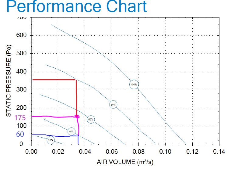

  2. Please help! I am trying to figure out the impact of using F7 filters rather that the "standard" G3/4 and I wonder if anybody had any experience with them and share their experience and comment to my thinking and calculations below. Assumption-1: The manufacturers quote their flow rates using the "standard" G3 filters. Assumption-2: I have found a Filter manufacturer spec sheet and as best I can interpolate using the sizes they specced, a G3/4 filter will cause roughly 35-50Pa drop. Assume being fluff, the pressure drop does not go up dramatically over time. Assumption-3: From the same doc, an F7 filter will be in the 125Pa+ drop to begin with but will go up to as high as 450 Pa drop (@ rated flow) as it gets clogged up. Now, there appears to be almost 100Pa of difference (125 - 35) between a G3 and F7 filter to begin with and over time, it may go as high as 400 Pa. I have got the Ventaxia Advance SX performance chart below. I have plotted the flow/Pa for my installation, 130m3/h (0.036m3/s) and I assuming I could keep the system ducting pressure drops to 60 Pa total, I would be running the system at 40% fan rate with stock G3 filters. But if I decided to go to F7 filters (and the Ventaxia appears to have a piddly 365x135mm filter size), the initial drop will be ~150+ Pa which means the system will have to run nearly at 60% capacity (assume this to be the fan rate). And as the filter ages, even if I didn't wait to reach the +400Pa point and replaced at 350Pa, I am looking at 80% fan rate, and that is at nominal flow. Has anybody done or seen this sort of analysis before? Any comments on the noise etc. from those who tried using filters other than the stock G3/4? If I am correct in these calculations, I need to look for a different unit for sure.
