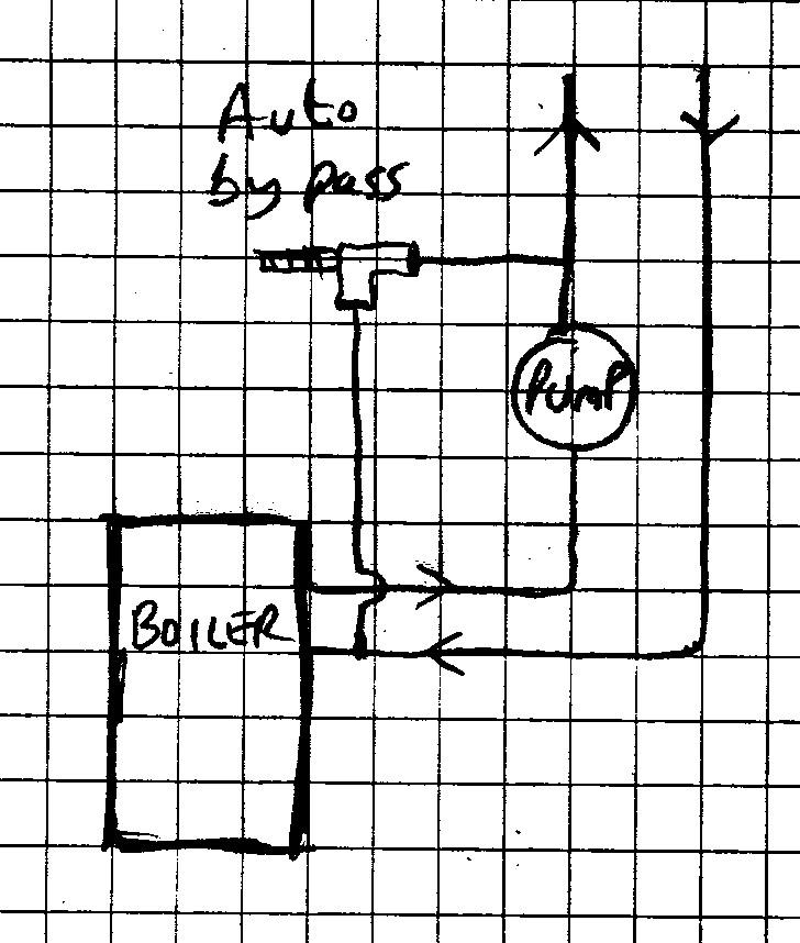

Pump speed now reduced from 3 to 1 and has had no impact on heating up time of all rads, so will leave it on that setting. By-pass valve set to 0.3Bar on a try-it-and-see basis and am currently monitoring the temperature of the by-pass pipework using my datalogger to check its efficacy. -

Thank you Marvin for your thoughts and confirming that my understanding is correct. I have a an oil boiler, brand new, which has replaced my wood pellet boiler. This does not modulate (unlike the pellet boiler) and yes, the pump has 3 speeds, and is currently set on speed 3 as we have a large C/H system (15 radiators all bar one with TRV's) with a manifold system terminating in longish runs of 10mm microbore pipework. I intend to play around with the pump setting as I'm not convinced that it is necessary to have it running at top speed, not least because it is not one of those newer low-energy pumps and consumes about 60W on speed 3. I guess I should look at pump speed first before tinkering with the by-pass setting? -

Thanks to the three of you for your replies. Perhaps I should rephrase my question: what pressure should I set the by-pass valve at? I'm thinking I could set the by-pass valve to the maximum and then close all the TRV's. Then gradually reduce the by-pass setting until the by-pass pipework gets hot? -

I am trying to get my head around how the automatic by-pass valve on my oil fired boiler works. I understand the principle: on a C/H system where all the rads have TRV valves then the situation could arise whereby all the TRV's close and the pump would be struggling against a closed system. This is almost the case with our system but there is one rad (a bathroom towel rail) which has no TRV and therefore is always open. Nevertheless the boiler has an automatic by-pass valve fitted - schematic attached. My question is this: the adjuster on the automatic by-pass valve is calibrated from 0.1 to 0.5 bar in 0.1 bar increments - what does this mean in reality? For example: if the valve is set to 0.3 bar does this mean that the valve remains closed until the pressure in the C/H system exceeds 0.3 bar and it then opens to allow the by-pass loop to come into operation? Thanks.
