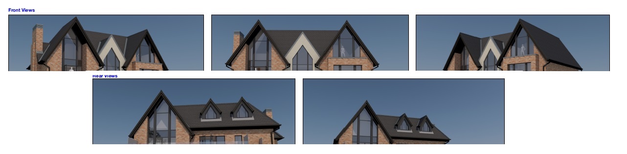

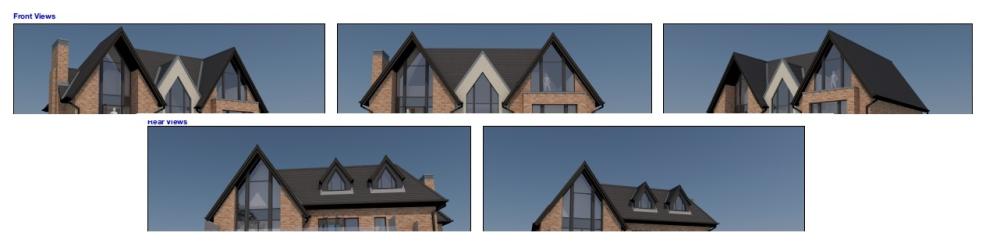

Hey all, Wondering what slate size I should go for on this build and how many slate and half should I be estimating. I had in mind 200 slate and half 235sqm roof area for slating 500 x 250 4845 600 x 300 3135 Thanks C
