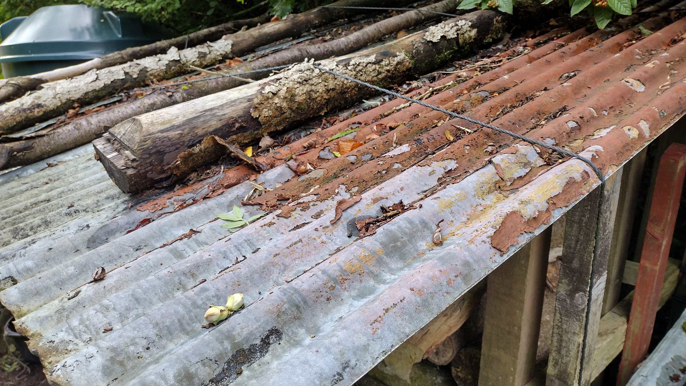

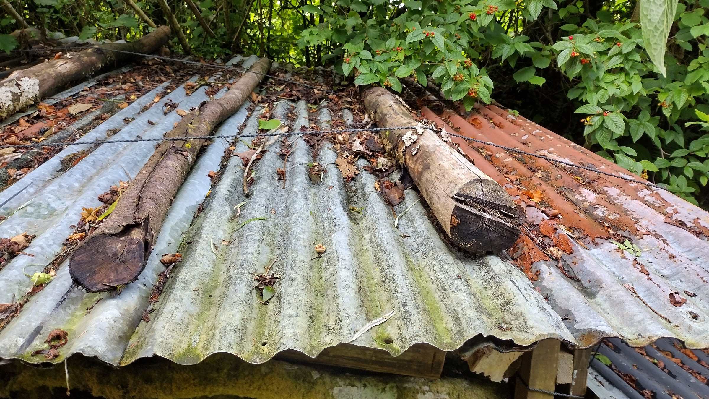

Thank you all for the replies, much appreciated. I've just had a look at prices and it seems it would be 1,000%+ on bituminous paint. Ouch! How much better would it be do you imagine? And if the cold galvanising would last another few decades, how long by comparison would you expect bituminous paint to last? Interesting that they use just that, as it is regarded a primer so seems odd to not put anything over the top. I'll look into it further, thanks. Comparable price to bituminous. Thanks also for the tip. I'm getting spoilt for choice now Seems about x2 / x3 more expensive than bituminous. Do you think it is worth the extra outlay? Longer protection? Cheers
Hi I was donated some "corrugated iron" sheets and have been using them for a couple of years in a makeshift shanty town style array to cover firewood. I want to build proper wood shelters before winter and plan to make use of these sheets. But I'd like to clean them up and protect them as part of the project. It doesn't have to be amazing, the main objective is just to make sure they last as long as possible. I'm pretty sure the sheets are galvanised. There's some old black paint in them which has blistered, flaked and peeled in places. There's also remnants of an old orangey/rusty coloured paint on them which you might mistake for rust at first glance. That being said, there is some rust in places but they're not too bad overall. Bitumen paint seems a common choice. What do you guys think to that? Or are there better alternatives? Also, would I need to use a primer or anything else prior to painting? I've read about rust inhibitors, etch primer, and various other things, some of which people say you should use on galvanised, while others say not to. So feeling a bit confused and hoping you guys can put me on the right path. Many thanks PS - I will be fixing them down properly. Please ignore all the wood and rocks!

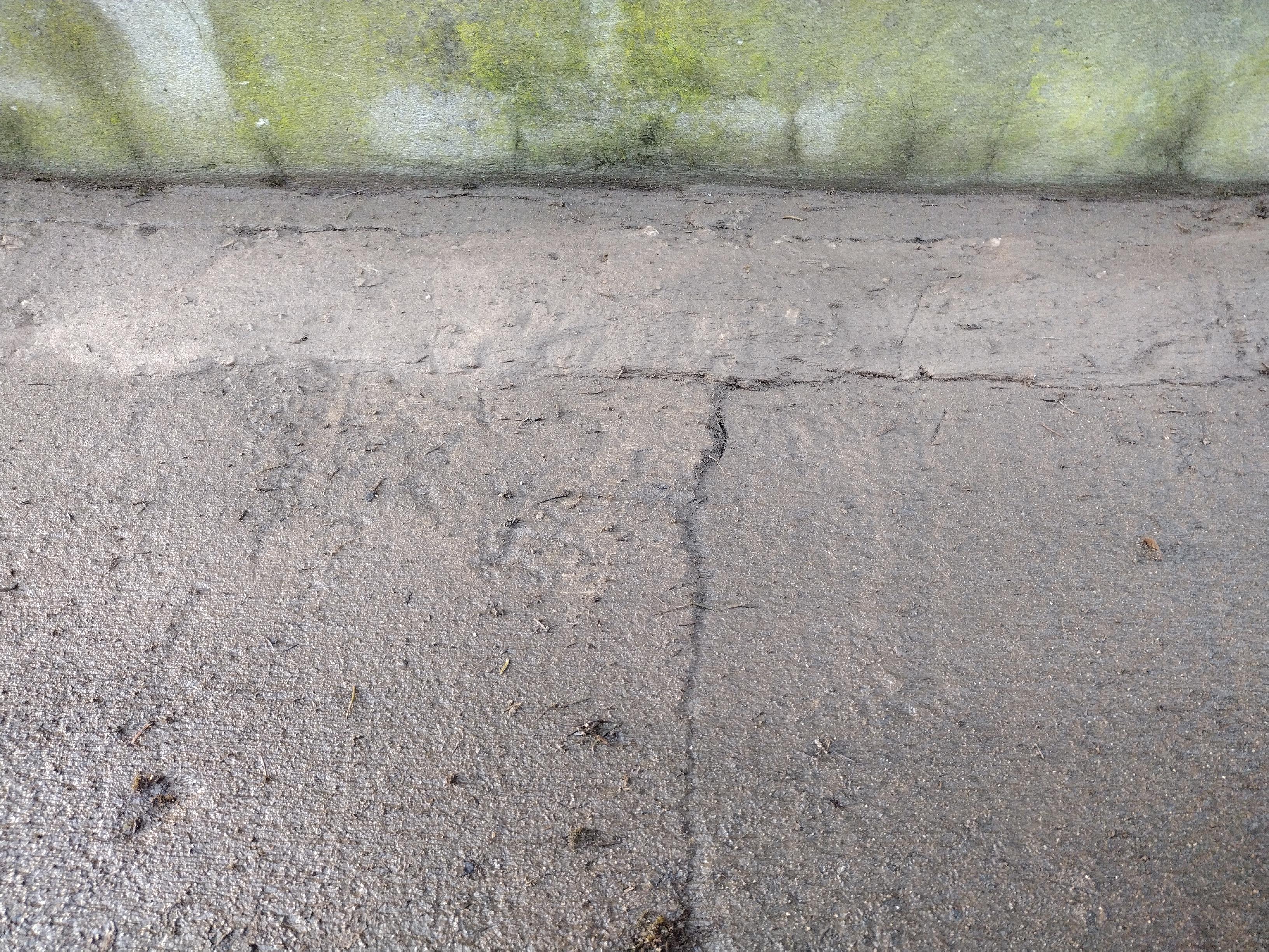

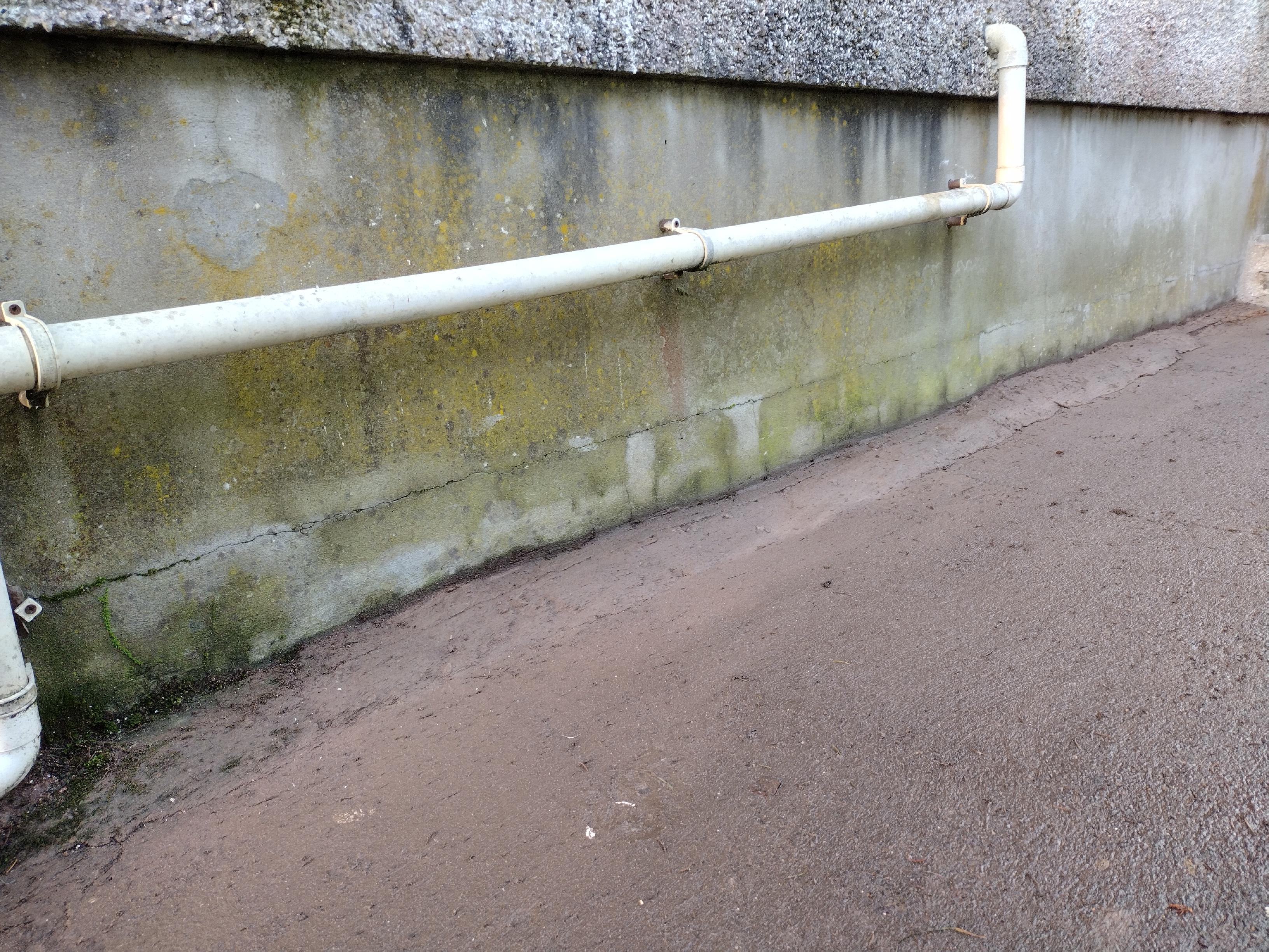

Good weather and a BH weekend, so hoping to get something done with this this weekend... If nothing else, I was thinking to remove the existing knackered fillet, repair obvious cracks and defects in the ground-wall join with a concrete repair mastic, followed by a new fillet. I figured and hoped that if this worked in the past hopefully it will again. I've no idea what mix of cement to use, whether to use SBR, etc. - so any thoughts on that would be great. And with the additional info and measurements I added last week, any other thoughts most welcomed too. Many thanks -

Hi Got a few more details to add... I've measured up and the ground level outside is 230mm lower than inside (including the two layers of tiles on the inside, without those it's more like 170-180mm difference). The DPC (if it is in fact the DPC) is 160mm above ground level. I'm not sure tbh, but I was thinking maybe a bit of both. It has been ridiculously wet recently and over winter generally. Locals say it's the wettest they can remember. But also, as you can see in the photos, the old fillet (is that the right term?) is in quite a bad way and was possibly done in the wrong material to begin with. There are cracks all of it, some of it is loose. Plus there are cracks perpendicular and leading up to the wall. So yes, my thoughts were the abundant rain and the deterioration of the "fillet" were the likely cause. But replies here seem to suggest otherwise... Any further thoughts? Cheers -

If the DPC was where the render finishes it would be well above the internal floor level. Wouldn't that be incorrect? The damp is at its worse at floor level on the inside, and then forms the rough shape of a pyramid/triangle. Around a foot and a half high. It's centred around that crack that can be seen in pic 2; the one that's perpendicular to the wall. The you mean the wall, ground, or both? How high - up the the roughcast? And replace with something else or leave it exposed? And what about the render beneath the crack/DPC? Could I ask why? If the concrete directs water away from the wall, what would be the issue? Not disagreeing, just trying to understand. I'd be a little scared to mess around with things so close the foundations. Also, if there was something softer there and the water drained, I'd be concerned about where it is draining to and the possibliity of it being trapped somewhere it should be (as opposed to being able to drain freely away). On top of all that, it's only recently become an issue and we've been in the house over 5 years. When we moved in there was no sign of a problem there, and that was with kitchen cupboards against the wall. So it would seem it's a recent development. I'd guessed it was either the previous repair failing (that peachy coloured stuff that almost looks like plaster!) AND/OR the perpendicular crack in pic 2. Thanks again for the great help, much appreicated. -

Yes, sorry. I'm at work and didn't think I had any photos to hand but turns out I have. None show the context of the slope. But just imagine that in the first photo, the concrete slab continues out of frame to the right, and then drops vertically 4-5 feet. Does that make sense? I'll draw a little diagram if not. Thanks again for the help. PS - I'm presuming the long "crack" parallel to/beneath the pipe and extending beyond it is the DPC? What do you think? -

The part of the house in question is a 1970s extension. The house is on a slope, so a metre away from the wall there is a 4-5 foot drop. So I don't think digging out concrete to create a gap would be the best idea tbh. Outside is a little lower; I can check by how much when I get home. I should add that the problem is quite a recent one and coincides with damage to the previous repair on that gap, which makes me think the previous repair was doing it's job until failure? Cheers -
Hi There are some areas around my house where there's a gap between the concrete slab/path and wall. In at least one place the water is getting in enough to make the wall wet inside the house. What's the best stuff to use to fill the gaps? Should I look to fill the gap with on product, and then put in an angle section of concrete to add a second layer of protection and to direct water away? If I should be using concrete or mortar for the repairs, what mix should I use? Or am I barking up the wrong tree completely? Any advice much appreciated. Cheers
