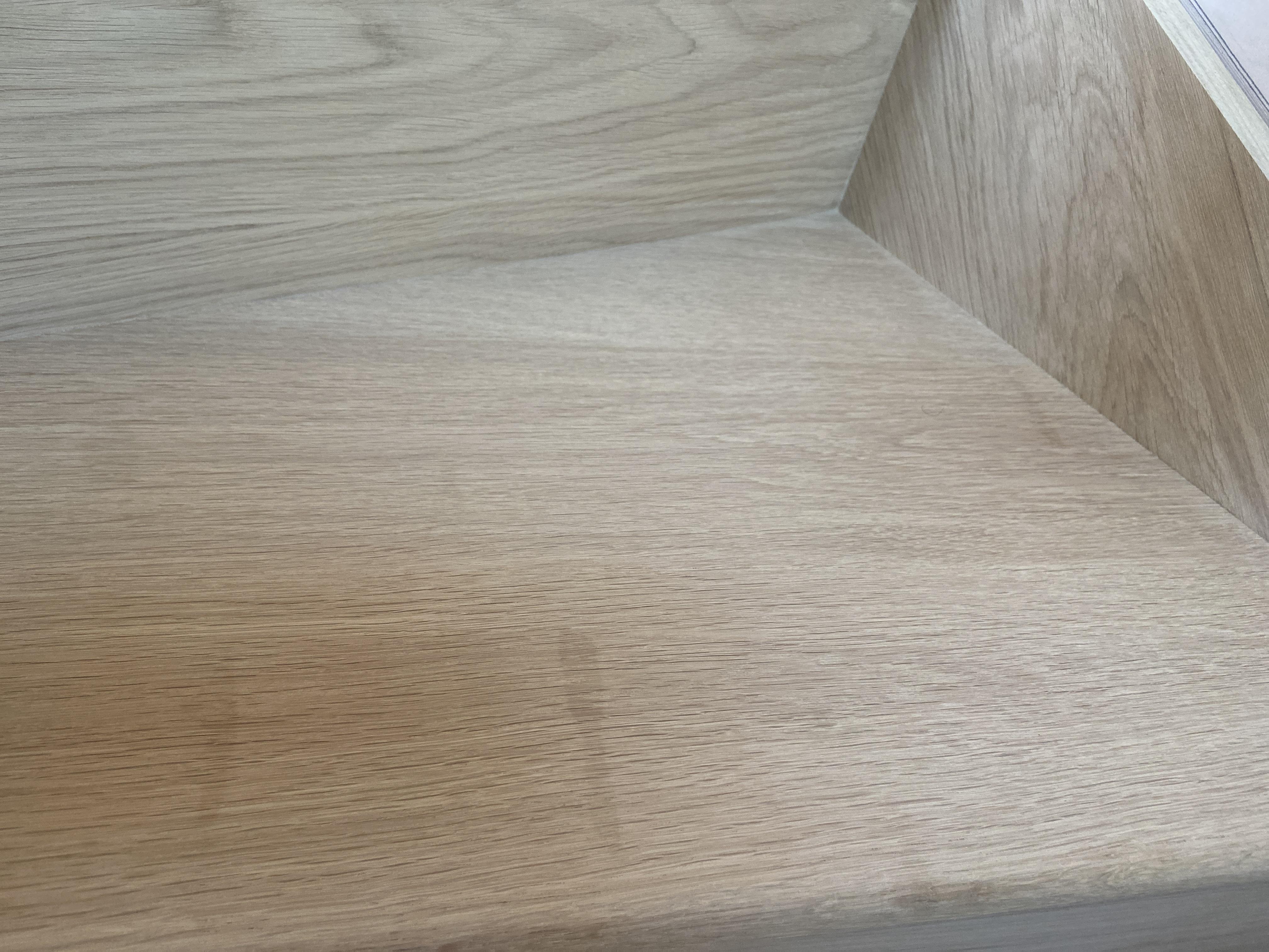

move tried the acid. It hasn’t made a difference. guess it wasn’t water.
I don’t think it’s water, the only thing I think is there was some glue spill (d4) that was wiped off shortly after. would the Oxalic Acid leave any mark if I were to try it?
I am not 100% sure it was the glue, I am assuming it was so that would be risky to get wrong.
I’ll try that. It won’t damage or leave any kind of water mark will it?
What grit would you recommend to use?
Ive given the stairs a light 120 grit sanding. And that’s not removed those marks.
Hi all, I am trying to get these ‘stains’ off my oak stairs. I have been cleaning them ready to osmo oil them. I have been really careful not to spill anything. I am assuming these came from when they were fitted, and some of the D4 glue being used got on there and was then wiped off. I was wondering will these show once oiled (I’m using osmo raw). if they will what’s the best course of action? To sand them out? A product that I can use? thanks in advance.
