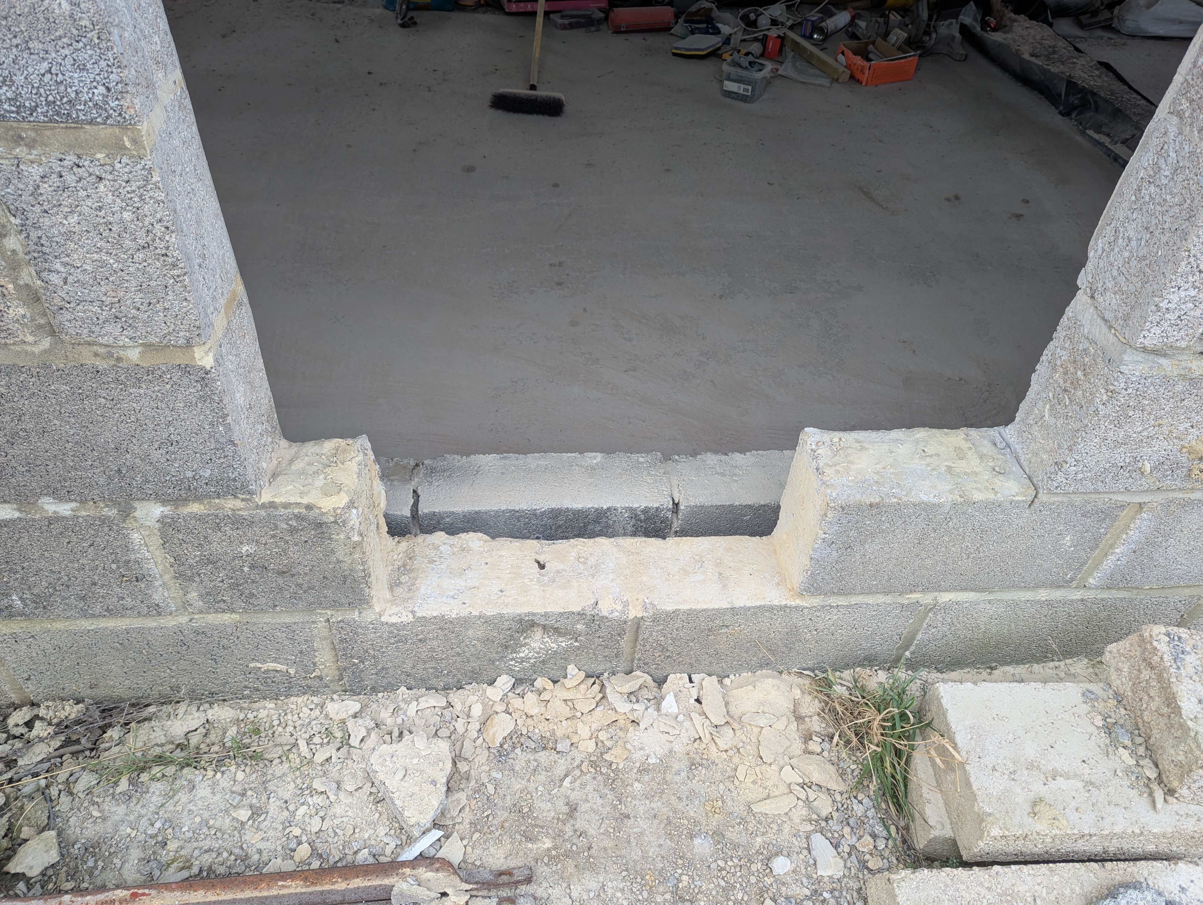

	Cavity external doorways- returning blocks inside to out?daunker replied to daunker's topic in Brick & Block Ok so heres a photo. Single course of 140mm blocks timberframe to sit on top. Finished floor level is a little below block height, will be a 25mm celotex upstand internally and 150mm insulation then 50mm liquid screed with ufh pipes in it. Timber frame is 145mm with rockwool between studs then going out 11mm osb, breather membrane, 50mm PIR then 25mm ventilated cavity. I was going to also run a say 10m strip of 50mm PIR externally on inner course of blocks. Is returning blocks like this a normal design, feels a little cold Bridge-y?

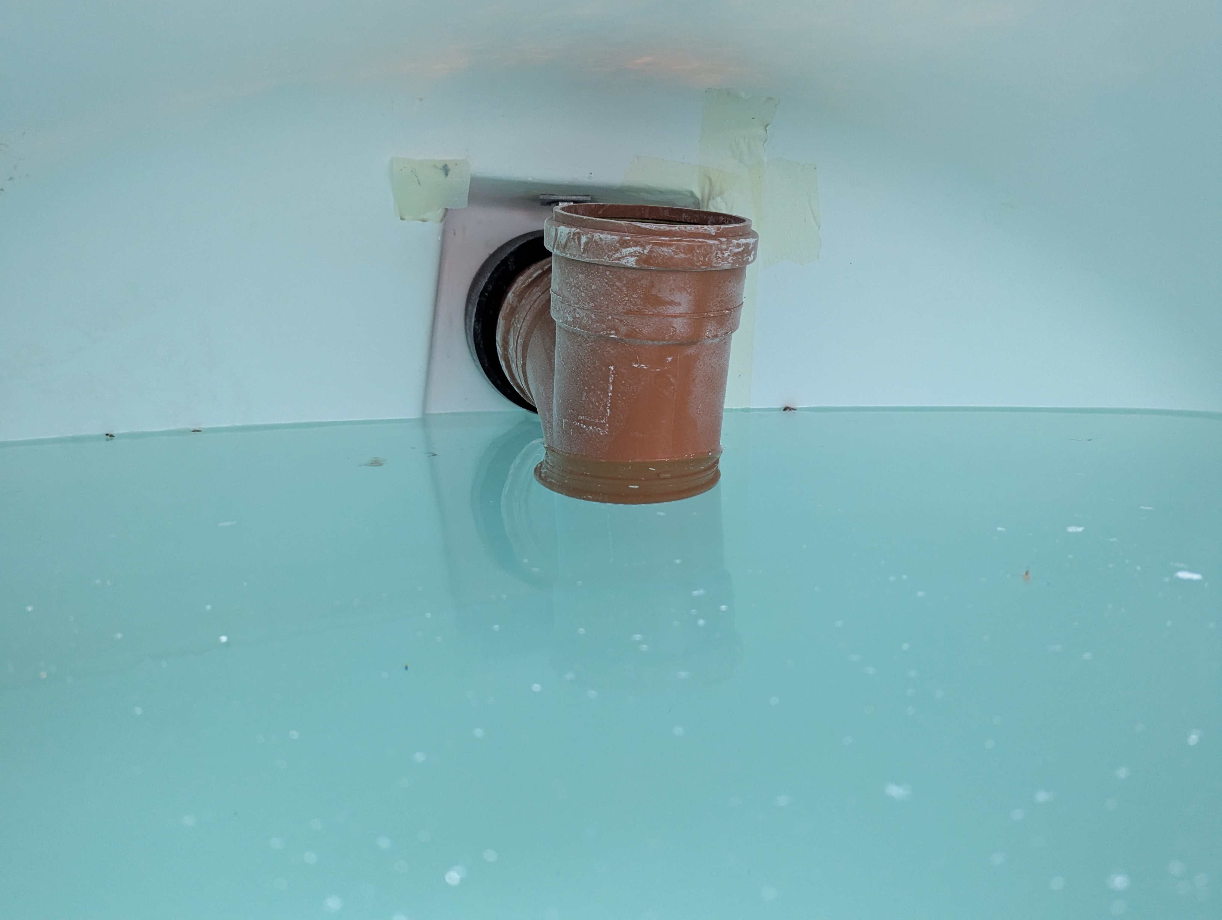

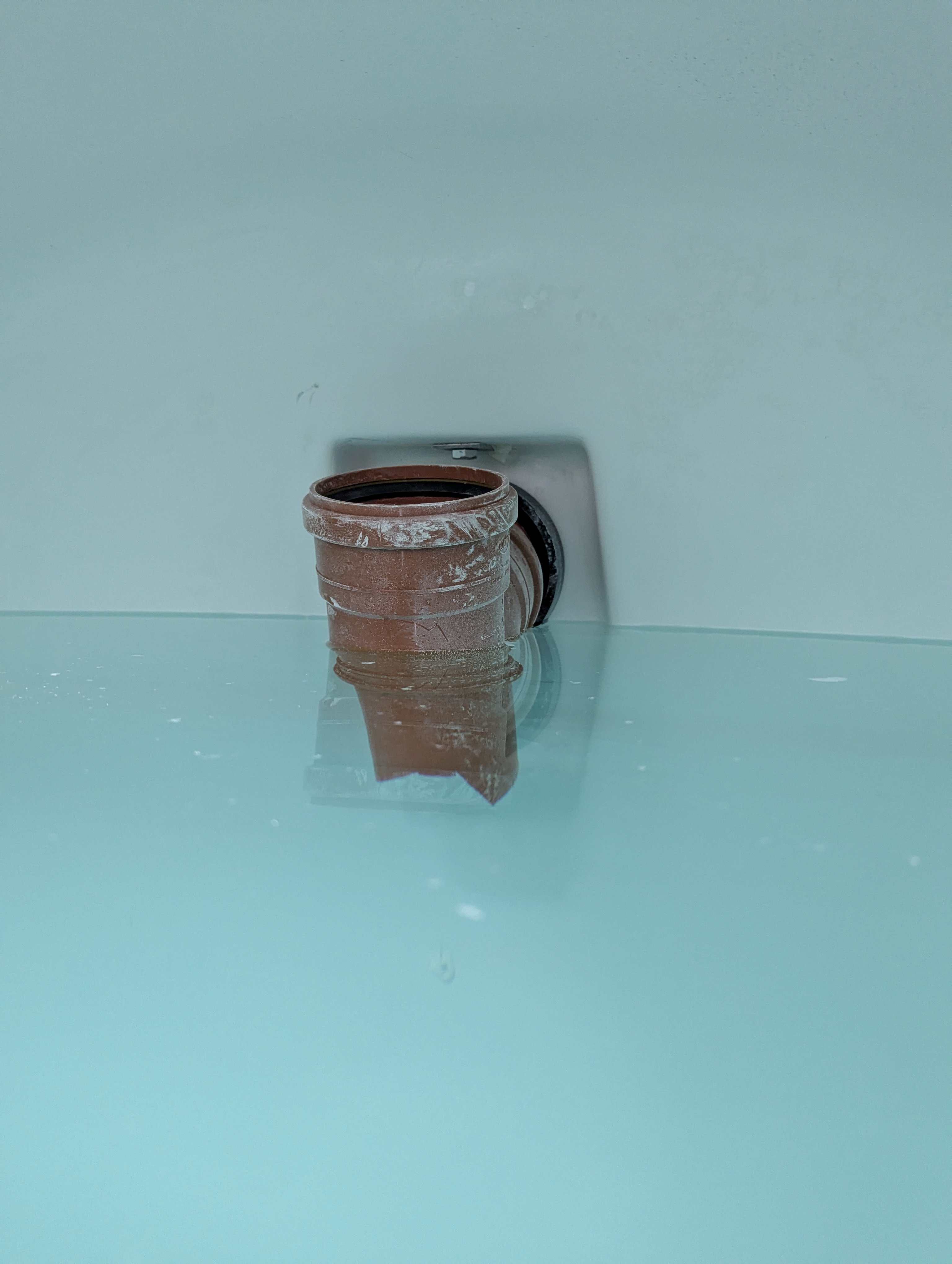

	Just concreted in treatment plant (marsh), and looked inside. The inlet T is below the waterline. It's filled with water and flows between chamber and to outlet fine. But I was just curious about this. Is this how it should be possibly to airlock/gases(?) In my head I was concerned about anything coming down having to be pushed down into the liquid below or it could cause a backup. Ok most stuff should sink, but was just not sure. Thanks!
	I'm doing a conversion with existing blockwork. There are two openings for doorways, one ive cut and the other was always open. Internally there is a course of 140mm block that I am laying fresh and then will be dpc and timberframe sit upon this. Outside to in will be render, 140mm block, 25mm ventilated cavity, 50mm PIR, 11mm osb then 145mm timber frame 11mm osb inside and plasterboard. Rockwool between studs. My question is, friend has said on the other opening (no existing external course of blocks) I should return blockwork from inside to out, and on this one I should have returned it. As I haven't I should infill (with concrete). Is this right? Is there another way. I kind of presumed I would just get those cavity closers, I am mainly concerned about cold bridging, but also want to do it right! I'll be running the celotex on outside of timberframe 'long' so that it overlaps the top half of the block, to give some insulation and inside I have insulation and then screed with ufh so again will have a strip of pir around perimeter. I was wondering if I should get some marmox thermoblock just for these openings. I could afford to do a course around the whole building hence using the blocks I have. Fingers crossed someone knows and thanks!

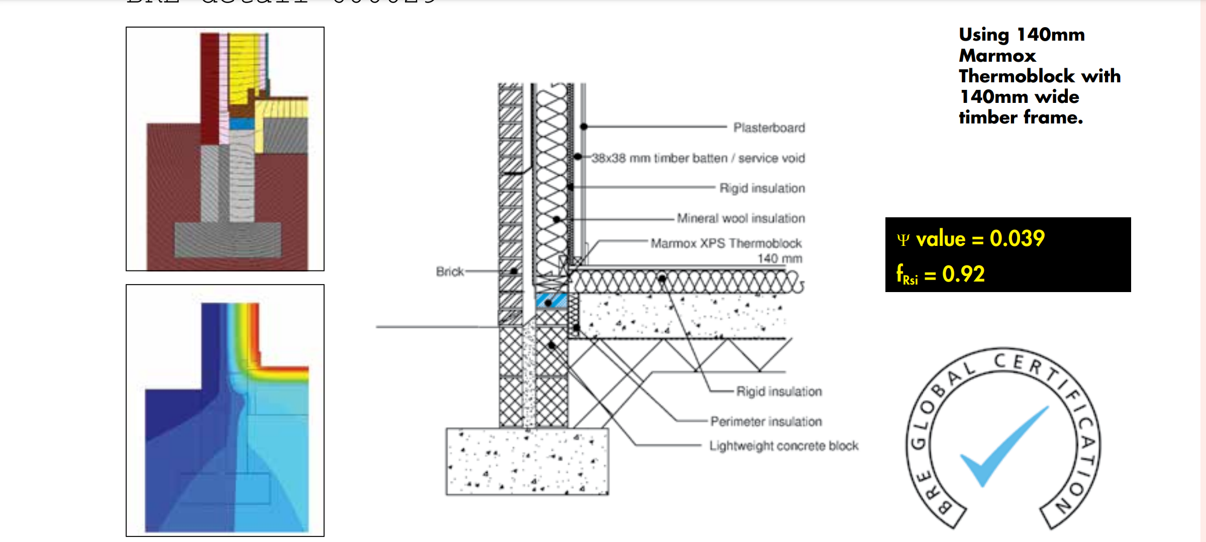

	I'm doing a conversion and building timber frame inside existing 140 dense blockwork building I've read about problems with condensation on soleplate occuring. What is the standard block below soleplate. I had been hoping to use thermalite or equivalent. I looked up marmox thermoblock, and they have detail below. Whilst I can see there is advantage to having it below soleplate it doesn't mitigate the cold hitting the front face of the soleplate. I had thought that air temperature on this face might be more prone to dropping below the dew point and does this not have same condensation risk as from below? If condensation is not an issue then I can sort out cold bridge with rigid insulation on internal face of the frame? The thermoblocks are expensive and I was rather thinking that whilst they may be a better option. Is it reasonable to just have thermal lightweight blocks below soleplate. And are there any specific ones recommended. I've read on here of many 'blowing out'. It's only single storey and doesn't support roof etc. Thanks!

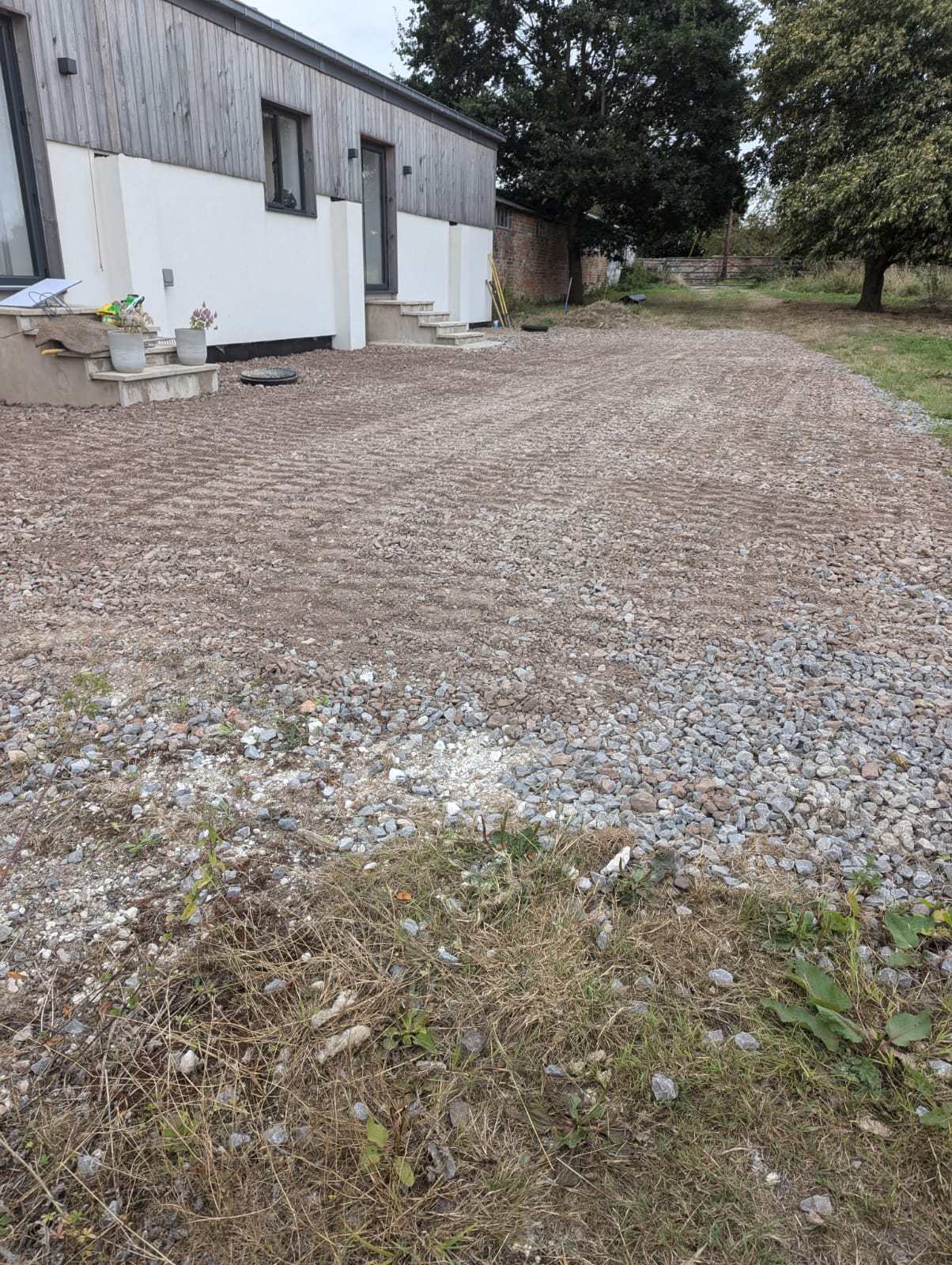

	Hi I have an area at back of property which I have put on type 1 and intend to whack. My hope was to slab some of it but funds won't go that far. I was going to put terran membrane down after whacking it and then have been suggested to use driveway (self binding) gravel, rather than clean loose stones (which are problematic to contain and less comfortable to walk on). But Im concerned a self-binded solution won't 'look as good' i've seen the stuff used for paths and seen it puddling in heavy rain and imagine even when damp it'll track into the house. Wondering about a skinnier base and then a top dressing of the 20mm size stones/gravel perhaps with a gentle whack? Or is there a better option. It's about 5x20m so a big area! The other thing is I'm not sure how to edge it, was minded by the modern 'sleepers' as easy/quicker to put down than edging stones and will last fairly well. I appreciate a lot down to personal preference but would really value any insight on it, it's rented out ATM so budget conscious and open to all ideas. Fingers crossed! Thanks
