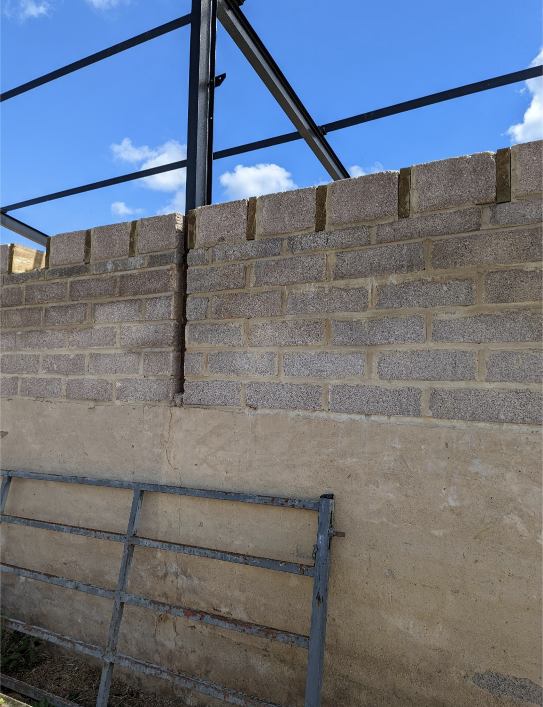

I'm converting a steel portal frame milking parlour, the blocks have been laid flat on one exterior wall for strength. Currently has dropped ceiling and roof sheets off. I want to carry block to full height. Do I need to continue laying them flat or can I switch to conventional. Lower blocks are all 140mm too, but either way was wanting to go to 100mm. There will be cavity and interior block wall. If I can switch or 100mm laid conventionally is there any reason not to up the insulation in the wider cavity, was going to use pir boards

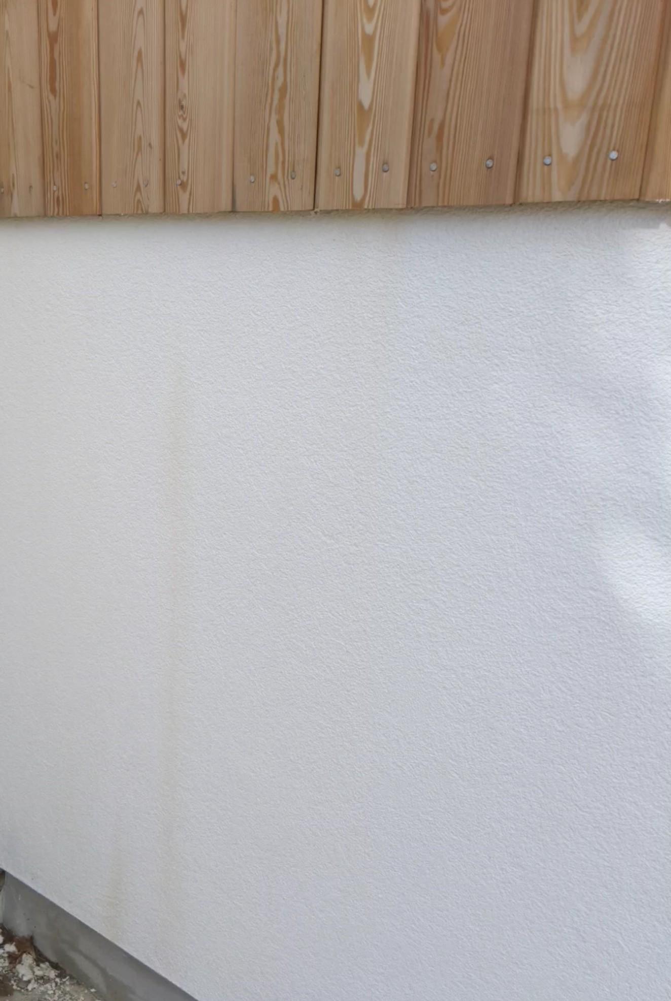

Thanks very nuch. Any drawbacks to sealing it, is there a good product? As it's in situ I'll only be able to do the front face. Will it stop leaching on its own accord, or is that a very slow process. Any advice on cleaning will rain and sun bleach and wash it or is there a recommended cleaning agent. Sorry for all questions thanks @nod. I'd not heard of it before or I'd have not put up untreated, I thought all the coatings were to colour preserve from sun bleaching (which doesn't overly concern me)
I have untreated Siberian larch cladding and just had the renderboard below rendered a couple of weeks ago. The larch was put on in April. Anyway just had some rain and seems like the water running down the cladding is staining the new render below. This is only after two rainy days... Really worried how this will look by end of winter? The rendering is thin coat system. Is there anything I can do to stop this happening, and secondly to clean if presumably I can stop it.
