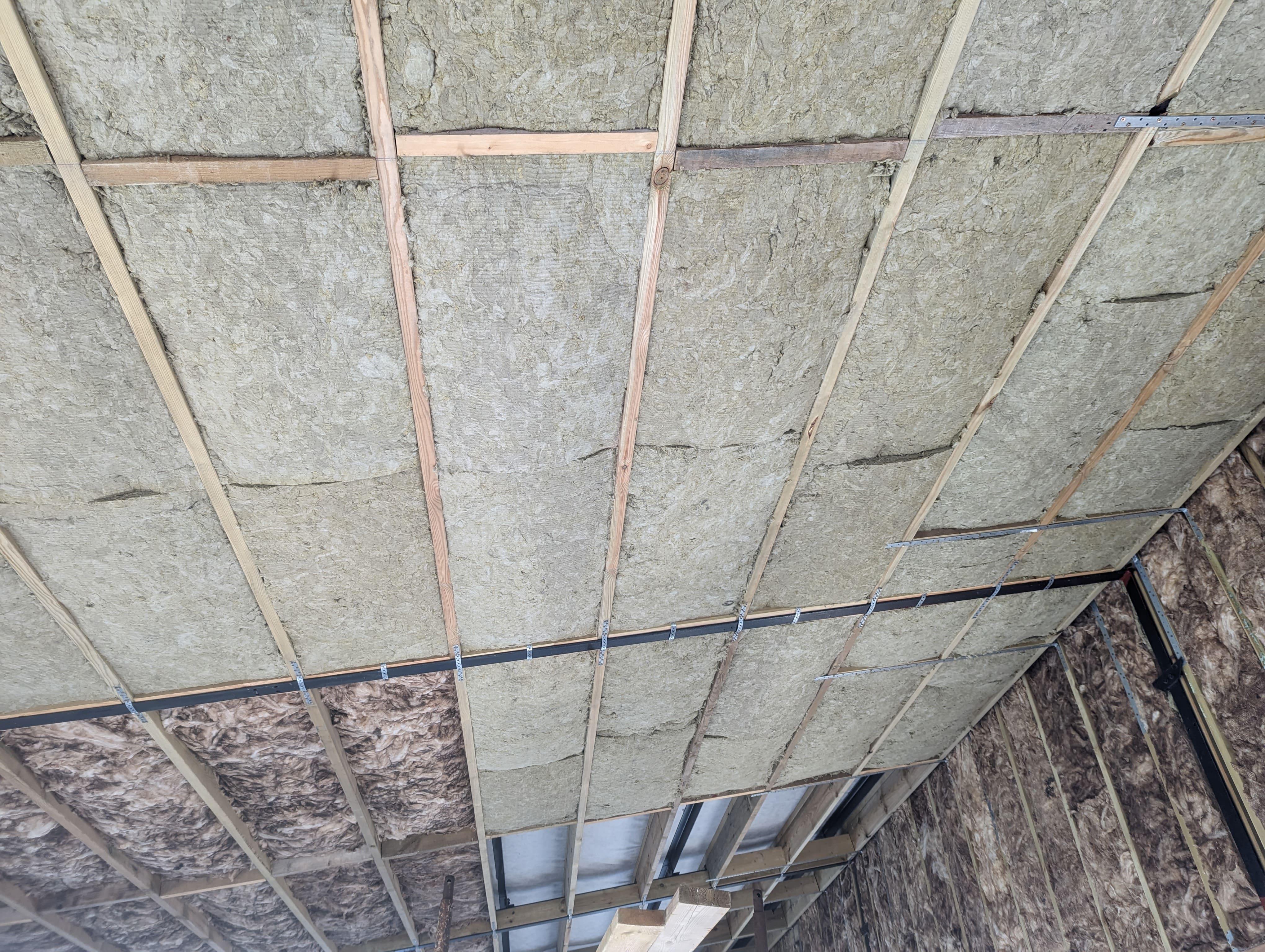

  8. Converting an existing building, I have been putting 140mm frametherm 32 between purlins and then 75mm rockwool batts below. 600mm c/c I have trimmed the rockwool batts. However there is some sag, some worse then others. Due to budget constraints I'll not be able to put ceiling finish (timber not plaster due to building movement) for some time. But I do have the 50mm PIR sheets to go under the rafters. Is it strong enough to support it, or will it flex too much? Suggested number fixings per sheet? Was going to use penny washers/insulation discs. (Also while on topic anyone done a timber ceiling finish, and can suggest any good wood options)
  9. Thanks team, couldn't get better, ended up hiring a van and driving 380 miles to do two pickups from FB marketplace on the other side of the country, bizarrely both within 30miles of each other! After fuel and hire it it worked out at £24/roll for frametherm 32 140mm fitted 58 rolls in a Peugeot boxer lwb. Started popping it in today, rolls don't go far but seems nice stuff. Did consider about an hour into the expedition that I'd have been more sensible to just get the frametherm 35 and be done with it.

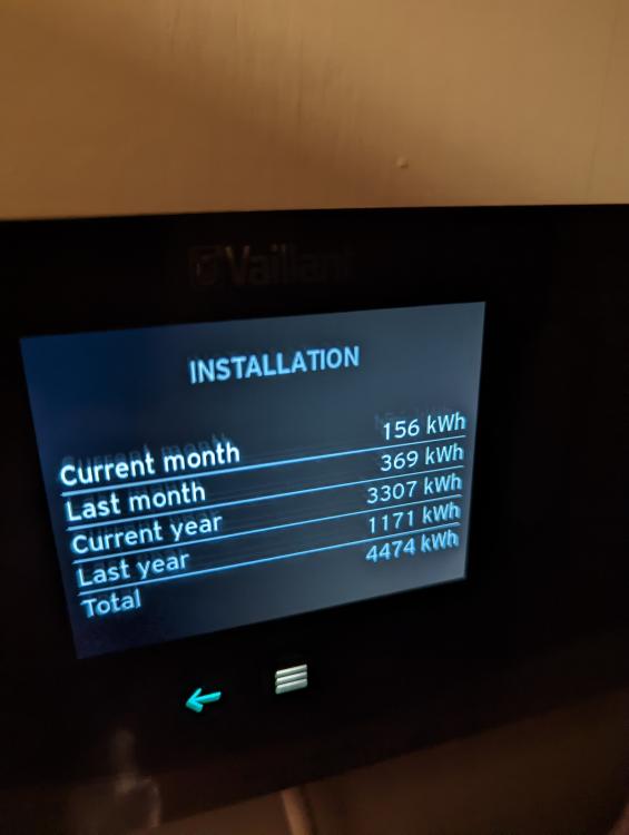

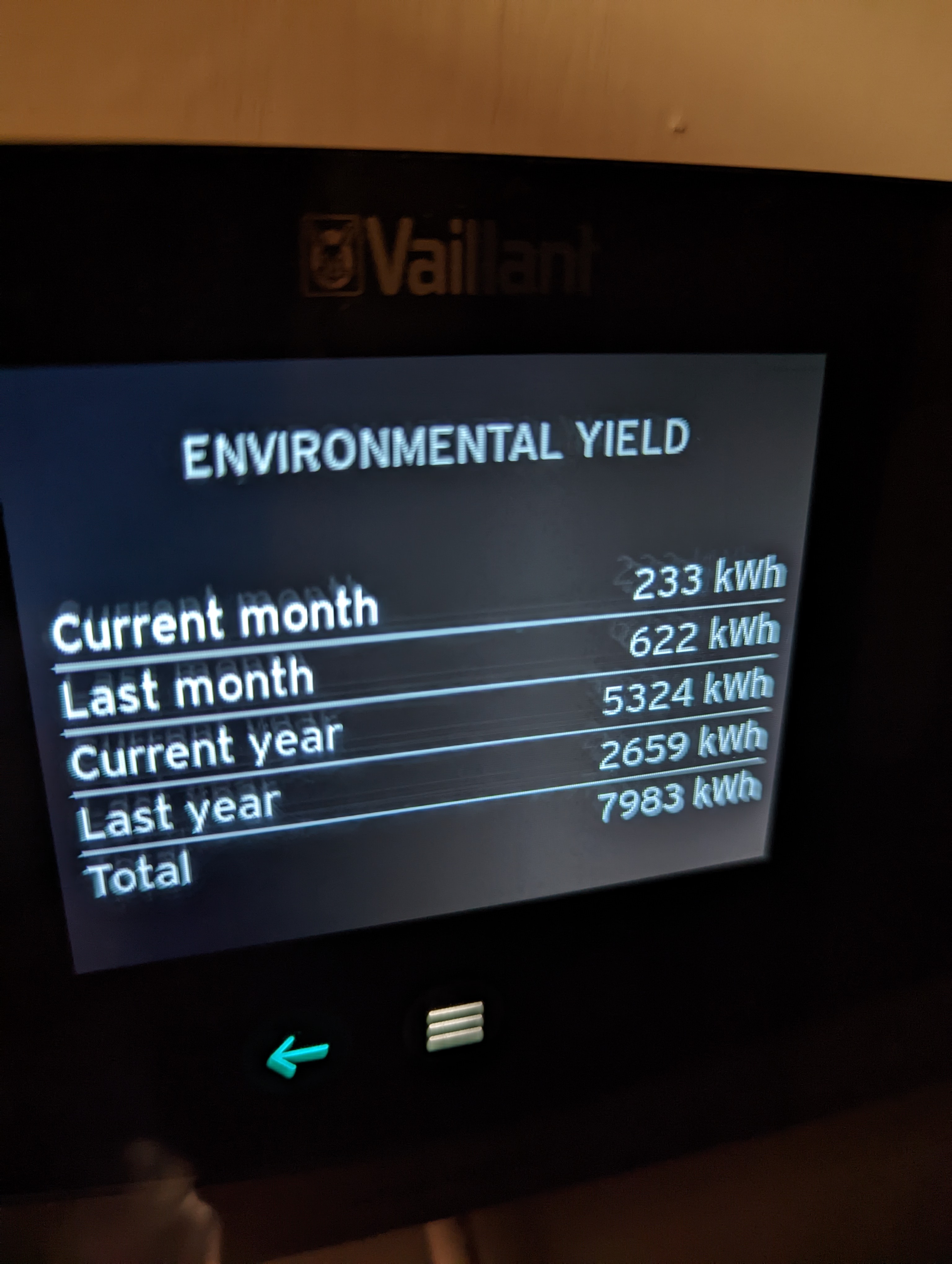

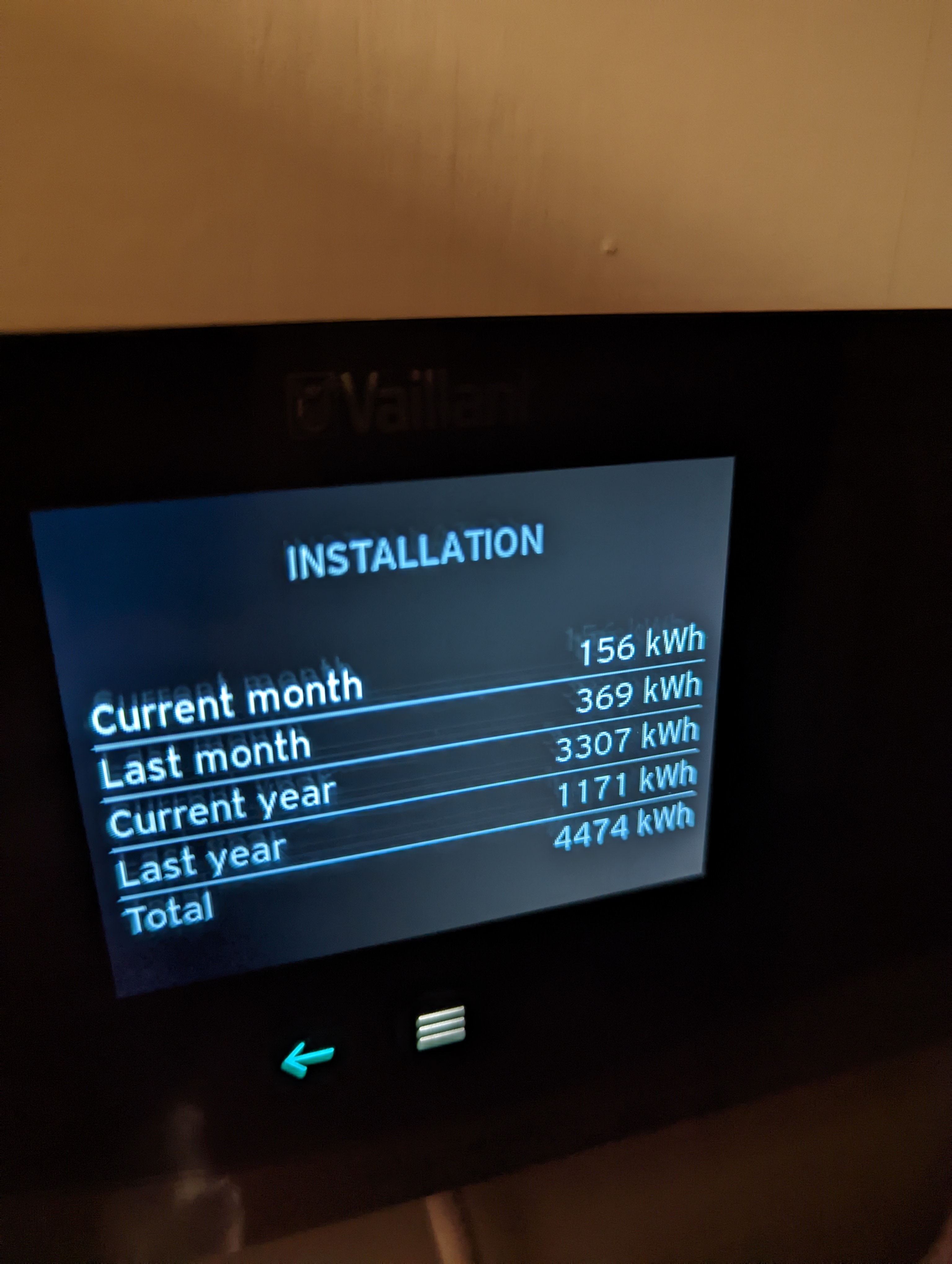

  14. Thanks! I've changed if to 0.4 and not noticing any deterioration in house temps at all, it seems to be running a better COP too, but was very poor over the real cold weather spell we've just had. Thanks @jothand @Bob77for that, yes now read this in Vaillants brochure but really appreciate you for posting. Seems unusual way but I guess makes sense once you wrap head around it. having a lot of fun playing with controller settings if nothing else, although changing so much and the environmental temps are so variable that I'm not sure which changes are making the biggest impacts. Definitely heading the right way tho
  15. Thanks!! So I have a 50L wall hung buffer tank. I've been researching and I think add the environmental yield to the power consumption and then divide by power consumption to get the COP. Still not good though (2.78!!). Does increase the annual heat demand to around 17,000kwh, does that still suggest it's oversized. The MCS installers said better to be a bit oversized as it is more efficient if it runs low and slow rather than full throttle, and also kinder on the unit with respect to lifespan. I'm not aware of it switching on and off regularly. Yeah temp for DHW is 55 and flow temp seems to be 45. I don't think I can change that. Thanks Marvin I think the arotherm plus has that inbuilt, to modulate depending on temperature. Clearly something not right though, and keen to get to the bottom of it. Thanks for prompts and starters will be speaking to the installers tomorrow
  16. Hi! I have an ASHP installed for a year and just thought I'd have a look at how it's performed. It's a vaillant arotherm plus 12kw. UFH in house, which has been kept constant 19 degrees all year (except when hotter outside of course!). Attach a couple of photos. The installation is cumulative energy consumption for DHW and heating. Does the environmental yield seem low, I had thought the SCOP was supposed to be around 4 +/- depending on flow temps. Or am I misunderstanding things? Thanks!

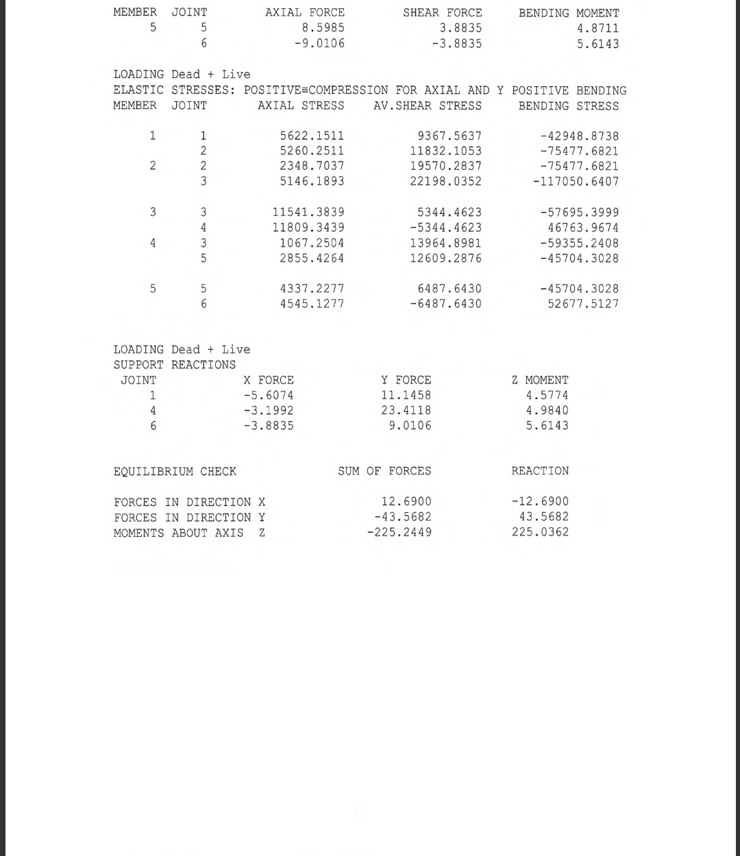

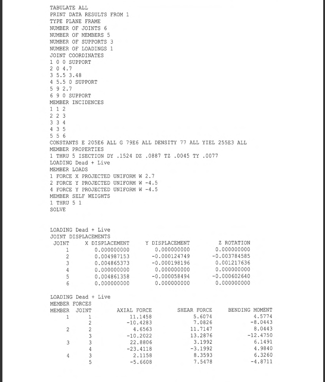

  21. Feels like this is going off on a tangent... But you both seem genuinely interested. How do I justify the building is sound, well I employed a SE. He came out, inspected and did calculations. I am sure I have already said but the building was constructed 1996 so not ancient. I have cleaned all the steels and zinc phosphated them as you can see in photos. The slab is in good condition. I attach some of the report. Does this answer your question?

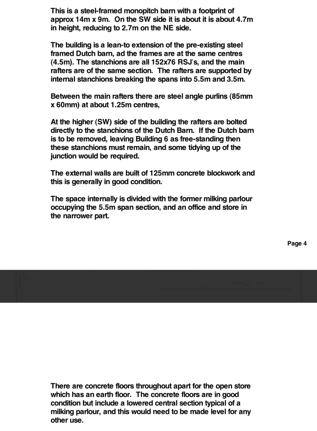

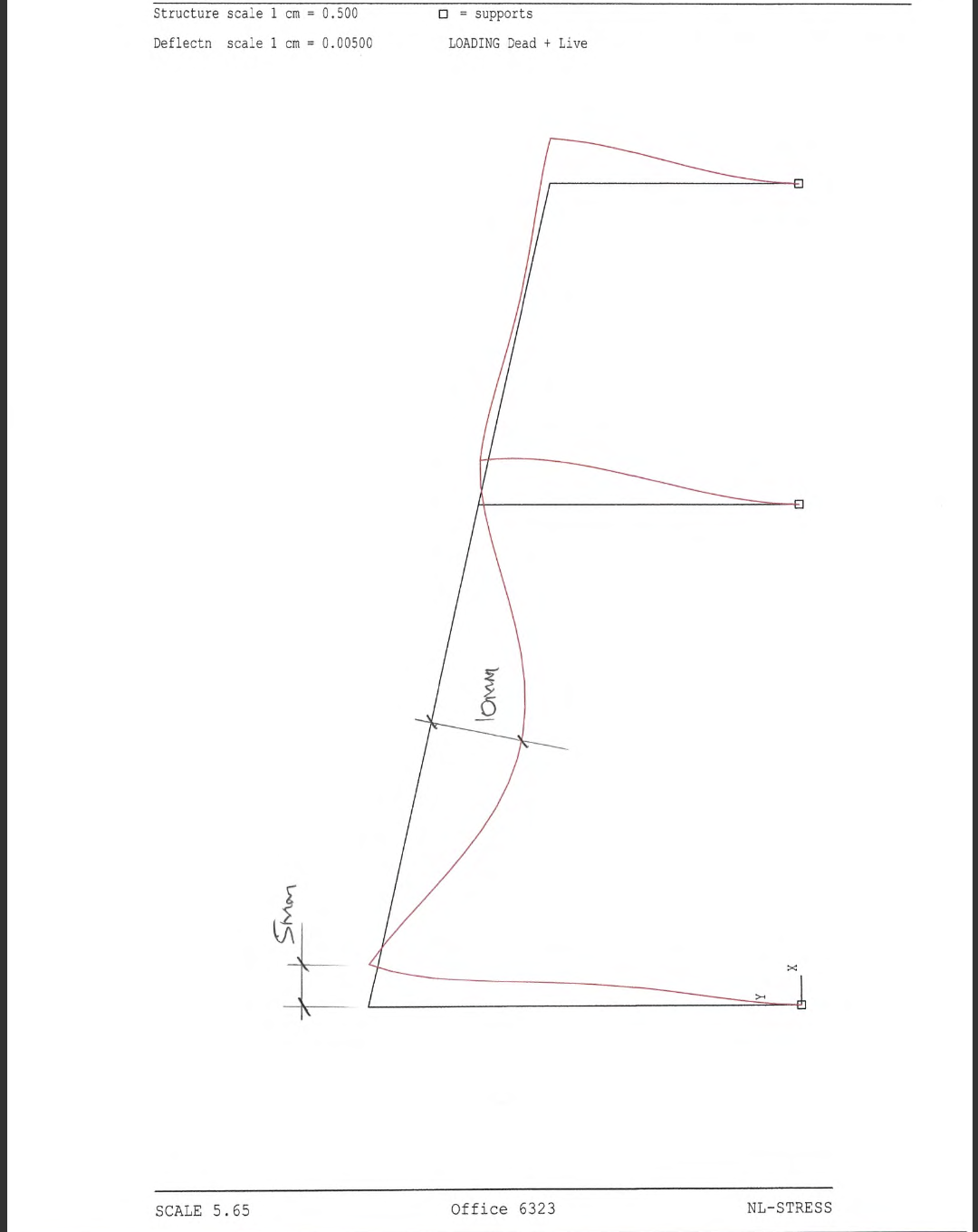

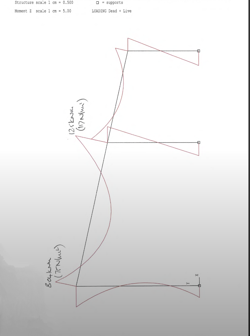

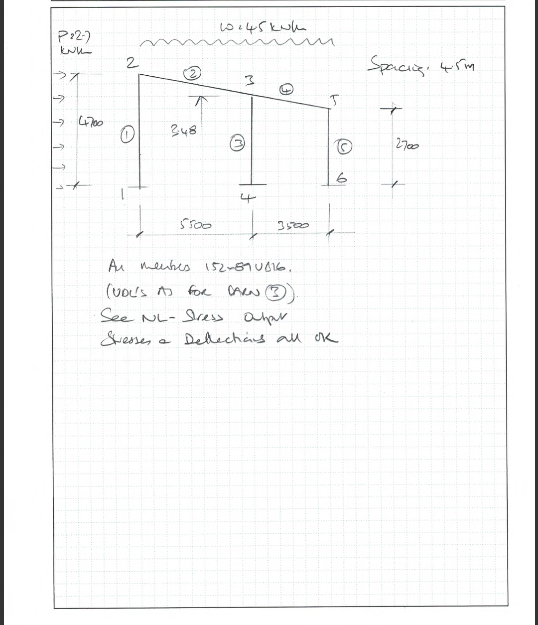

  22. Yeah so it's an even 100mm slab throughout and in good condition and at 26 years old it's seen plenty of hoofed traffic. So he has no concerns on it. He's to come back to me on the purlin fixings for roof. But it's only ply and zinc to go on there. I may put some timber purlins for ease of fixing insulation. I think there an acceptance that there is more movement with ag conversions than domestic hence the timber ceilings, but the walls are walls on which note... Spoke to him about the walls and he made very good suggestion, and apologies I maybe sent everyone on a goose chase. But he said cheapest and easiest probably go timber frame ontop the flat blocks. Add less weight and given will be timber clad at that elevation no reason not to really. I don't have any experience with timber, so will ask him to give the spec. Topic has been very helpful to steer me and ask the right questions, and hopefully get a good strategy devised.
  23. Yes - class q. SE report said it's fine, the roof is only ply and standing seam zinc, so not pretty light. I'm going to speak to the SE and see you guys have given me plenty to think about - many thanks!
  24. Steel Frames are 4.5m spacing, and the existing external wall is 2.3m to top of retaining blocks (top layer and rafters to be removed) then 1.8m of new height added to go to roof junction. Roof/ceilings to be supported by steel frame. Will be cavity and then interior block wall (100mm) and this would be tied in to existing external wall. Is this what you were meaning or should the existing walls be tied to the stanchion/to the block on the other side of it. Really just wanted to know if I could put 100mm blocks on top of the laid flat 140mms. But all input very much appreciated.
