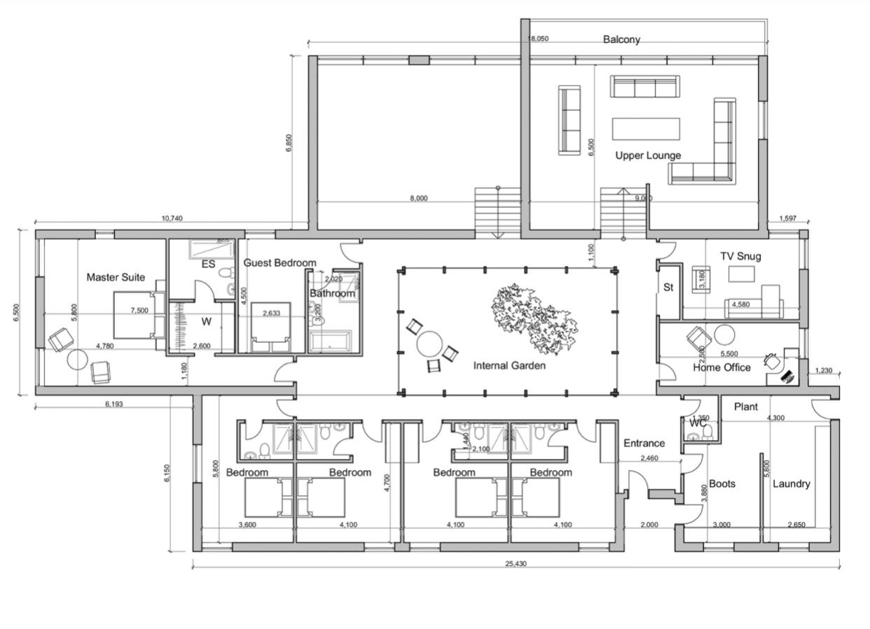

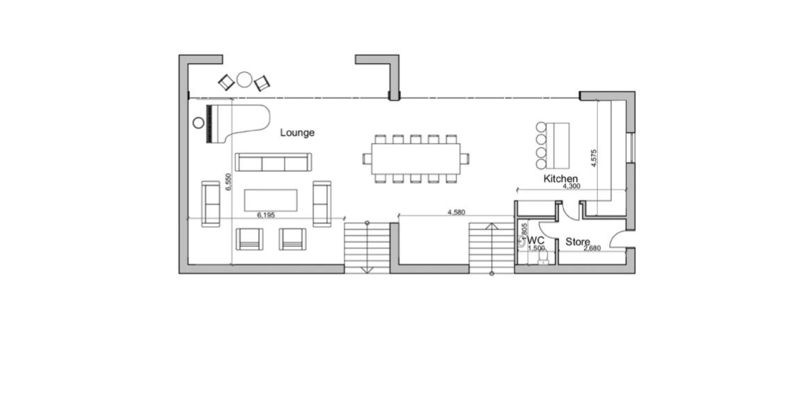

Thought I’d update on how things are progressing with us. Our mortgage provider has agreed the part release so we can separate the titles for the land we want to build on. Our current house had to be valued as a result. Having this done by a guy in full PPE; while you have every single, door, window and internal door open in your house with all the lights on while you, your partner, dog and three children remain in one corner of one room was......interesting! But it’s done. After approximately 5 rounds; the floor plan now has very little left to change, we think it works for us but interesting to see what you all think? Be nice....

Good question! We would like a modern agricultural feel/design but realistic. Have no desire for glass walls a complex roof design. The house should give very little away as you approach, then open up to the views at the back......maybe......planners might not like that idea.

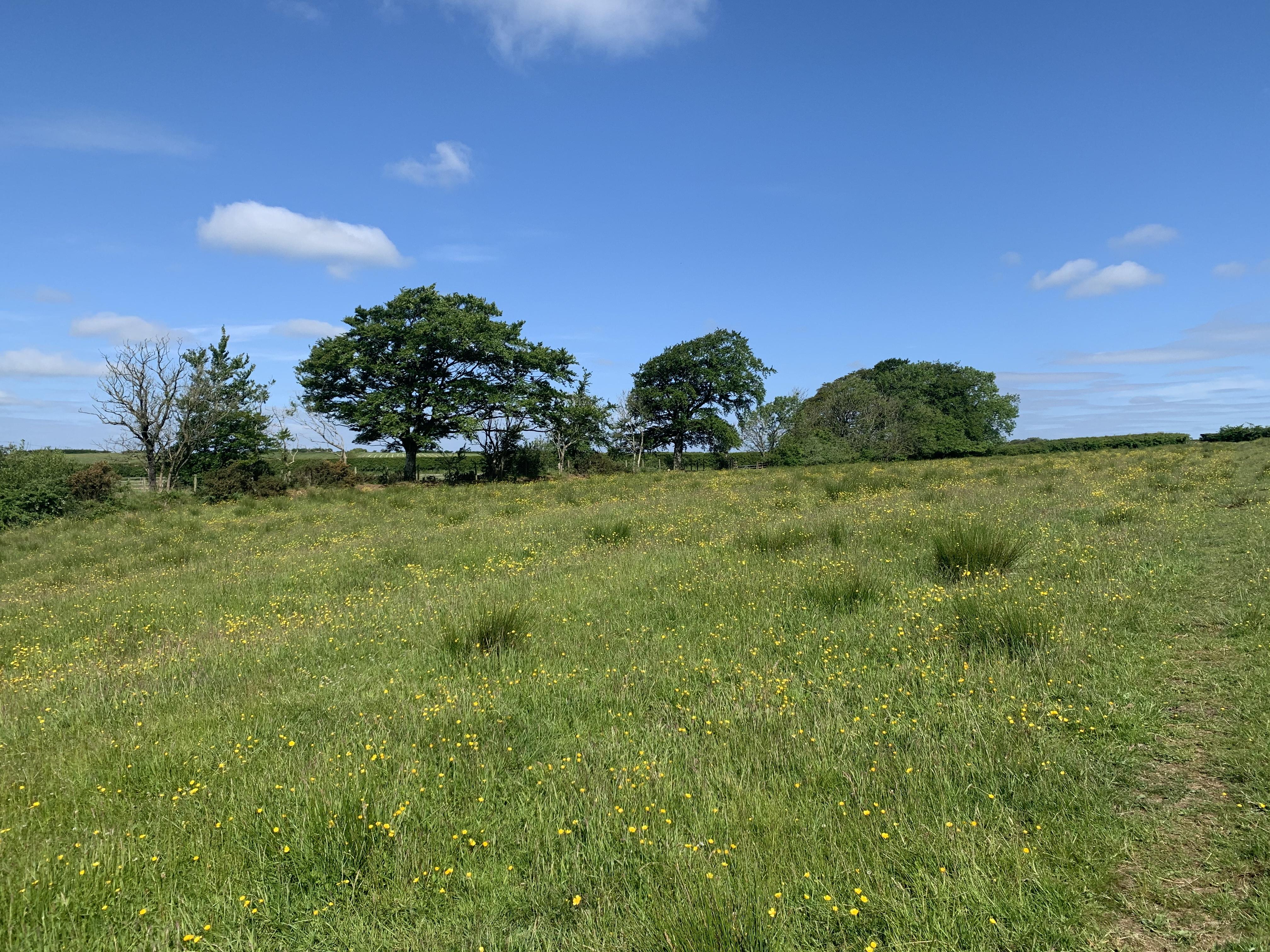

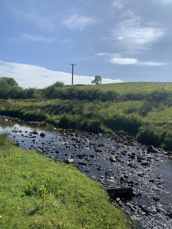

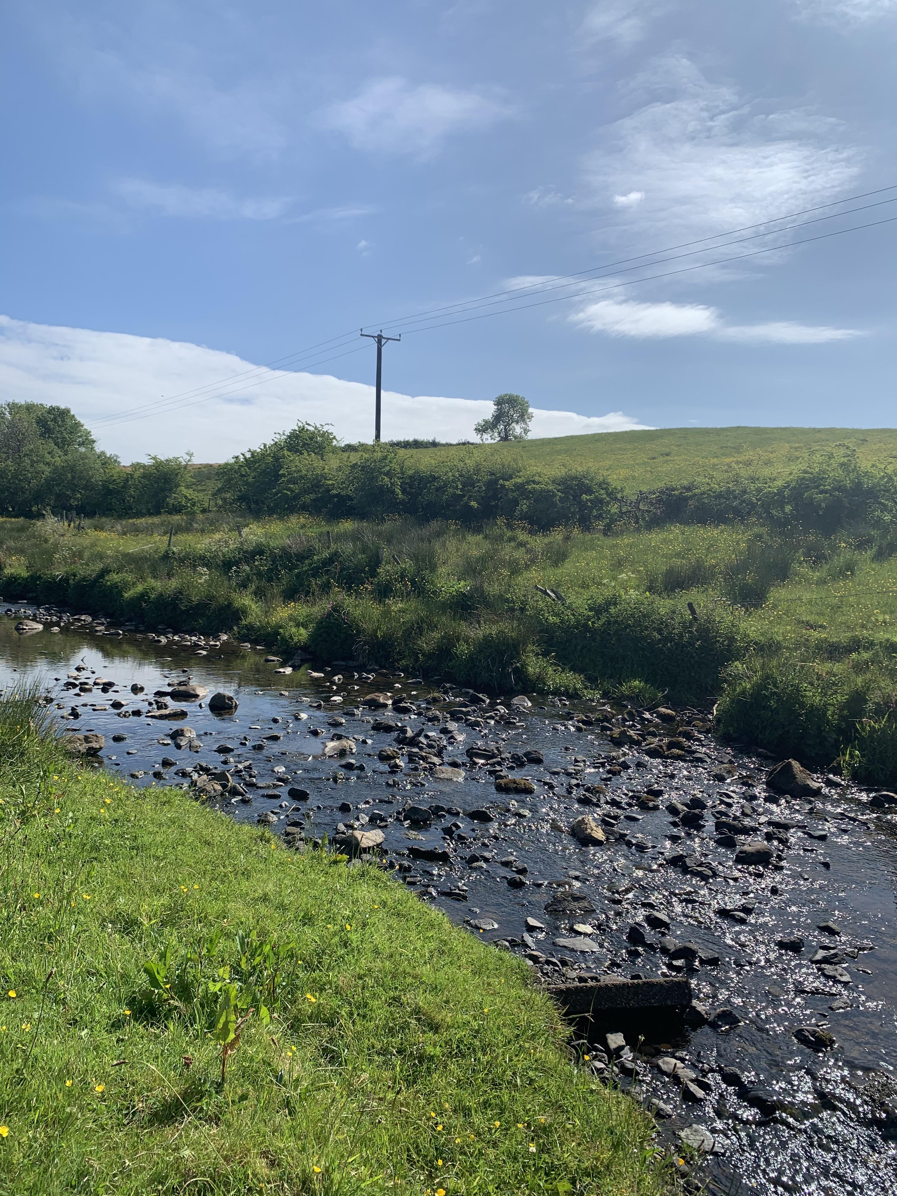

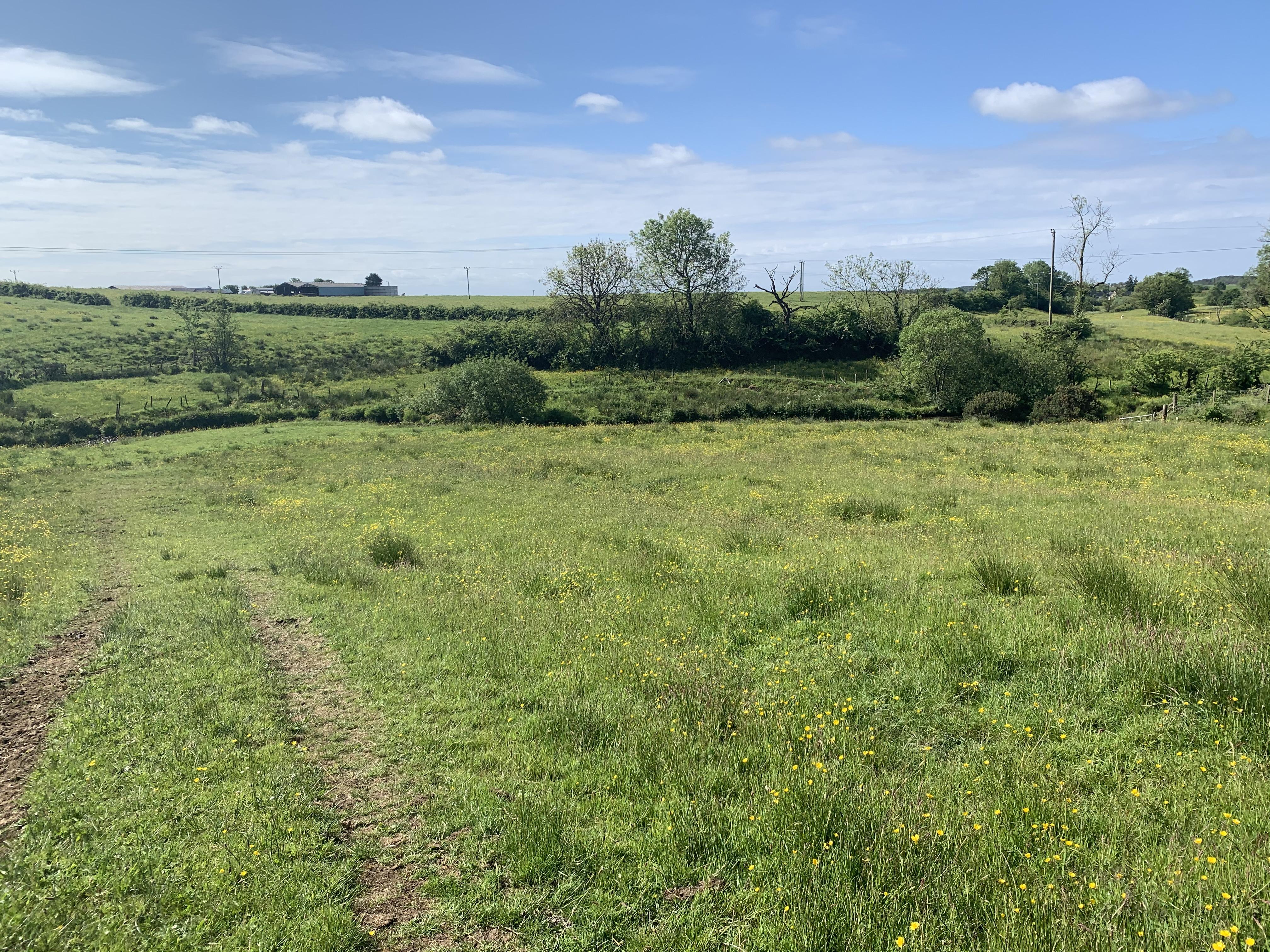

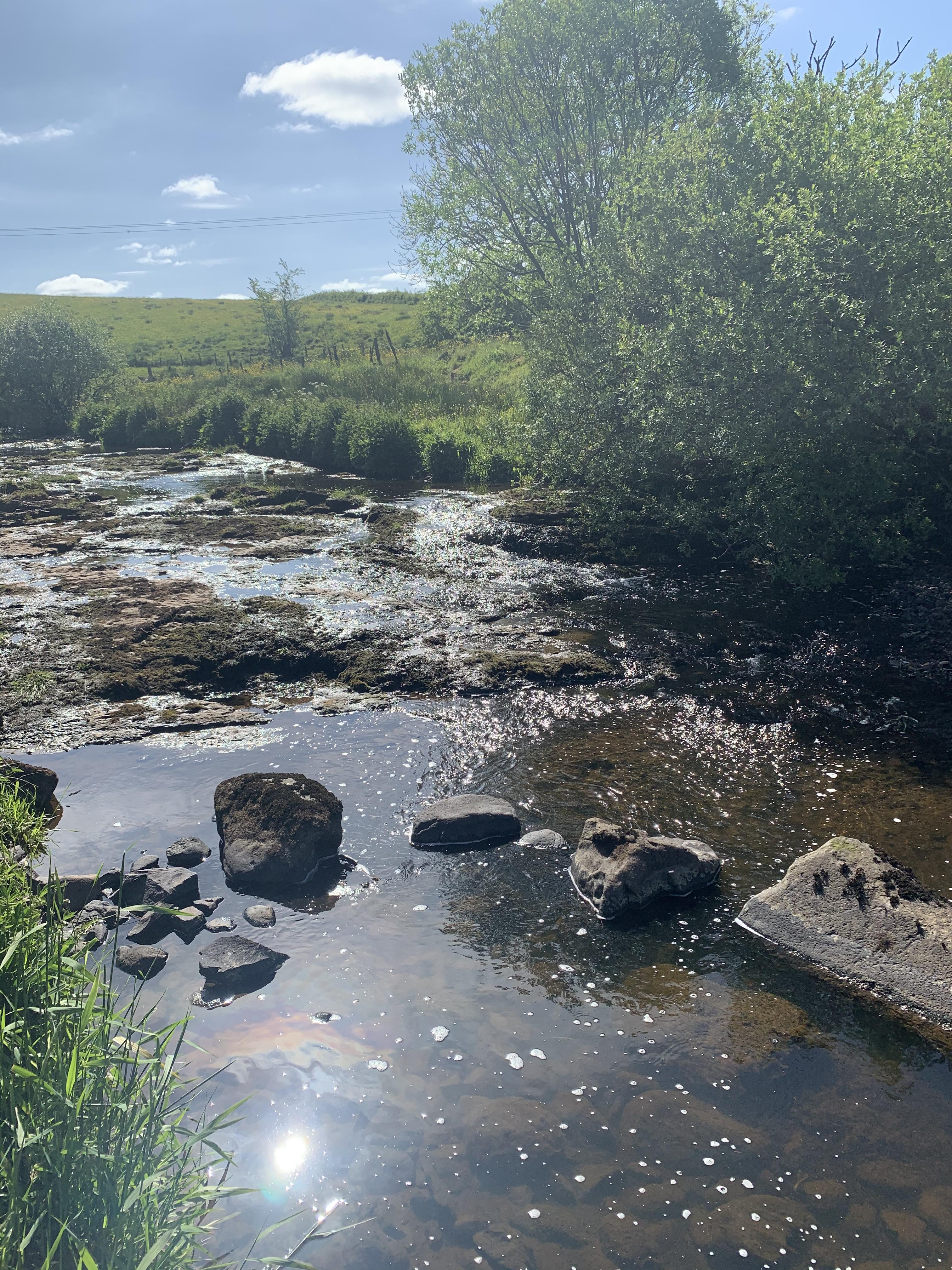

Morning all, Thought I’d share some pictures of the plot. We are incredibly lucky with it’s size, 6 acres as well as the Burn running through. On a clear day we also get brilliant views of the Isle of Arran. Architect was on site last week (socially distant) and is meeting with us again towards the end of this week. We now have a list of rooms and rough floor dimensions, he will workout the “flow” of these and start the process of design. Our solicitor has been instructed to separate the title (from our existing house next door) so progress finally feels like it’s being made!
