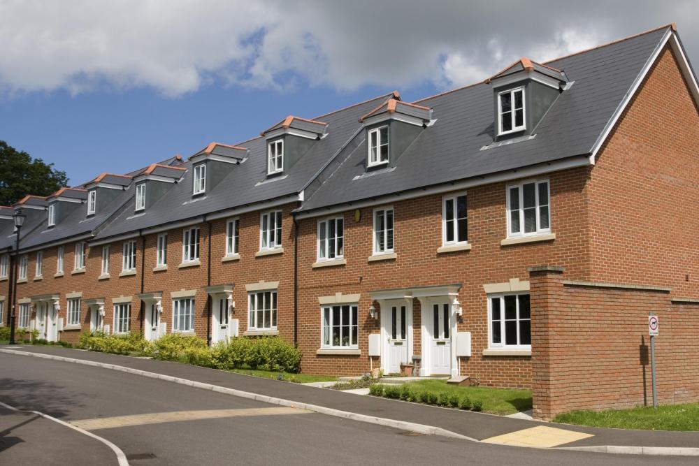

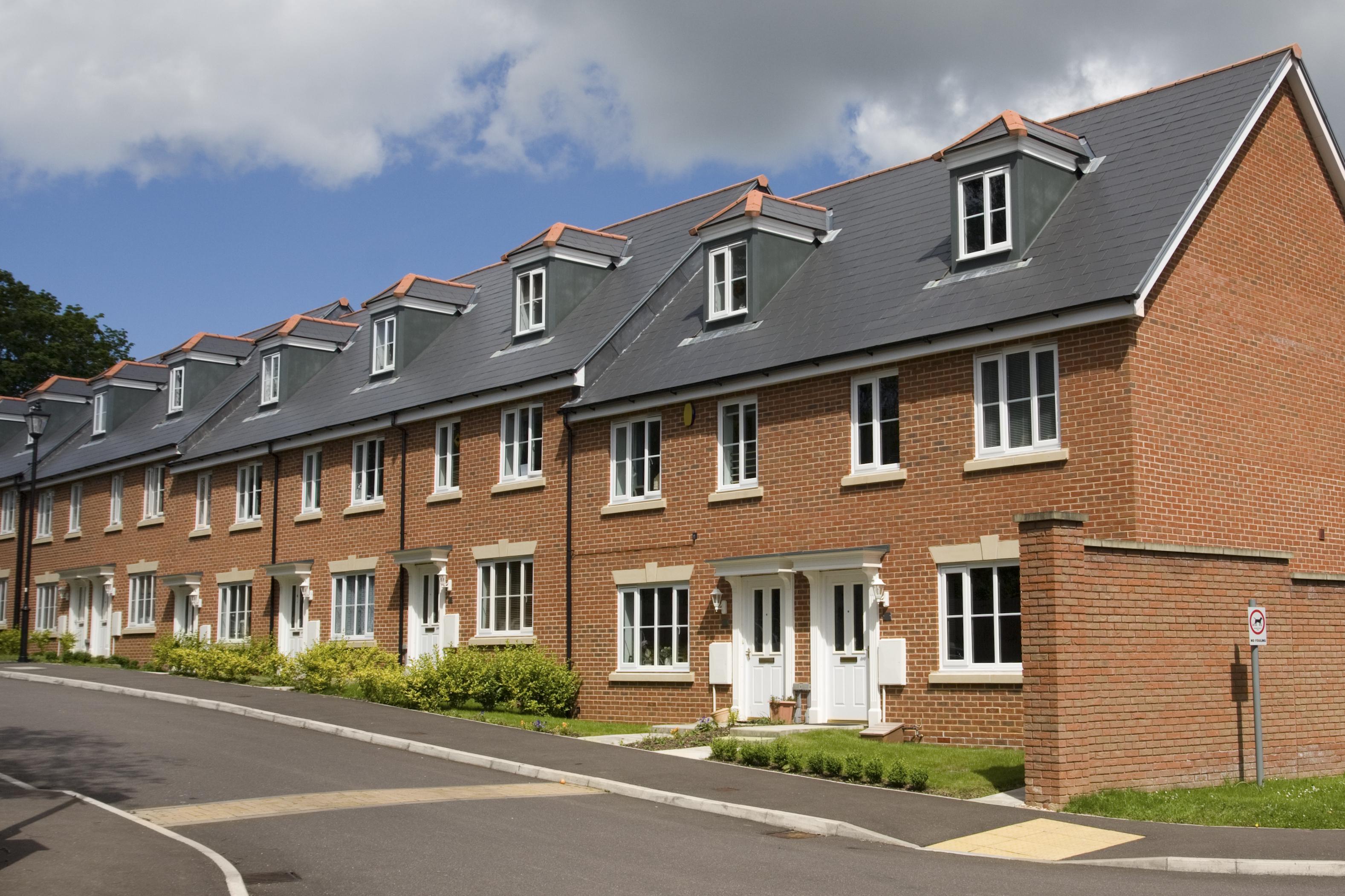

  7. For example and illustrative purposes, houses like this would require Planning for a porch.

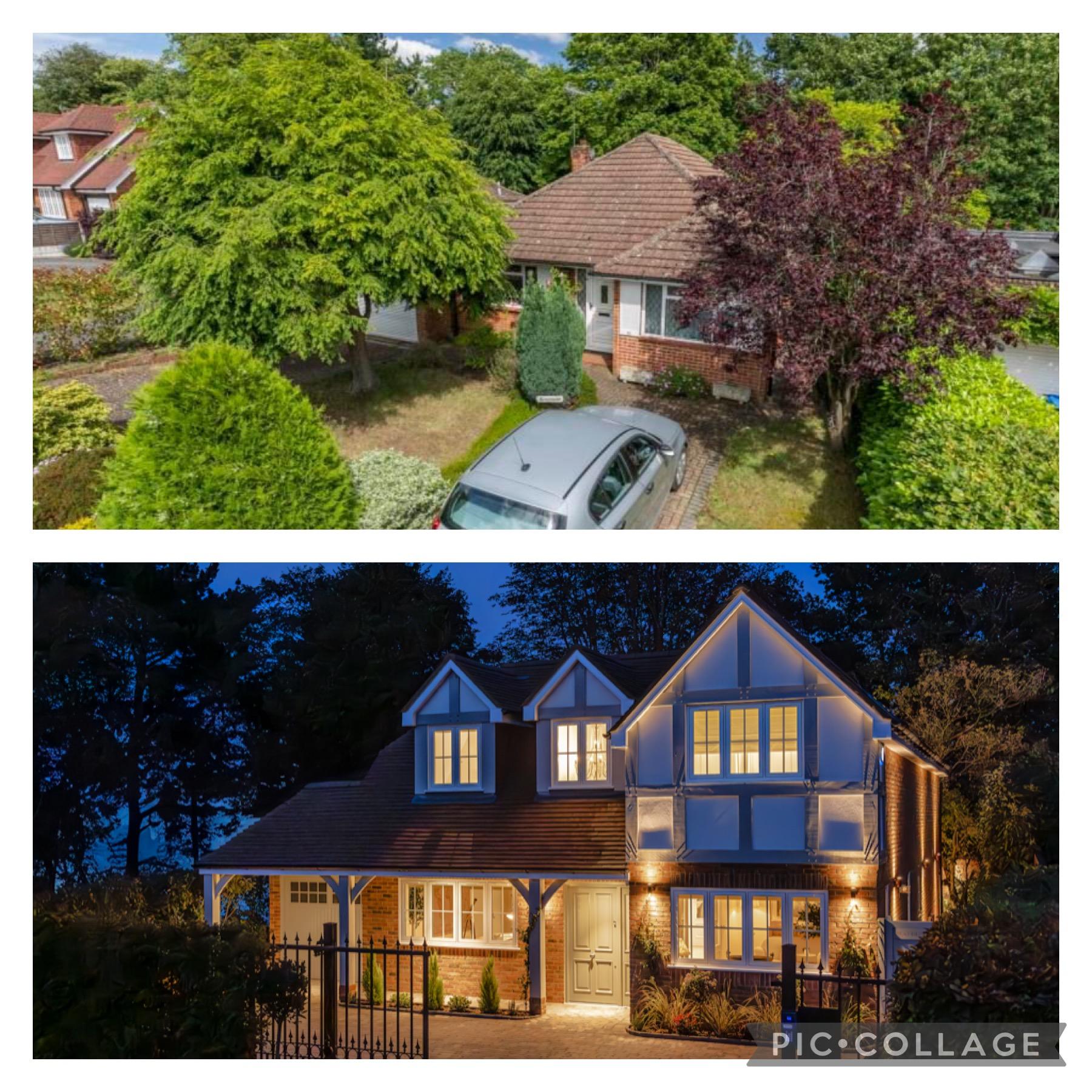

  17. And I was talking about going from the top image to the bottom image (for example).
  18. But if you can achieve the required rooms, spaces and layout with a more traditionally designed and in keeping design then what’s the issue? It’ll also be quite a lot cheaper to construct too.
  19. A latter Appeal decision will always in most cases override a previous LPA decision. The LPA will now (which they are doing) use the Appeal decision and the comments made by the PI in determining any future application. Without knowing what the existing bungalow looks like, I can’t see it being much different to the neighbouring properties. Why not consider a chalet bungalow/1.5 storey dwelling?
