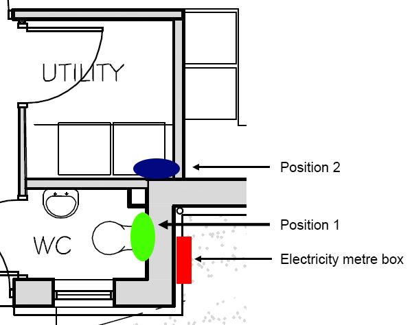

  18. For our new build, the main electricity supply will come up through the raft slab into the cavity (via hockey stick), into the recessed electricity meter box. From there we of course need to take the supply to the consumer unit. In the image, you can see the electricity meter box position (red). The consumer unit can be located either on the other side of the same wall high up in the W/C if regulations allow (green), or to the right in the utility (blue). The question is what's the best / safest / correct way to run the supply from the electricity meter box to the consumer unit? Presume it can't just be run inside the cavity? Should we bring it immediately inside and run it along the wall behind the plaster etc? And where would you locate the consumer unit? W/C or utility? Many thanks.

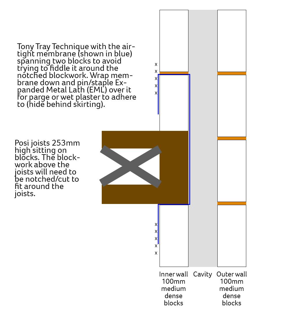

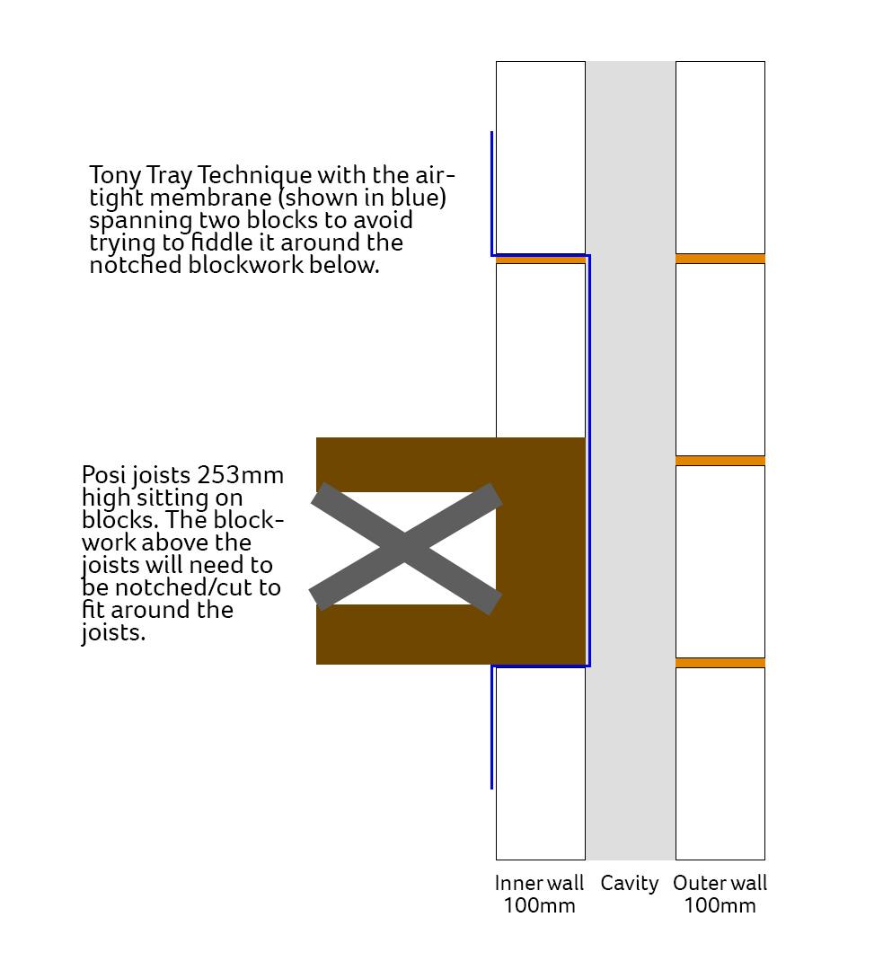

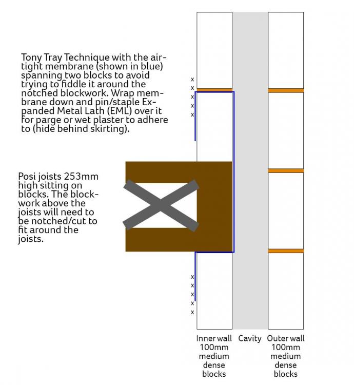

  22. We have 253mm posi-joists for our build, which will sit on the walls and therefore protrude above into the next row of blocks, so the next row of blocks will need to be cut/notched around them. We would like to use the Tony Tray technique, but to avoid trying to fiddle the membrane around the posi-joists and the notched blockwork, can anyone see a problem with bringing the membrane back in on the next row of blocks above? An overall flaw or perhaps a wall tie problem? See attached photos, hope it makes sense. Thanks.
