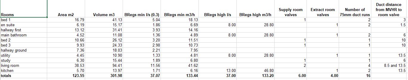

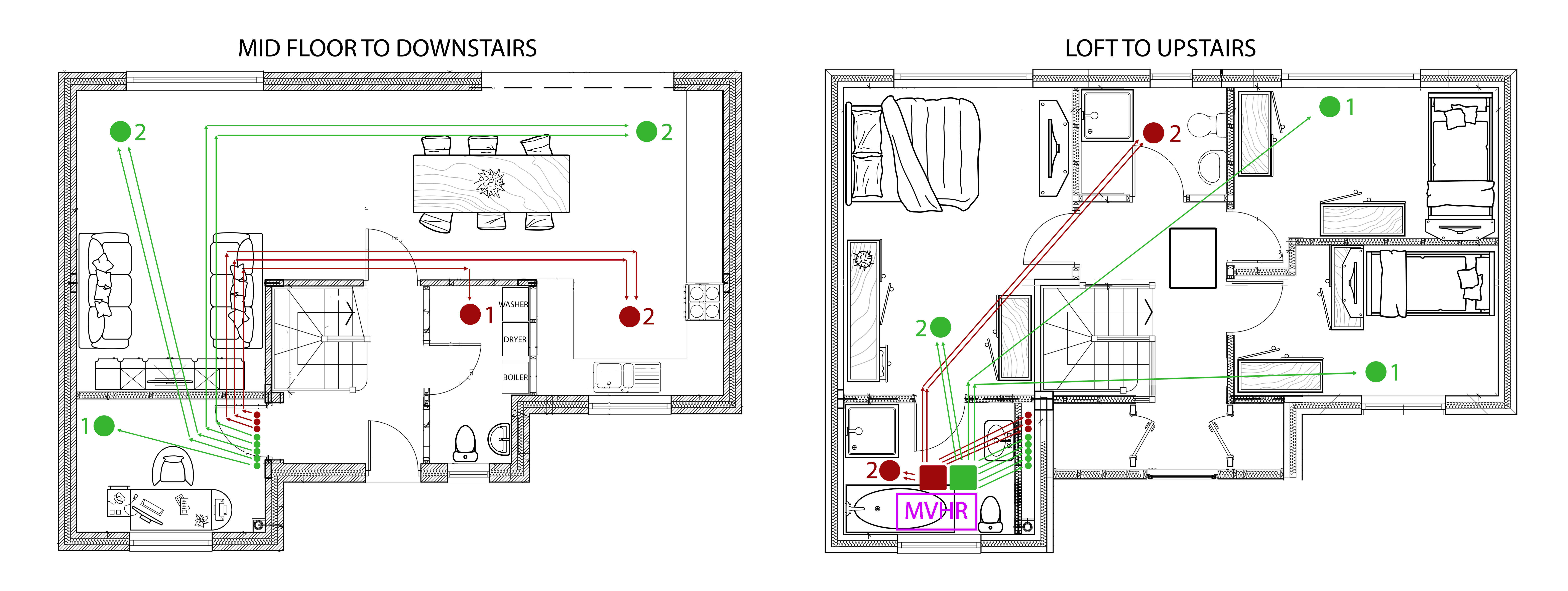

  1. Hi Everyone, I've spent ages trying to understand MVHR and what's best for my house, I could really do with some help please? Below is my design and some calculations, would you mind casting your eyes over it and help with any of my questions at the bottom? Thanks very much. OVERVIEW Planning accepted August 2020 so falls under building regulations at that time. Small 3 bed detached house, total of 126.5 square metres across two floors. Includes a family bathroom, master en-suite and downstairs utility containing toilet. Cold loft with insulation roll at ceiling level (200mm between 9by2 joists and 200mm crossways above), and Intello+ airtight membrane. Loft legs will support a loft deck over the insulation. Posi-joist midfloor so plenty of room for ducting although only 75mm gaps around steels in certain parts. We are not officially going for Passivhaus but there has been good attention to air tightness and good results are expected. House is up and watertight, starting first fix now. Plan is to install and commission the MVHR system myself. UNIT & DUCTING The current spec (from BPC) is a Vent-Axia Sentinel Kinetic BH with 75mm Anti Static & Anti Bacterial radial ducting. The most feasible and spacious location for the MVHR unit is in the cold loft space (above en-suite) to the front left of the house (North gable wall). The intake/extract through the gable wall will be nice and short, insulated, spaced minimum 1.5m apart to avoid cross-contamination. It’s also far away from the boiler flue on the other side of the house. Being a cold loft I will attempt to insulate the unit in a purpose made box to help. The radial ducting for upstairs rooms will run between the loft mineral wool insulation. The radial ducting for downstairs rooms will drop down into the mid-floor behind a stud wall in the en-suite. DRAWING The attached drawing shows the house layout, with beds, baths, showers, toilets, wardrobes all in what should be their final positions. The purple MVHR is the unit location in the cold loft to the North gable wall (above en-suite). I've worked out and planned all the MVHR duct runs myself. The green arrows / circles are supply ducting / room valves. The red arrows / circles are extract ducting / room valves. The numbers show either one or two duct runs to that valve (specified by BPC). BUILDING REGS NOTES Document F minimum supply of air to habitable rooms should meet both the following conditions (basically whichever is higher): Minimum rate of 0.3 litres per second per m2 of internal floor area - 126.5 * 0.3 = 37.95 litres per second (l/s) Minimum rate determined by the number of bedrooms (3) = 31 litres per second (l/s) Building Regs minimum high extract rates (l/s) by room type: Kitchen = 13 Utility = 8 Main bathroom = 8 En-suite = 8 Total = 37 Building Regs minimum low extract rates (l/s): 0.3 Space under closed doors - A 760mm wide door needs a 10mm gap to give required 7600mm2 of space. Wider doors need proportionately less. CALCULATIONS House Floor area = 126.5m2 Room heights = 2.45m House Volume = 310m3 The table shows my actual calculations when measuring the rooms in the house (slightly reduced floor area and volume due to stud walls etc). BPC BPC have designed / specified / quoted a full system. I'm happy with their pre-order service and help but it's of course limited at this stage. It's quite a basic specification so I'd like to check if I need to make any affordable improvements, for example making my own acoustic manifolds (as some have done on here) instead of the basic stainless steel manifolds in their spec or the very expensive acoustic ones you can buy. QUESTIONS I'm trying to better understand my calculations in the attached table (copied how others did it on the forum). What am I looking for with litres per second? Would anyone be able to explain in simple layman's terms? Are there any building regs on air tightness? I'm planning a test soon and results should be good. Do I need to add air tightness into my MVHR calculations? Any other calculations I need to look at / understand? BPC specified a Vent Axia Sentinel Kinetic BH, which is suitable for houses up to 150 m2. Should I be looking at a bigger / better unit, considering my duct lengths (see table) and the fact that my wife wants the system very quiet? Am I daft looking at a high quality passive unit like the Zehnder ComfoAir Q350 (much more expensive as you know)? Are there any specific makes of plenums or room valves (perhaps acoustic versions) that will help with noise reduction? Am I missing anything else obvious? Sorry for the big post and thanks very much.

  8. A further question if I may. The folks at Vent Axia, Airflow and BPC all say the following general comments: A smaller unit running on low speed should be quieter than a larger unit running on the same low speed. A larger unit running on low speed will be quieter than a smaller unit running on higher speed. Common sense fan noise I guess. I've had some system designs put together and I'm learning all the time. I already know my MVHR unit location and all the duct runs. But the design help at this stage before committing is of course limited (understandably so). I'm installing the system myself for the most part, so are there any tools or threads I can use / learn from to do a bit of system design myself / calculate volume and pressures / swapping models and items in and out, before proceeding further with a supplier? Thanks
  9. Thanks @joe90 couple of questions on this if I may. 1 ) Presume that's one side for supply and one side for extract? 2 ) Did you build it to a specific design size or literally make a simple airtight ply box lined with acoustic foam? If so is bigger or smaller better? 3 ) How did you attach the big (125mm) ducting this side and the 75mm radial ducting the other side? Thanks very much.
  10. We are deep in the design stage of our MVHR system, and the wife has been very clear that it's got to be quiet when running. With that I'm currently looking at acoustic distribution boxes. Are they worth it? I've seen some members on here making their own, but do they need to be specifically designed / sized? Would purchasing new like the Airflow Airflex ones at BPC be a better way to go? Are there other better models? Things to look out for? Any advice much appreciated thanks everyone.

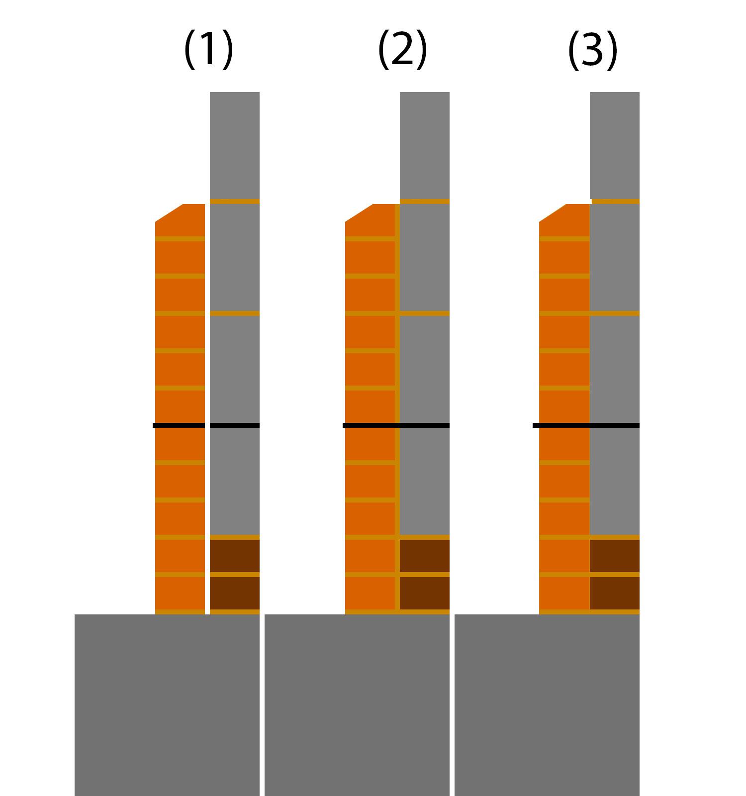

  15. @saveasteading Number (2) understood thanks. Yes it will be tied to the blockwork. There will be a bell drip from the render above to push the water outwards. Sorry do you think there will be any problem with brick efflorescence or salt petering with no air gap behind the bricks? I heard someone say this and just wanted to ask someone in the know?
  16. Plinth was designed at the start of the project together with half brick cill and soldier courses to windows, is just visual, nice bricks, non-load-bearing.
  17. I'm building a brick plinth to the front elevation on our new build. DPC, wall ties, foundation is all prepared. My question is: 1 - should there be a small air gap between the brick plinth and the blockwork? 2 - should mortar be applied between the brick plinth and the blockwork? 3 - should the bricks simply butt up against the blockwork? See image below to help. I understand the top edge will need to be filled to stop water getting between the brick plinth and blockwork. Thanks very much.

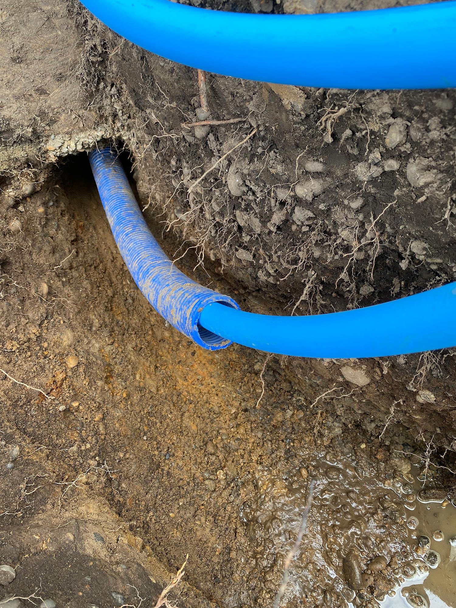

  19. May I jump in and ask what's best to seal the end of the flexiduct/pipe after inserting the insulation? My supplier say to "seal the ducting with a non-petroleum-based product". Should I be using CT1 or expanding foam filler? Any links to specific product to buy would be very helpful thanks.
