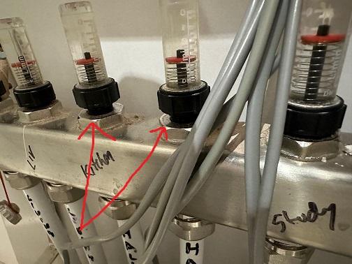

  7. trying to increase the heat in the two flow meters with the red arrow. 3l/m looks to be the max i can get it too with most of the other loops having a max range all the way to 5
  8. Thanks for the replies - that makes sense. Trying to increase the floor temperature in that room as its a few degs lower compared with the other loops. The pipe lengths are unknown to me unfortunantly and its the furthest room from the manifold/pump. I'll have to see what can be done with the pump speed. Thinking about it backwards; In terms of efficency with a heatpump & buffer - Would it ever make sense to match the other loops to the worst performing loop? I.e adjust the other loops to give the same surface temps as the coldest floor surface making everything the same.
  9. Hi All, I've always struggled to set the flow on the above flowmeters. I've only just noticed that they sit alot higher than the others on the black plastic threaded part. Is this why i can't increase the flow? How do i fix this? How would i know the type to replace if i need to get another one Thanks
