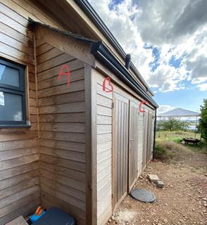

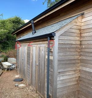

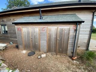

B & D it is then. Hardest option to connect up, but I should be used to that by now! Might as well do it properly ;) Thanks for the advice. -
Getting towards the end of my build... the time has come to buy the MVHR unit and install. Think I’m going for the vent-axia sentinel sx from BPC, although they look to be suffering post lockdown stock availability at the moment... Anyone actually got one in operation? My dilemma is where to place the inlet and outlet. The unit is going into the external plant room on the side of the property, on the inside adjacent to A and B. The prevailing wind is from the South West (where the gazebo is), the obvious and easiest is to put the extract at point A and the inlet at point B. But I have read that if they are not on the same elevation an imbalance can occur, or is that more the case of being on opposite sides of the house, rather than a plant room? Otherwise I could put extract at B and inlet at C ( or even D if a 2 meter distance between is too close and 4m would be better). The plant room is 4.6m long and 1m deep. Advice much appreciated!
