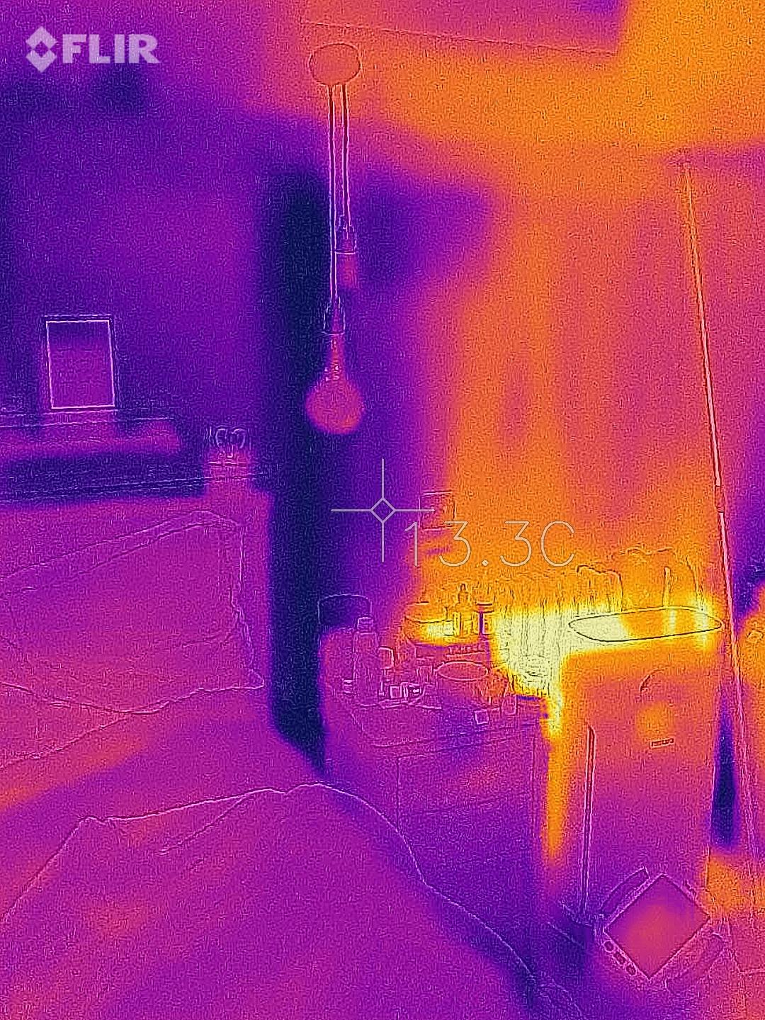

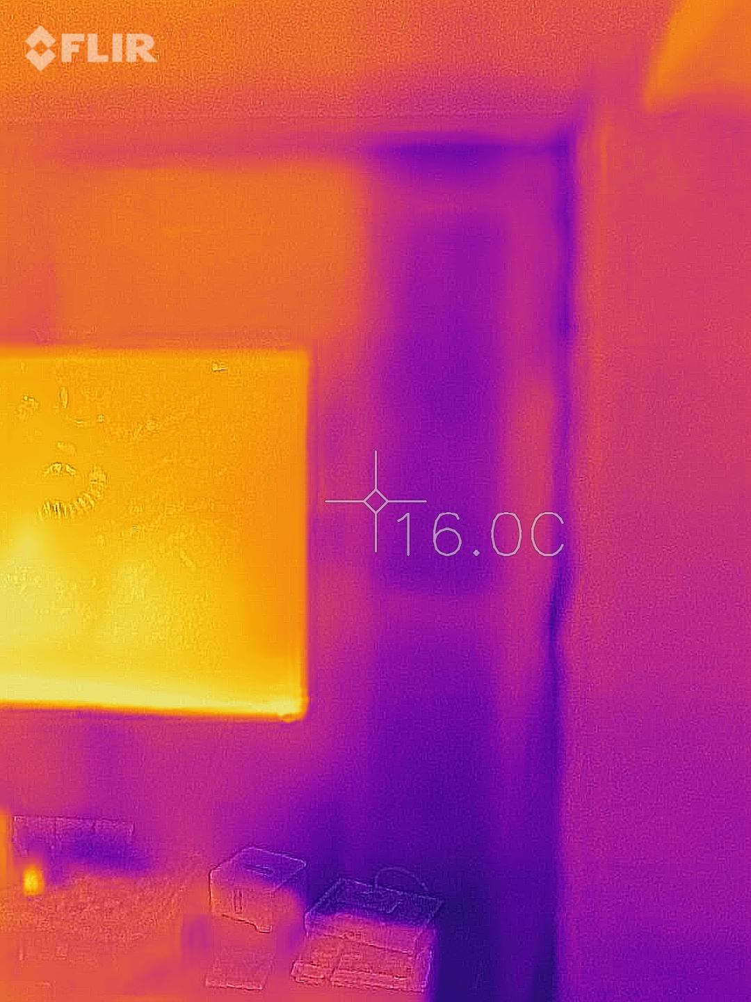

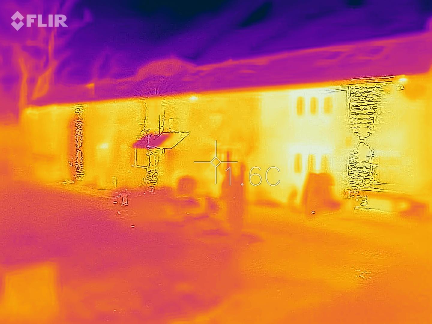

Thanks, very wise words! I’m sure all our gutters and drains are OK as we had them all fixed. Funny story... we found them all draining into an old water pit under the house. Which was obviously now leaking so all the rainwater was just soaking the ground. So had it have it all dug out and drained properly. Anyway, that’s the other end of the house so doesn’t affect this room anyway but strange what you find! We do have some flower beds against the walls so I’ve started digging a french drain between the house the soil to lower the levels. On one side we have a cobbled courtyard which is about 6” to high so will do the same there too but that requires a bit more than a spade so will have to wait until summer. I think in general our water table is quite high as we live on the bottom of a hill. Thanks fully very good working field drains which all head off away from us but any opportunity I get I add more acodrains to ensure any surface water is intercepted. The reason for looking at insulation is I did a thermal camera survey and from outside you see this section of the house is noticeably warmer externally (right 1/3 of pic attached). There’s also sections internally where you can see insulation is missing (see other pic, beside the bed)
Thanks @Iceverge. Will check those links out. Currently, from what we can tell it’s stone exterior with a cavity and brick interior. Then there’s 50mm of kingspan between studs and drywall over that. The issue is the kingspan has been added badly with no foam to seal it so there’s big chunks you can move about, so very poor fitting. It’s a pitched ceiling with, again, 50mm of badly fitted kingspan. Elsewhere in the house it’s the same structure but instead of the kingspan there’s 50mm of XPS backed plasterboard and it’s soo much better. The ceiling has had another 50mm of well fitted kingspan and that seems to be working nicely So I’m think long something like: Remove kingspan, replace with 75mm and foam in place. Add 25mm insulation backed plasterboard on top of stud frame. or Remove kingspan and use sheepswool, then 25mm insulated plasterboard on top. But what I’m not sure of is what depth I can go to without causing issues with interstitial condensation etc. I’ve had issues with mould in previous houses and really don’t want to go there again our internal humidity can get to 70% in the summer so I was thinking using sheepswool might be better to allow it to breathe more, but again no idea how that works with the moisture risk etc.
Hi all We have an old period house c1750s. It’s been Renovated approx 15 years ago and it generally v good condition. Approx 250sqm and long and thin so most rooms have 2-3 external walls. We have realised that 1/3 of the house, which is our lounge and master bedroom has been insulated differently (kingspan behind dry lining rather than XPS backed plasterboard elsewhere). I think due to how that’s been done (it with big gaps!) these two rooms tend to take much longer to heat up and therefore cost more to keep cosy. I’ve done some work with a thermal camera which verifies our thoughts. We’d like a plan for improving the improving the wall and ceiling (master bed is in the eaves) insulation but I’m very aware that just whacking a load of kingspan in could lead to humidity issues in the house or interstitial consensation etc. Having a healthy interior is very important to us. I don’t trust getting this advice from a builder so would like the opinion of someone independent who can do the calculations etc then we can specify this to a builder. Who are we best to approach for this advice? Thanks
