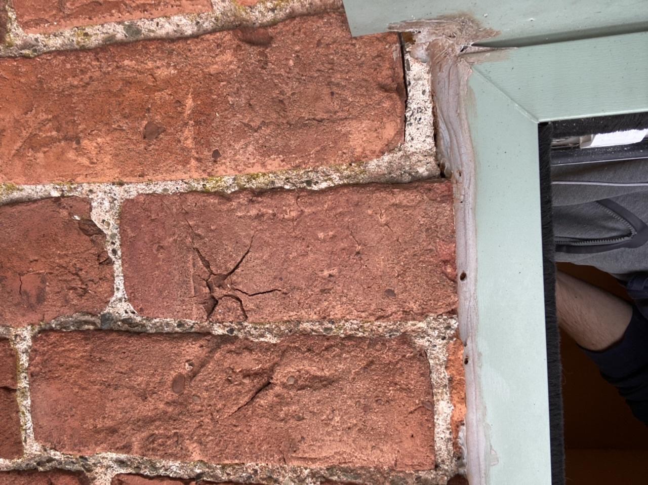

Thanks for all the feedback. This is an issue at several windows. Looks like a spring/summer job.

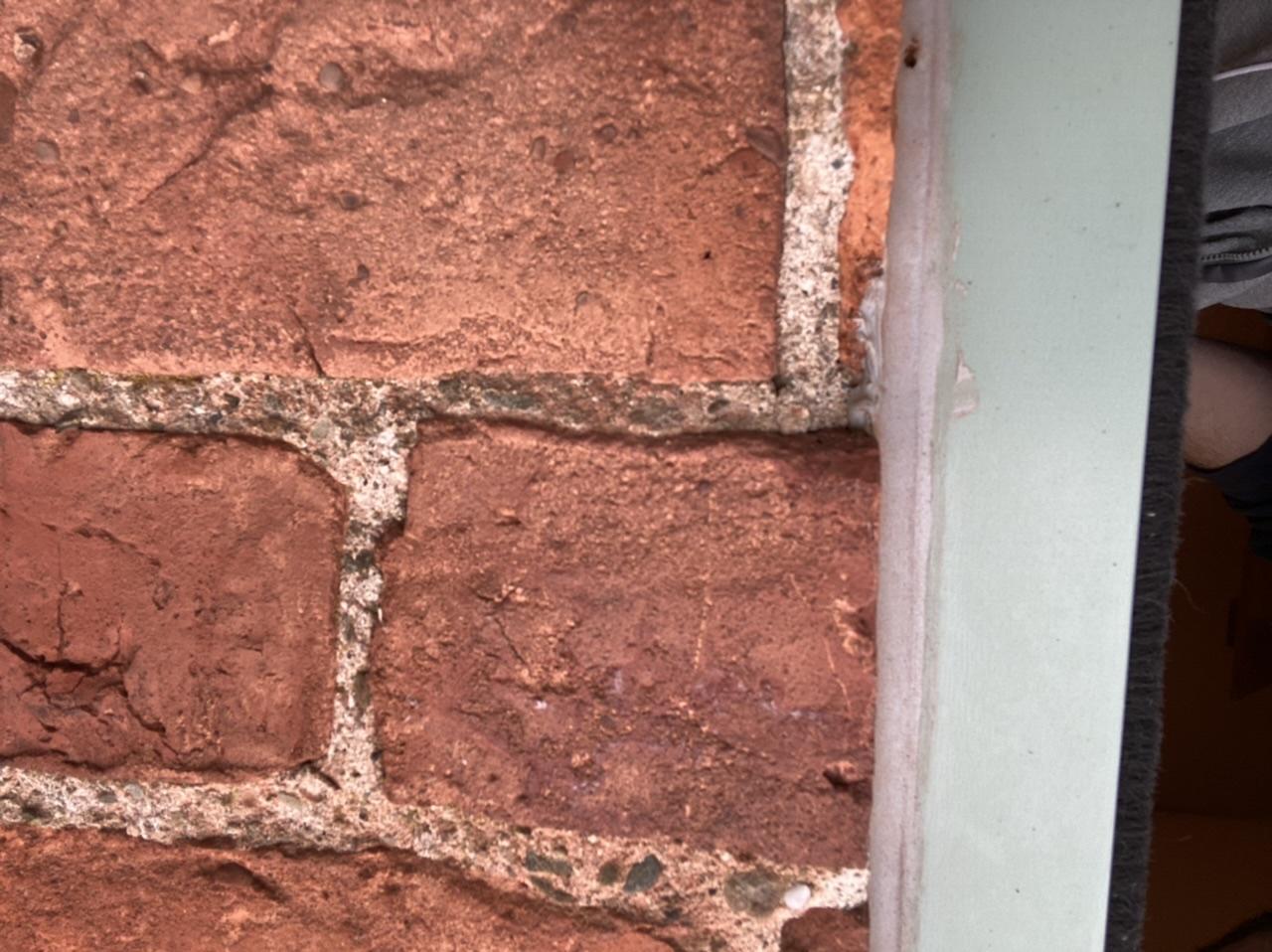

Yes, but there are also gaps in the mortar.
I know. Every thing we look at in this bloody house has an issue. It’s draining. I take it you don’t typically use sealant? Yes? No? I have no idea.
Yeah, it is but still allowing water in. How can I block it?

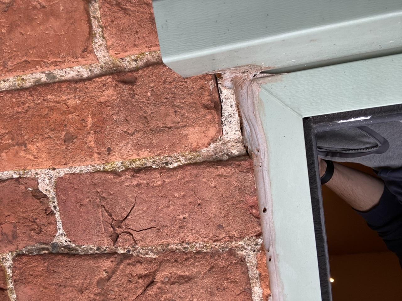

No idea why these photos are upside down when I’ve uploaded them

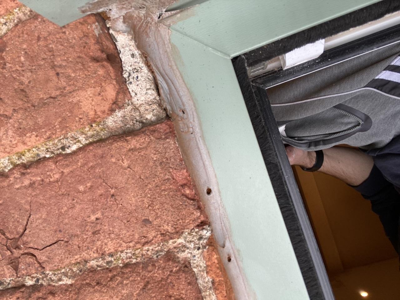

Just painting the master bathroom and got to the window and saw a few small signs of damp. I looked outside the window and have found small gaps in the mortar around the window frame. with these and storms water has obviously made its way in. is the solution remortaring in the summer or is there a chemical compound we can use?

If we were to remove the lead, what else could be used to keep the water out going forward? I guess my question is, how do professional gutters fit custom windows that don’t come with kits.

We have considered that. The other massive issue is that the existing windows are a custom, stupid size... so we can’t like for like change it. We might have to do that in the summer though... just need a fix for the next few months.
It’s getting through the top. I just took the photo from the bottom to show the mastic. Maybe it needs to be tucked in better.
We tried to see this off until the summer. Not that lucky. We’ve sprung a leak - I think the black stuff is mastic but it seems to have degraded. Does it degrade over time? Any solutions? During a dry spell, should we rip this stuff out, clean it, and replace it? If yes, what would be recommended? Mastic, silicone? Really fed up with other people’s shitty workmanship.
