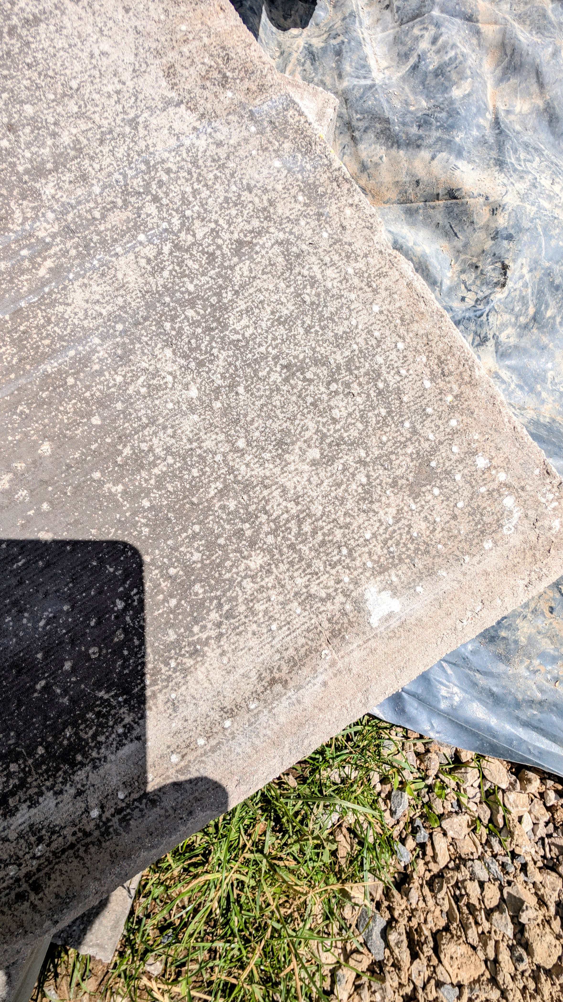

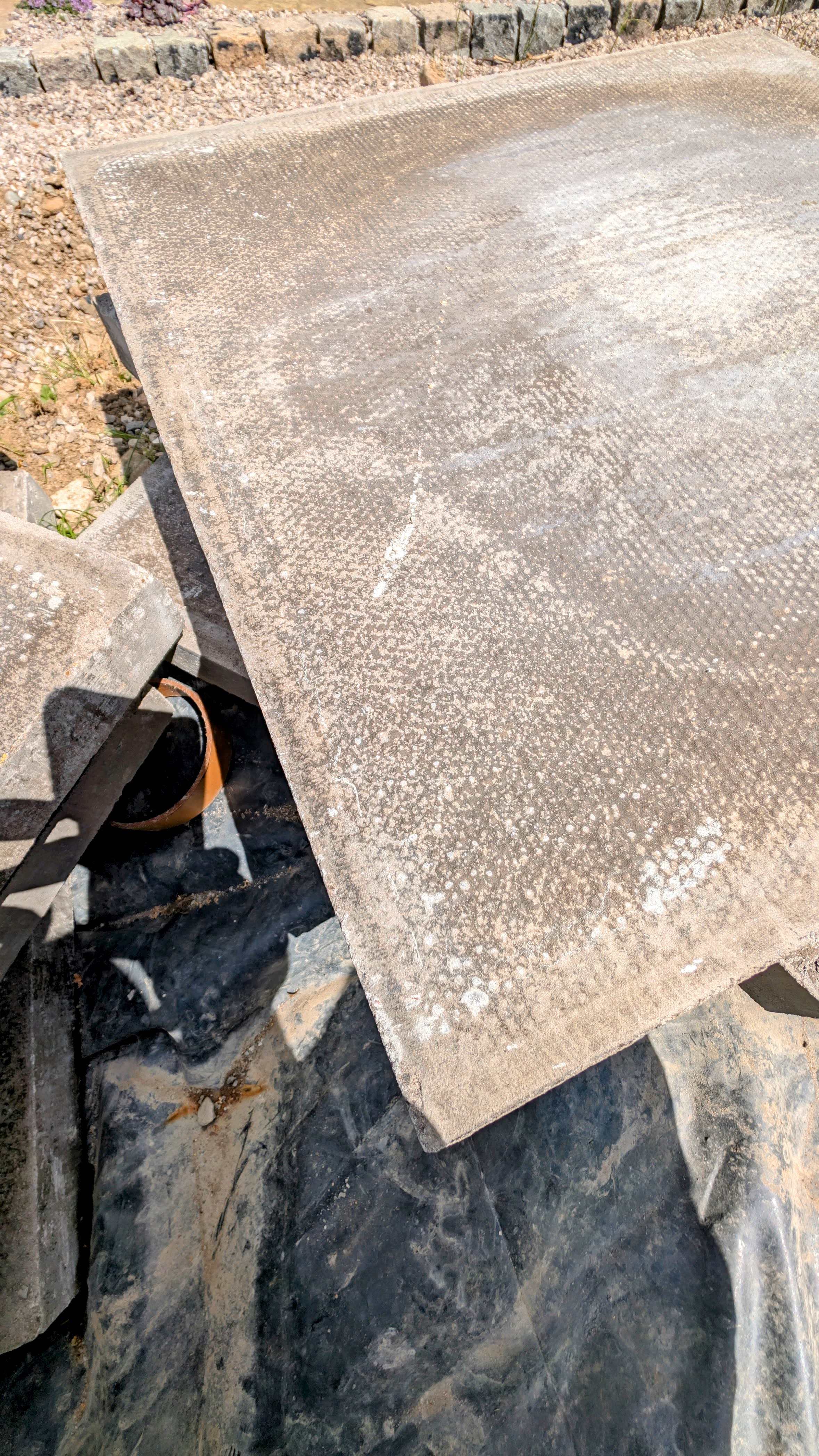

For the sake of completeness, I thought I'd list the 'issues' I came across while doing the drilling; Here's one - I used AI to see if I could find an answer to the problem ( remove the broken stone stub ) . The answers - tap, poke, fiddle didn't work. Since I don't have a pillar drill any more, this ( below ) is what I'm going to try next ( 48 holes yet to be drilled ) The aperture of this drill is a good bit bigger, and there's a slot for a screwdriver to wiggle broken bits of stone out of the core. The narrower one above has no slot. I'm thinking of using the type of core 'drill' that attaches to a grinder (threaded shank) rather than a drill chuck - because I will be able to exert more pressure. But I'll have less control perhaps (?) Anyone have any advice?

Yes. I used one of those hollow diamond-tipped drills with wax in the internal 'hollow'. I dribbled splashes of water to help form a grinding paste - interesting to watch the water on and in the surrounding stone evaporate after a few moments - cue for another splash of water. I find myself increasingly using AI to solve little problems like this. Annoyingly, I also find that AI (Gemini in this case) just plain wrong. Hence the check-question to BH. Thanks everyone for your help.
It's getting expensive now - any ideas how to do so without smashing the stone? I need to fasten some fence baseplates through capping stone ( Indian 'stone flags' 50mm 600 by 600) So far I've used a 6mm SDS with hammer action - might as well have used a pick axe used it without hammer - I want to finish the job sometime this year splashed a bit of water on the slab - better but still iffy.... Ideas please .....
