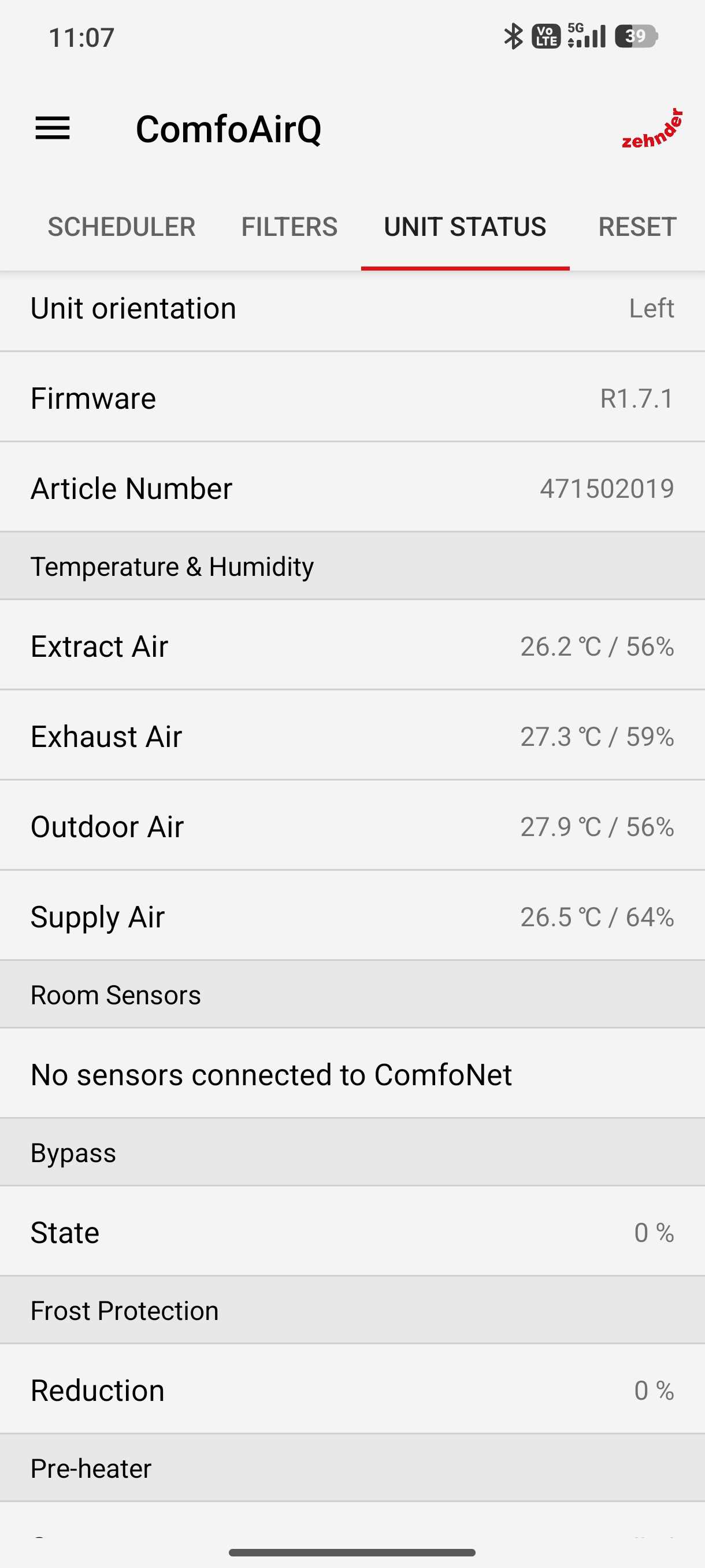

  5. The 2 sensors are about 500mm apart in the unit so it can't be house fabric. Here is my present readings and not on bypass.
  6. https://amzn.eu/d/01CXoCm6 How about this one
  7. I have the Q450 the sensors are all in the unit, 1 each side of the heat exchanger on both supply and extract. Mine is the same 100% bypass, I can't connect to mine to show the figures but was the same as yours earlier. I think it's probably the fan warming the air. The bypass takes it over the top of the heat exchanger to miss it. I think if you look this afternoon it goes into reverse and closes the bypass when outside is warmer than the house.
