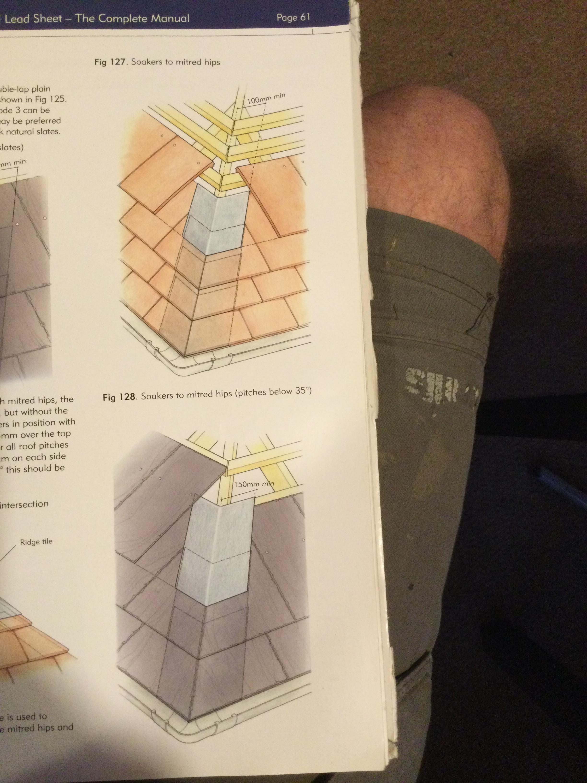

For the join on the slate hanging you could use lead soakers on every course, as per the detail in the picture below for mitred hips. For the roof/wall join have you checked out the easy trim range of products? They may have something

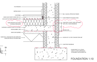

Can anyone help explain what purpose the lower DPM in this picture could have? As in the one laid on top of the footings? I can't see any benefit of it being there as it will be fully buried underground? Any thoughts appreciated.
