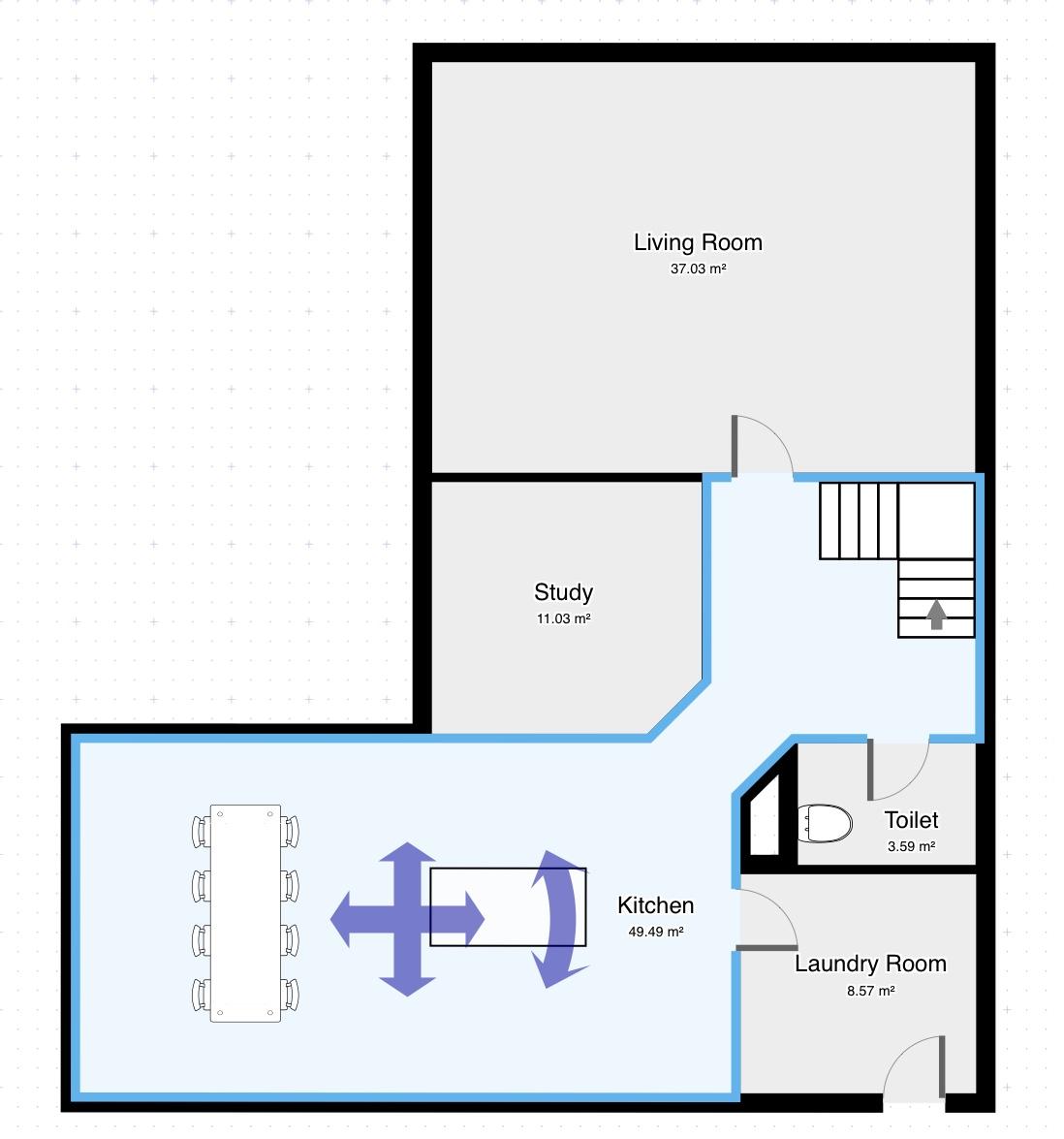

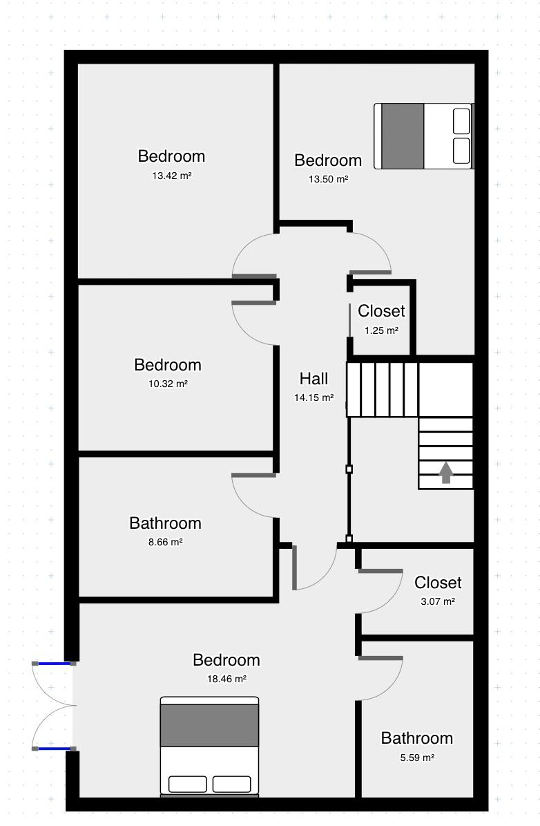

  13. Thanks for all the responses great to hear how different people approach it. We we pretty much know what we want, but would like it done quickly and don’t want to make any glaring mistakes with the design layout. I have attempted to attach attach a layout we have been playing around, pretty chide this about downstairs but not sure about the upstairs. Any thoughts would be appreciated.

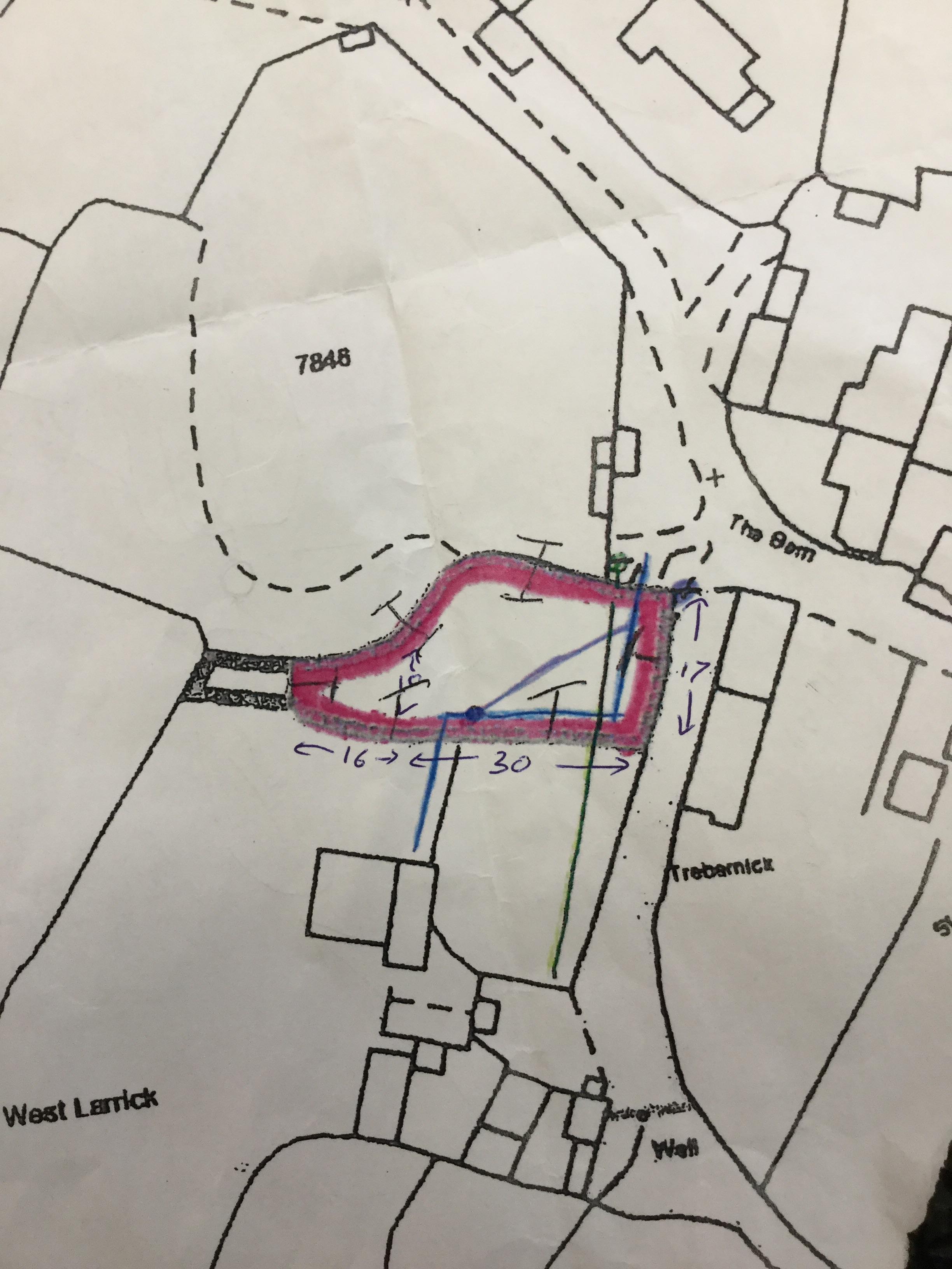

  18. Thanks, The potential issue for me is the drainage field that’s required, the main part of the plot measures 30m x 17m with a smaller piece measuring 10m by 16m. Its going to be a 4 bed house in south west England. I have attached a plot plan so hopefully this helps. Our plot will be the area outlined. House location likely to be in the top right hand corner.
  19. Hi, We are currently in the process of buying a building plot (after a lot of searching). The plot measures approx 750sq metres, is there enough space on this to fit a sewage treatment plant and soakaways in? On initial inspection I didn’t even consider that we wouldn’t have the space, until the solicitor sent a note to us suggesting we check that we have the space as we have no rights to drainage of neighbouring land. Am am I right in thinking treatment plants/soakaways should be 6m from a property and 3m from a boundary? Thanks all
