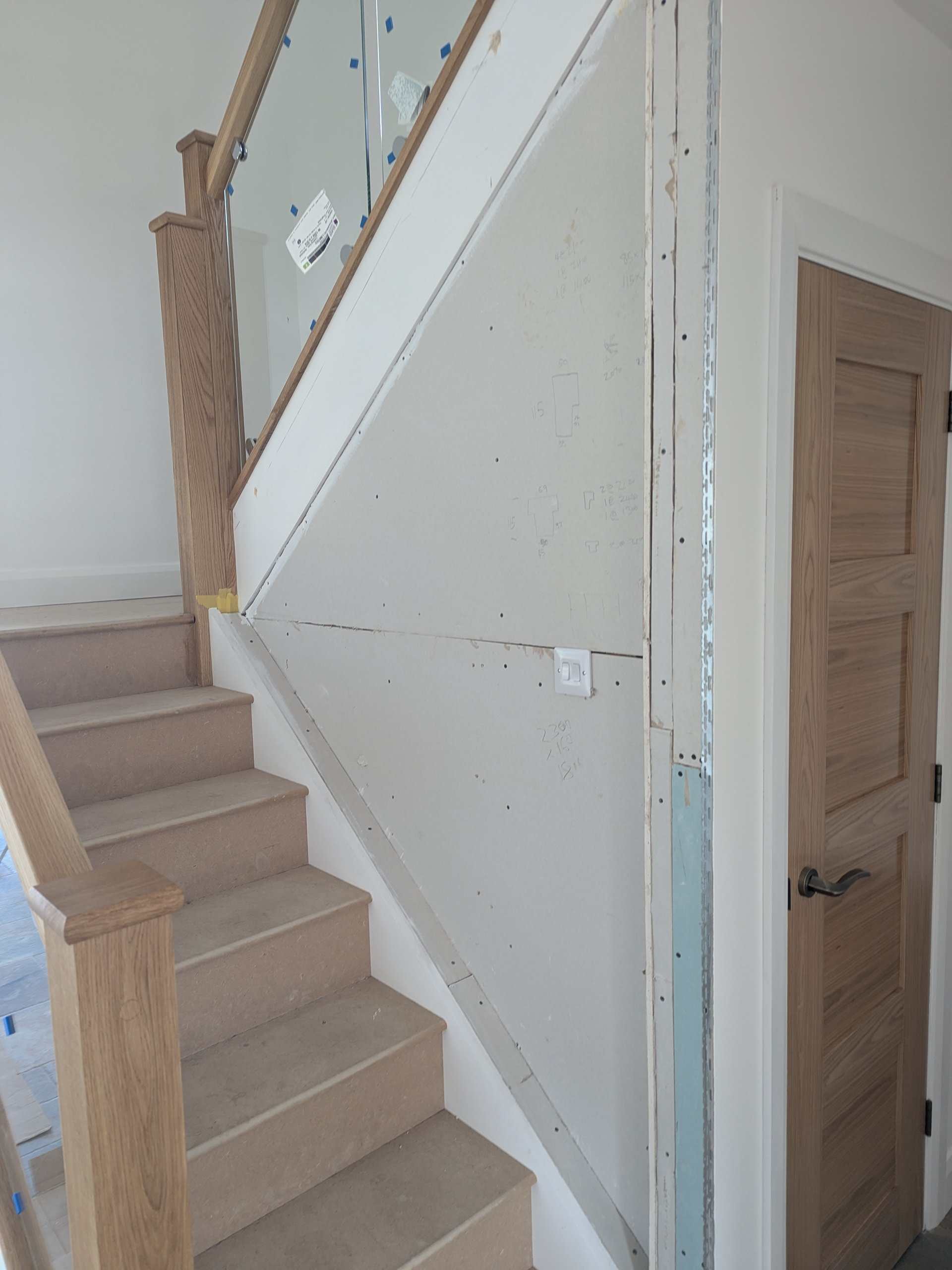

  3. Hi folks As we creep towards the end of the build I'm starting to think about how I can keep plaster off the oak stair parts. I have been told by several people that a splash of plaster on oak can turn it black. I have coated the oak elements with three coats of Osmo which I am hoping to help and then I will use delicate surface frog tape and some plastic sheeting to try and cover every part of the oak. Is there anything else I should be doing? Thanks

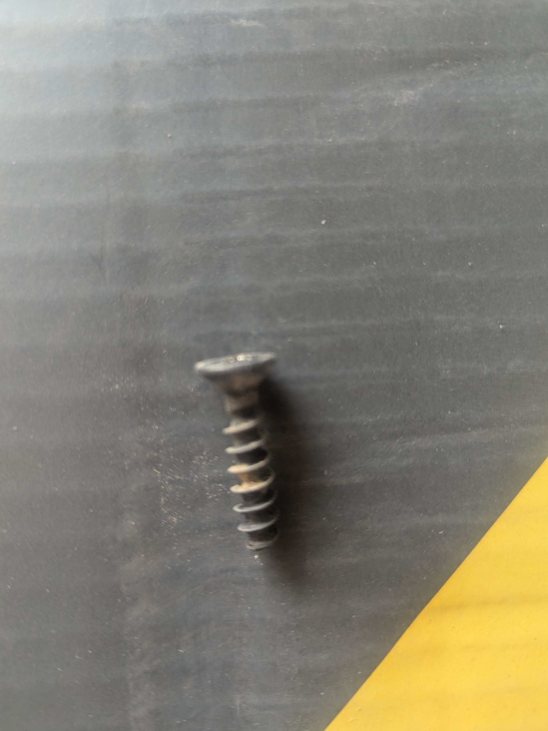

  6. Hiya I have quiet a few Wavin inspection chamber cover screws which are damaged. Does anyone know where I can get some replacements. Groundworkers long gone. Thanks

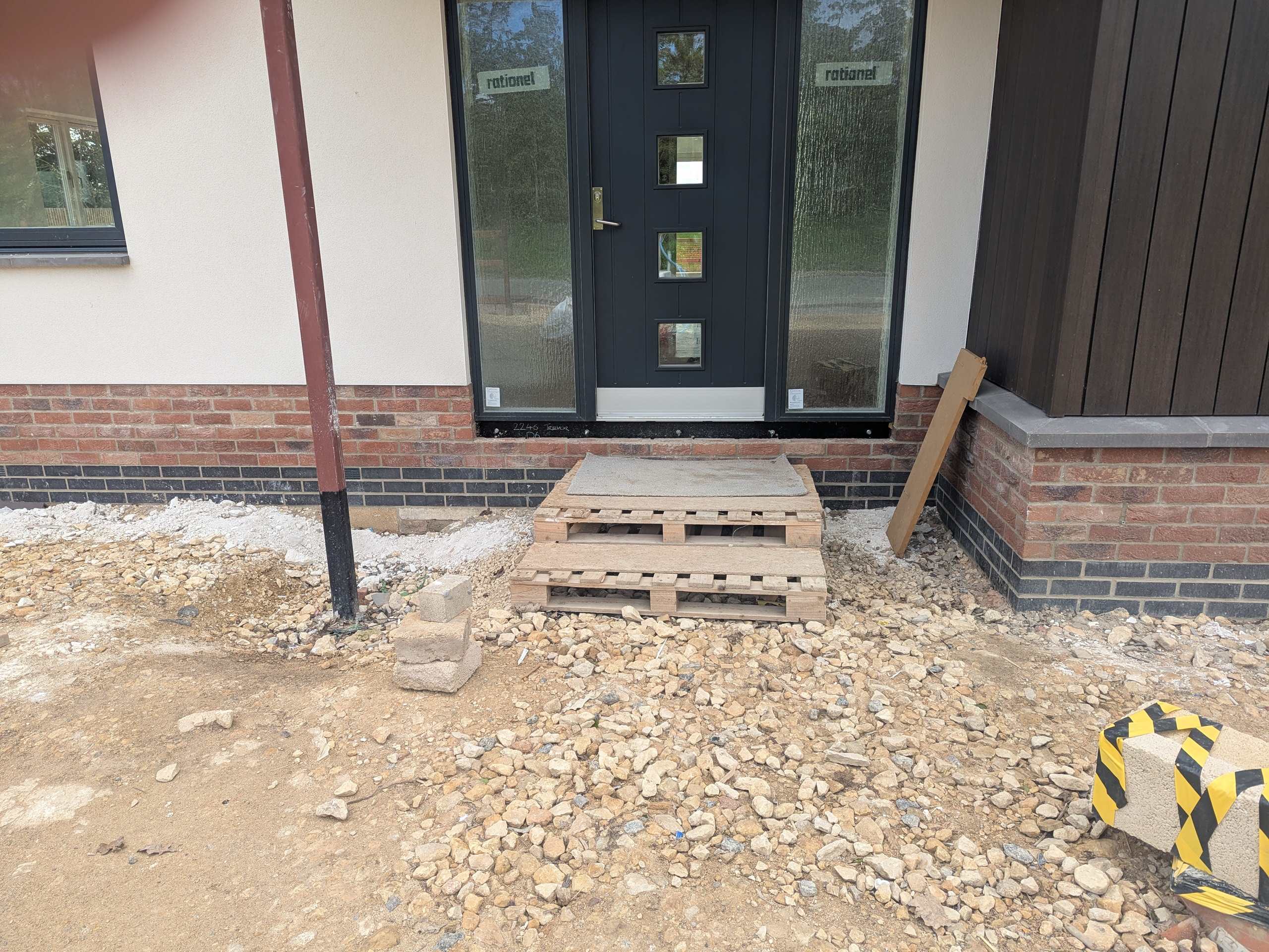

  10. The threshold is more than 15mm at the back, so, unfortunately this isn't an option.

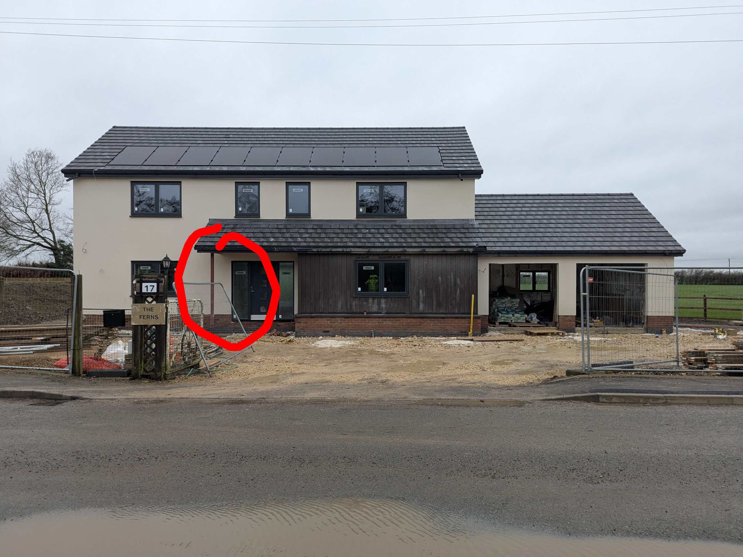

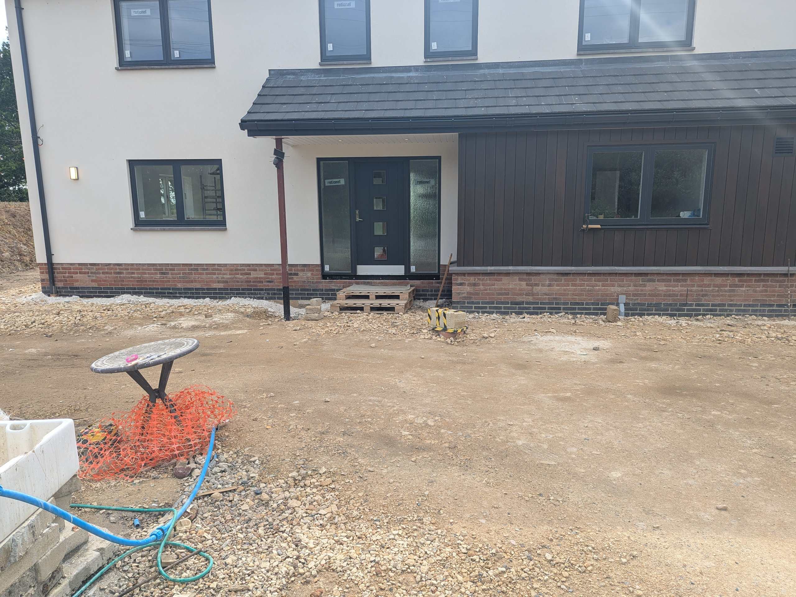

  11. Hi folks We are nearly finished - hooray! We have a conundrum with level access to the house. The difference in height from the edge of the door to 15cm below the vent is 40cm, this means we need a 4.8m long access ramp to get into the house. This has the potential to look rubbish! The front door is 8m from the road. Any ideas how I could make this look nice? Thanks

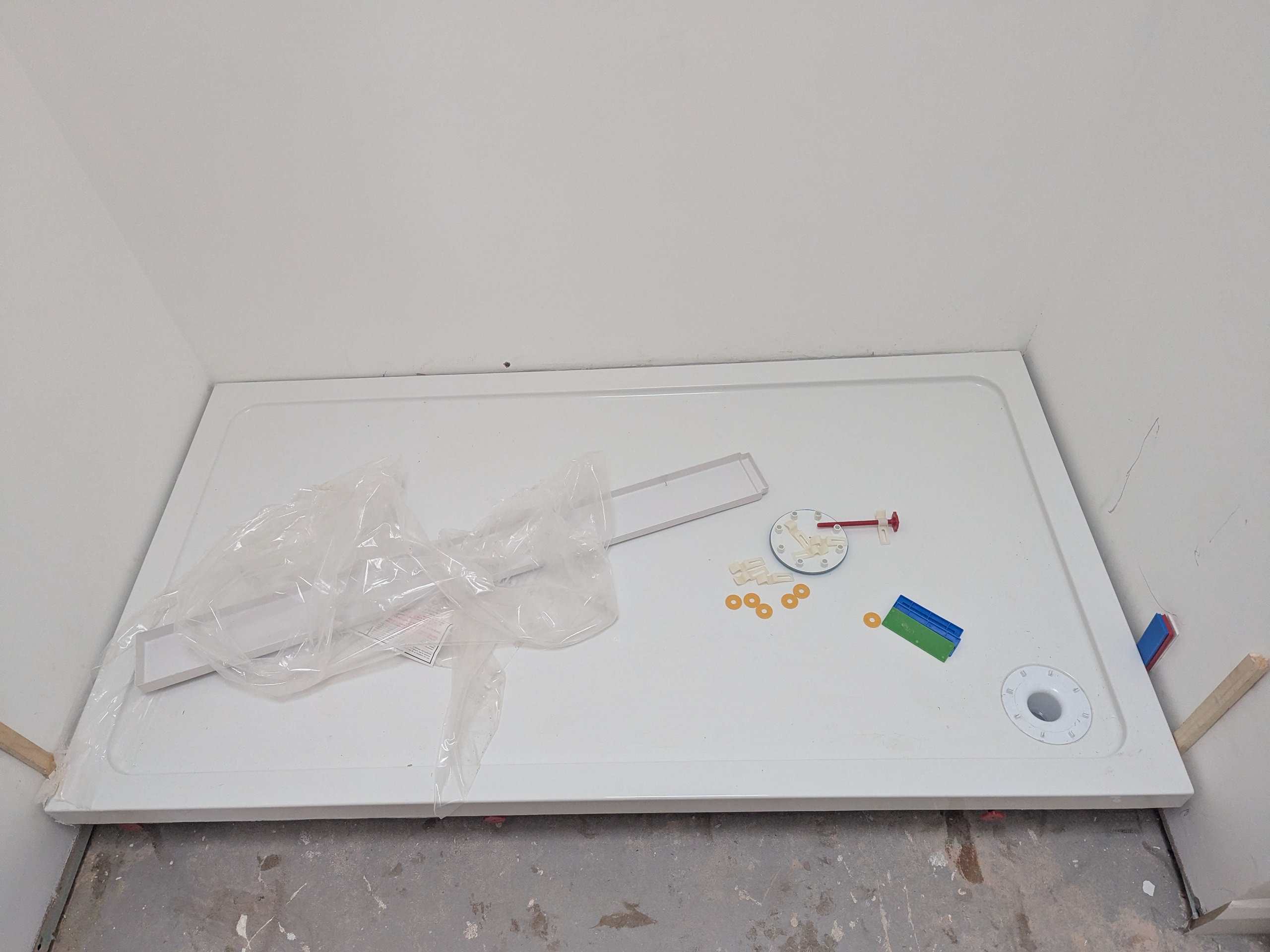

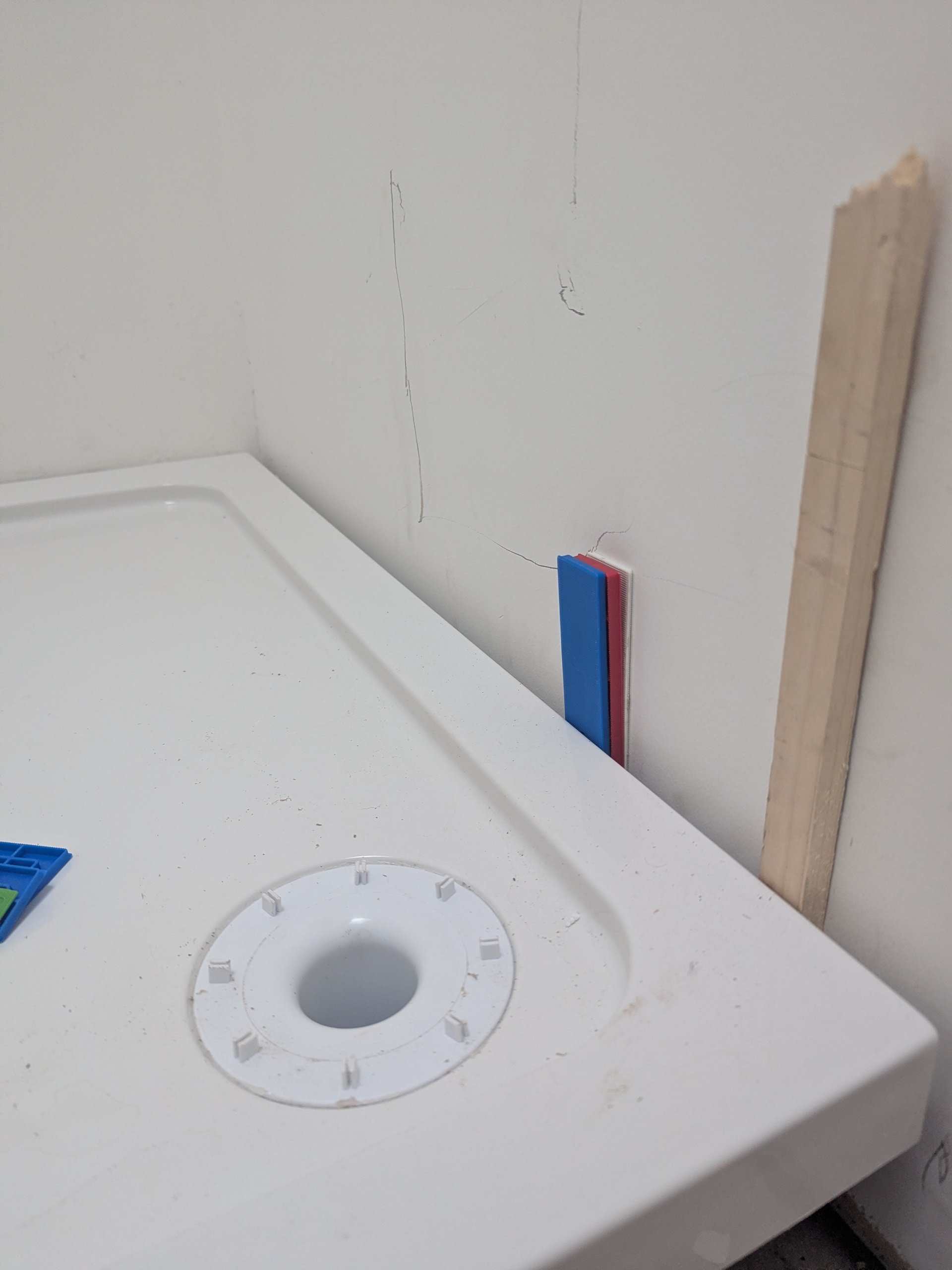

  12. Thanks for the tip. This may be the way I need to go. How could I finish the raw hardibacker edge? The tile + adhesive could be covered by edging trim, but what could I do about the hardibacker edge between the tile edging trim and the plastered wall? Thanks
  13. It doesn't need skimming, I am trying to find an alternative way to build the wall out and still have a good seal between the tiles and shower tray.

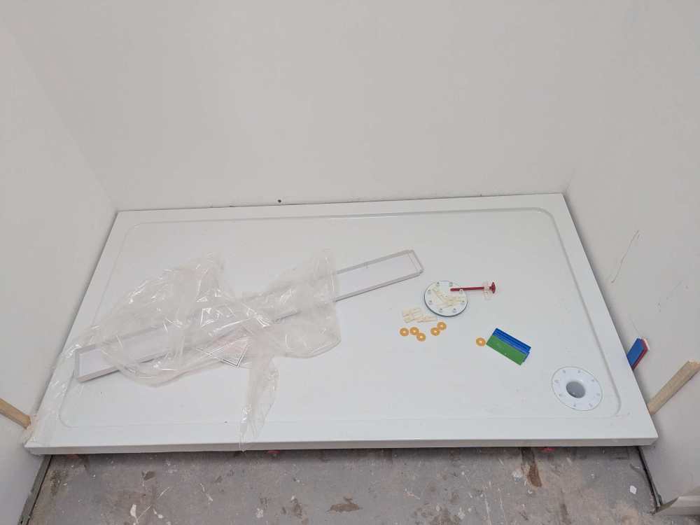

  14. Hi folks The shower tray has been fitted and I have a 12mm gap between the edge of the shower tray and the plastered wall. My wall tiles are 8mm thick and I'm guessing the adhesive will be around 2mm. I obviously would like the tiles to overhang the shower tray to give a good waterproof seal. How could I bridge the 2/3mm gap needed without reskimming the wall. Many thanks

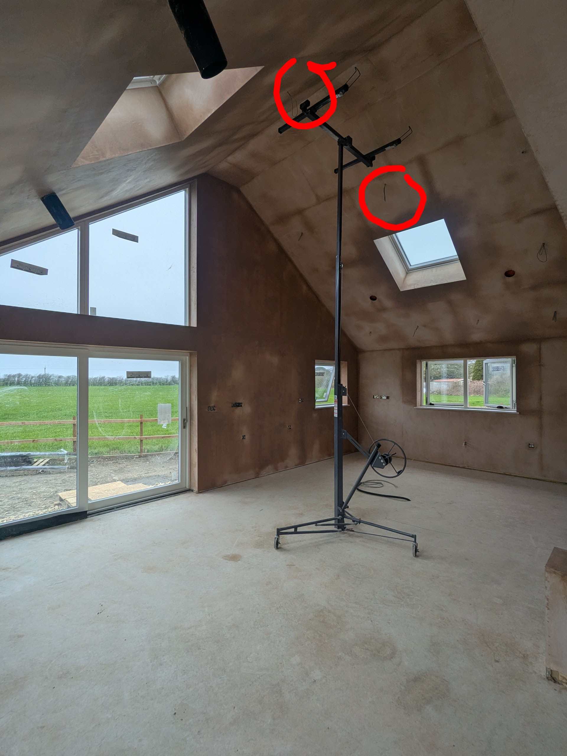

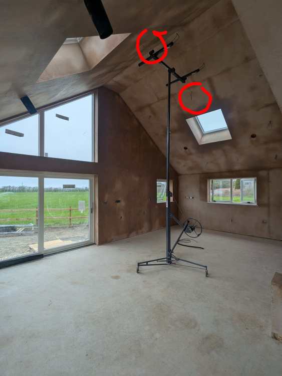

  19. It's just occurred to us that we are going to need flippin' long light cables for our kitchen/dining area! The kitchen has been painted and the kitchen is almost installed, but I am not on site whilst posting this so I used the picture I used to sell the plasterboard lifter! The drop from where we have the lighting cable to a "normal" light height over the kitchen and dining table is 2.6m. A vaulted ceiling seemed like a good idea, but I didn't think about the super-long drop from the cable to where we expected the light to be and the affect on positioning of the Velux windows! Any ideas please 😊
