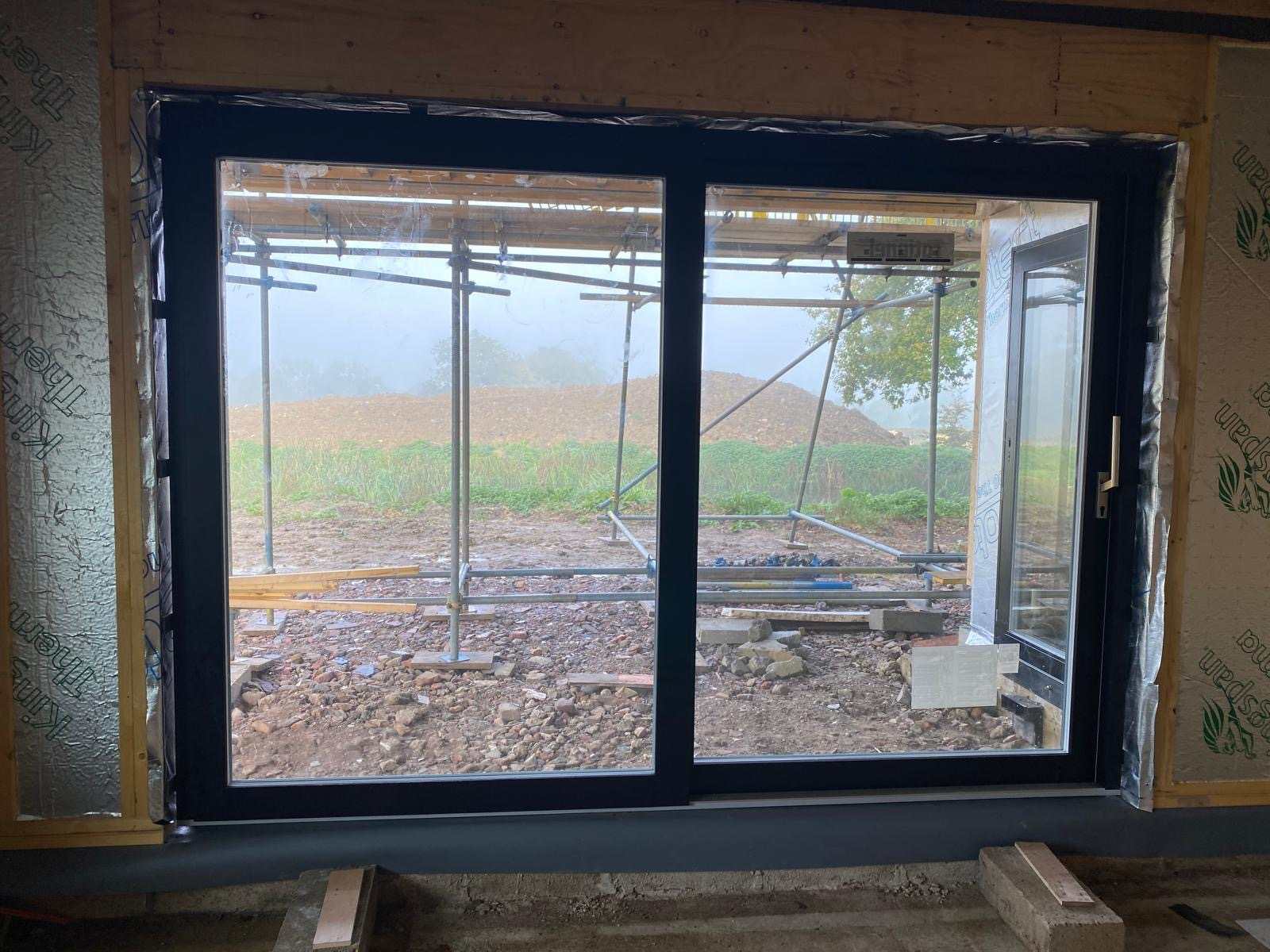

We went with Rationel Aluclad windows and doors. We like the chunky frames but I know others might prefer as thin a frame as possible. Only thing we were dissatisfied with was the packing protection - no film on either the aluminium or the wood so very challenging to handle when fitting. But I’m not sure if any other companies protect them either, maybe they’re all like that?
