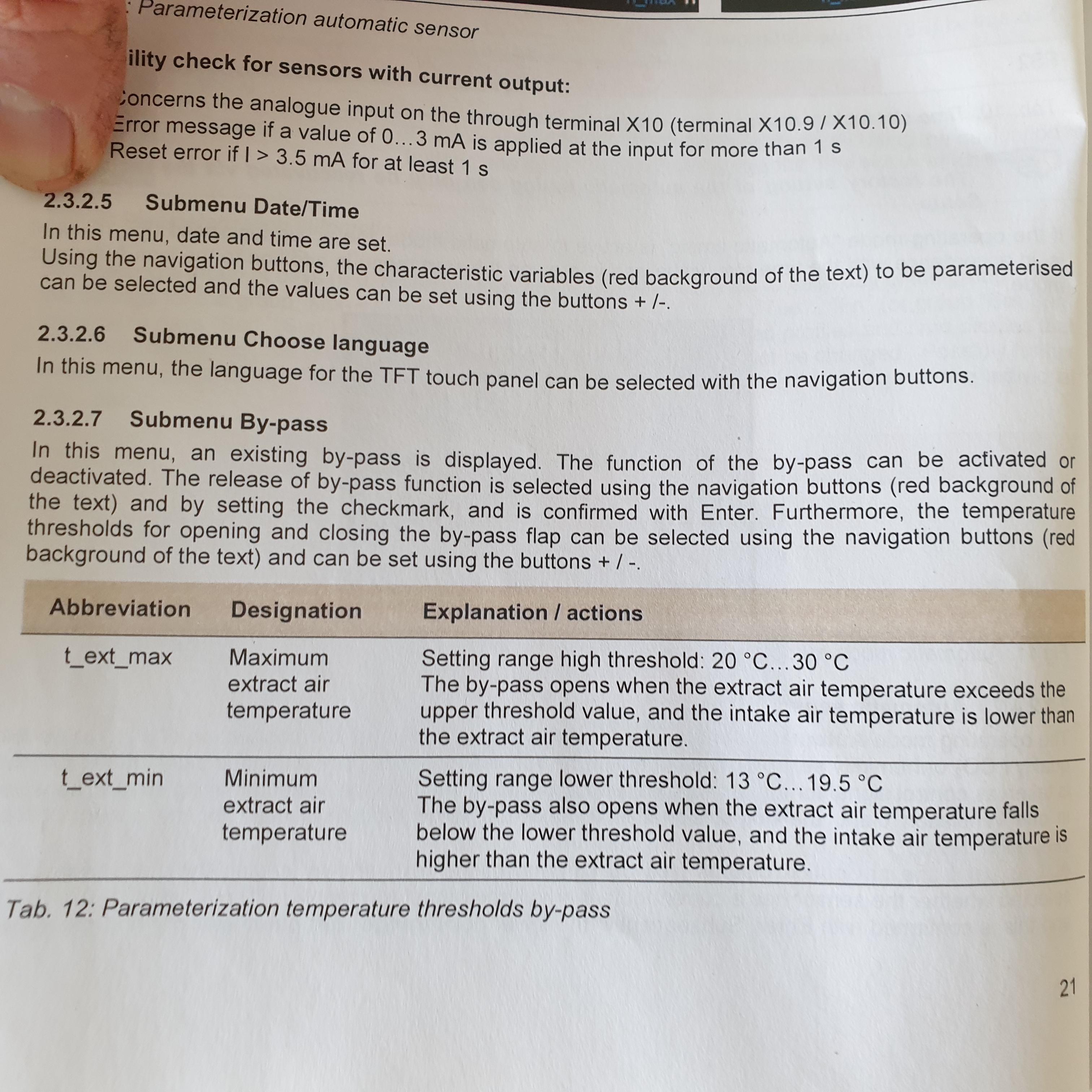

Hi, just wanted to check I have the Summer Bypass function right. The attached extract from the manual shows a "Maximum" and a "Minimum" extract air temperature setting. My reading of this is, if I want to maintain the highest level of cooling (minimum level of heat re-cycling) in order to keep the house as cool as possible in summer I would set the "Maximum" its lowest settings (20C ). Then, whenever the extract air temperature exceeds 20C the bypass will be activated provided the outside air temperature is lower than the extract air temperature. Have I got this right? As for the "Minimum" setting, I assume this is less significant as the indoor temperature will never drop below 19.5C in summer but setting it at 19.5C would give the best opportunity for cooling..... Thanks. David
