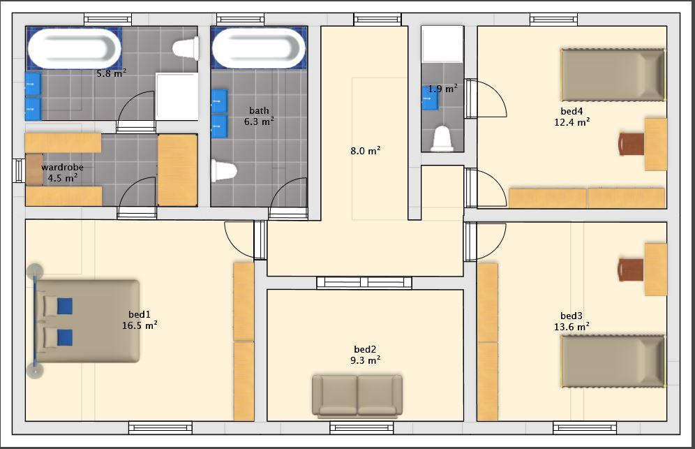

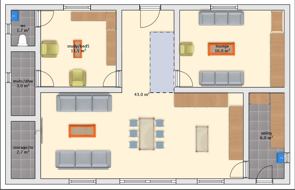

  18. Hi All, I really appreciate all your inputs and really thankful to everyone.. Basically I am going for passive solar gain having large windows on South and minimal glazing on North. I had some windows on East because it has got nice big garden and wood land views towards South East One of the reasons we have chosen Passive house because We have a noisy road on north boundary 100 meters away and looking healthy, comfortable environment Could you please provide any tips on how to avoid summer over heating either using overhangs on South glazing and shutters on east side windows in Ground floor Open plan living 2 windows 4m*2m I am going for standard size windows on First Floor unlike Ground Floor Looking MVHR design tips issues as well, like best place to have ducting and any noise issues Reducing noise issues with en suite bathrooms I have tall thirsty row of Poplars on South boundary of around 14 meters away from House foot print and being in clay soil, Foundations is going to be a big challenge. Just checking about Raft, Screw Piles or Helical Piles or Basement which ever is cheapest. Is it better to engage Structural Engineer and Building Regs Inspector now or is it ok to wait till we get planning for approved layout plans. I am definitely going for TF supplier, I think they provide SE calculations for Foundations and Shell house, any advice appreciated I am planning to dwell into sections, elevations and aesthetics once floor plans finalized.

  21. Hi All, I really appreciated your feedback and was really helpful. Please find the updated plans with room measurements. Views and Garden are towards South east so windows orientated mainly south and SouthEast. I am going for near passive house due to some personal circumstances. any help with passive house principles will be helpful like summer over heating. I will be project managing myself using mostly subbies by using TF supplier for main shell erection. To be honest I am on modest budget not like grand designs. Just need a well designed home with fabric first approach and to reduce my mortgage payments. any further feedback really appreciated.
  22. Hi, We are planning Passive house standard but not going for certification. Site is south orientated with tall trees of 20 meters around 16 meters from South boundary. I have made some DIY house plans using My Home 3D pro. Please advice if any changes required as I am applying for detailed planning soon. This is my first self build and planning for Timberframe supplier for a speedy build. House Gross Area 13m*10m and Garage being 7m*6m. Feel free to express yourself either good or bad, I don't mind to be honest
  23. Hi All, Thanks for your valuable comments. I will leave technical details to Architect. I am just looking for a functional point of view that meets my brief and requirements with a modest budget. with regards to storage, I am planning to have storage on attic space Please let me know if this layout has got any problems
