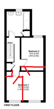

  10. All in all a good result then with aerobarrier. When I first read your post with results I thought 'not great, not terrible' but given where you started 1.4 is a good result.

  15. I'm not convinced this would be a big deal (at least compared to moving the bathroom to the ground floor). It's not like there is a heavy brick wall above to support. We don't know how the roof is built, if it is relying on the wall then the property is <4.5m wide so a chunky bit of wood covering the distance between the two exterior walls should be able to take the load (with the right engineering). An additional expansion to my option is to move the bathroom into the small room in the front. This is a much bigger job (if it's economically feasible at all) but results in a bathroom upstairs and 3 double rooms. It's a balance, at some point it's just better all round to find a new more suitable property rather than plowing money into the current one (that you won't get back when you sell). A simpler, cheaper, scheme now that either improves or doesn't damage the value of the property but that only buys you a few years before the kids grow and you need to move might be the better option than a scheme that creates the space you want but costs more to do than you will ever get back when you sell. My brother finished a major extension to his 'forever' home a couple of years ago. He spent far more than he could ever get back from the sale price but it didn't matter because he wasn't planning to move any time soon. Well guess what? Events have conspired to mean he is now moving. In his case, the extension while very costly adds curb appeal (in a way that moving the bathroom downstairs doesn't) and his situation means the excess cost isn't such a big deal but it just goes to show situations can change faster than you think and it's well worth trying to preserve options where you can.

  18. Just another idea: Personally, I wouldn't buy a property that didn't have a full bathroom on the same floor as the main bedrooms. I suspect plenty of other buyers are in the same boat so moving the bathroom downstairs may affect future saleabilty/price. I think the above fits space wise with 2 x double bed and 1x single/(or double bunk). Making this change doesn't require touching plumbing and so should be much much cheaper (it's possible this was the original layout when the property was built).
