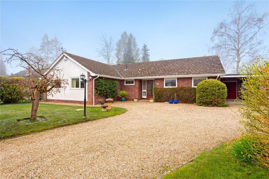

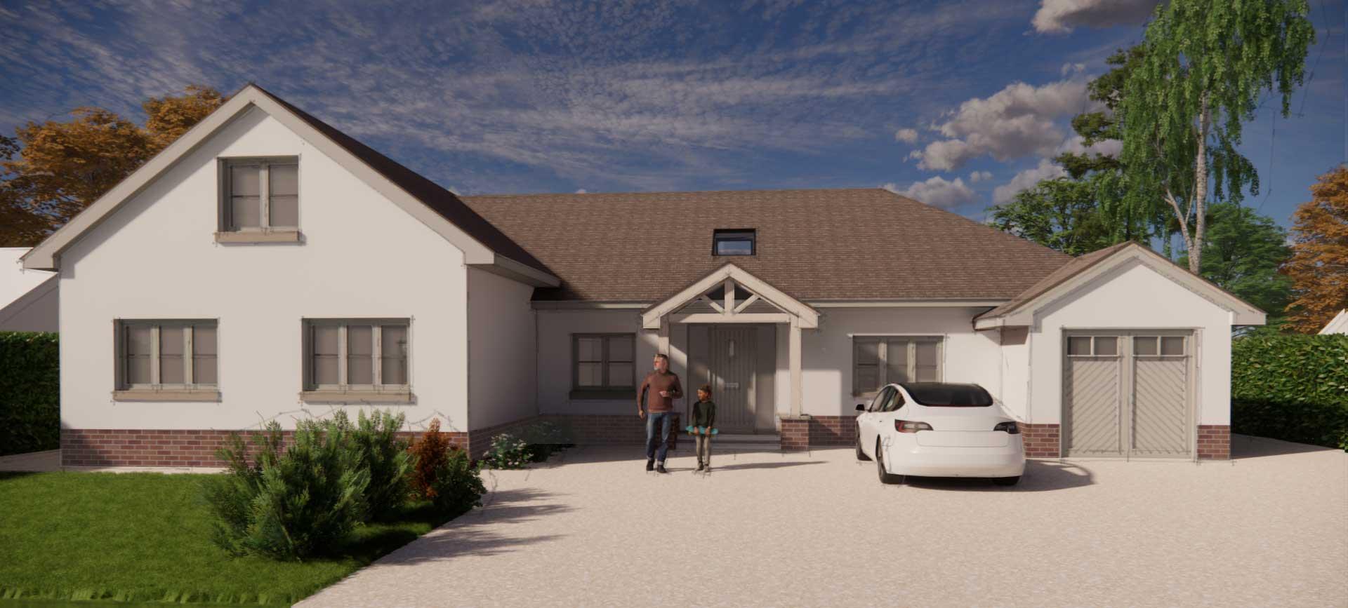

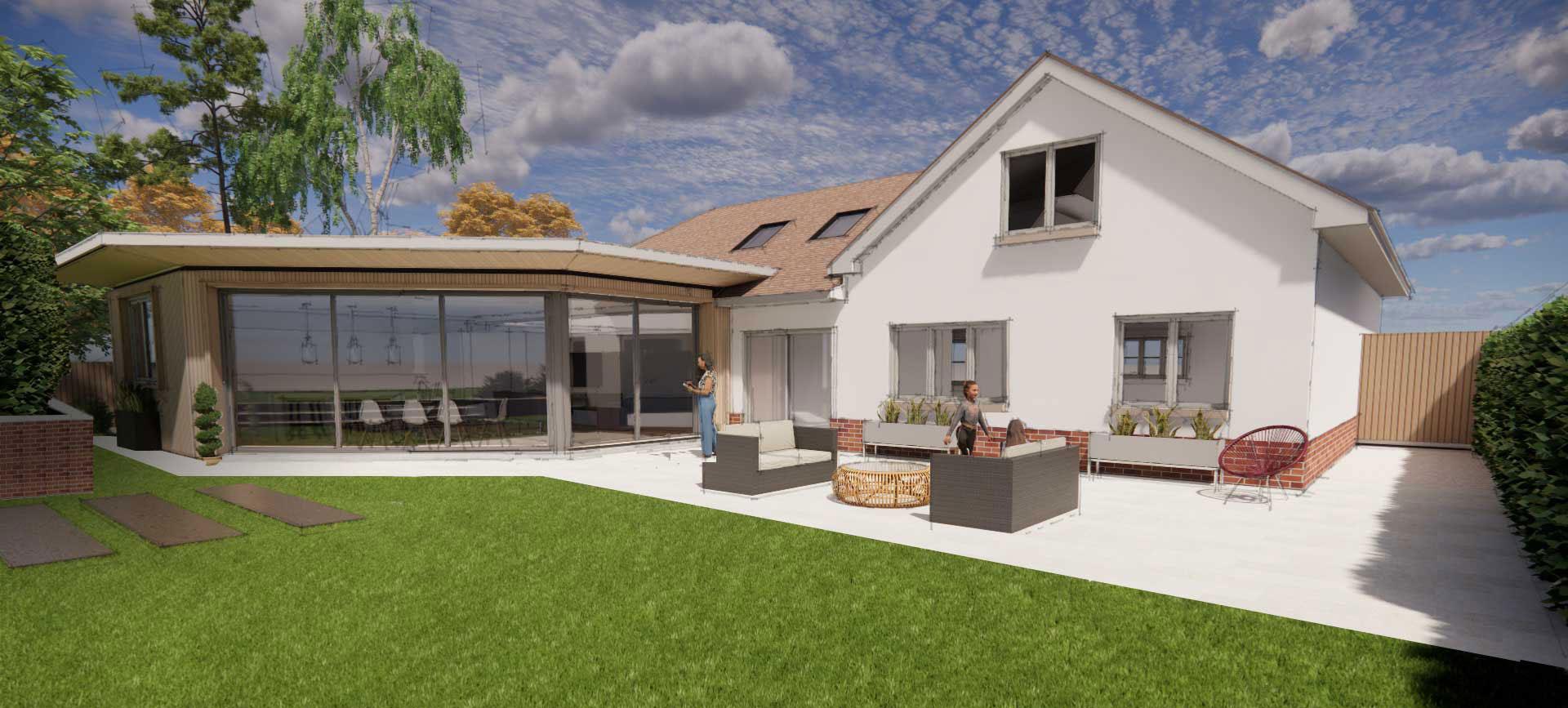

  9. Would love to hear some more thoughts on this. We are really struggling to make a decision and are perhaps leaning towards doing nothing at all.

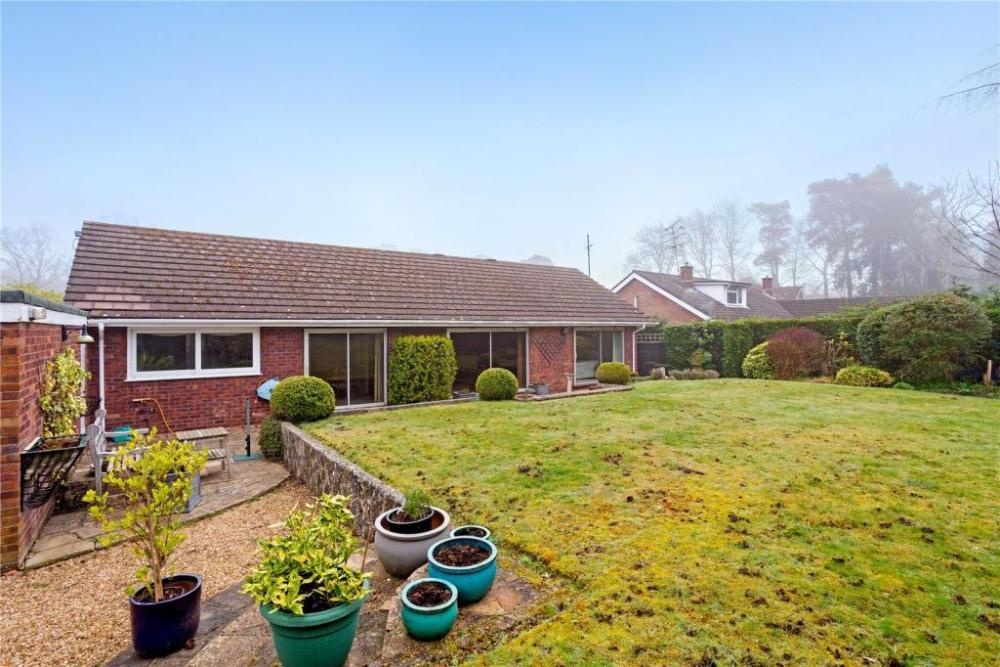

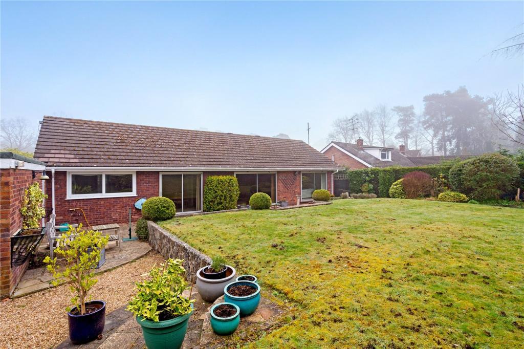

  11. We're about to embark on a significant renovation of our 1970's bungalow and are considering options for improving the insulation of the existing exterior walls that will ultimately make up about 50% of the final external walls. The existing walls are 115mm facing brick, 50mm cavity, 100m block. The cavity was filled with "Megafoam" (Urea formaldehyde) in 1977 but I suspect that's largely useless now due to age and ideally needs removing, although I've not yet had a survey in that regard. We will be... - replacing the entire roof (giving us access to top of the cavity) - replacing all windows and services (so an expansion of the exterior wouldn't be a problem, were we to install EWI) - rendering practically the whole facade (so no concerns about retaining existing brick) We're not looking specifically to achieve eco or passive haus standards. The new walls and new roof will be built to latest regs only (walls will be typical brick and block to match existing unless someone is able to convince us and the builder of something better) Presumably we would ideally bring the existing walls to regs standards to match the new walls, otherwise heat is going to leak out of the poorer half of the exterior? Is my thinking correct here? Originally we were thinking of just replacing the CWI, this is obviously an affordable approach but I doubt this will cut it. IWI is a possibility but we'd rather not lose any floor space. So I suspect EWI is the way to go but I'm a little in the dark on pricing and also have some concerns about about condensation, dew point issues etc. We do love the fact EWI might provide an acoustic barrier and the contained thermal mass will help keep things cool in the summer, so that might make any additional cost more bearable. Would love to hear your thoughts, opinions and/or experiences. What would you do if you were in our shoes?
