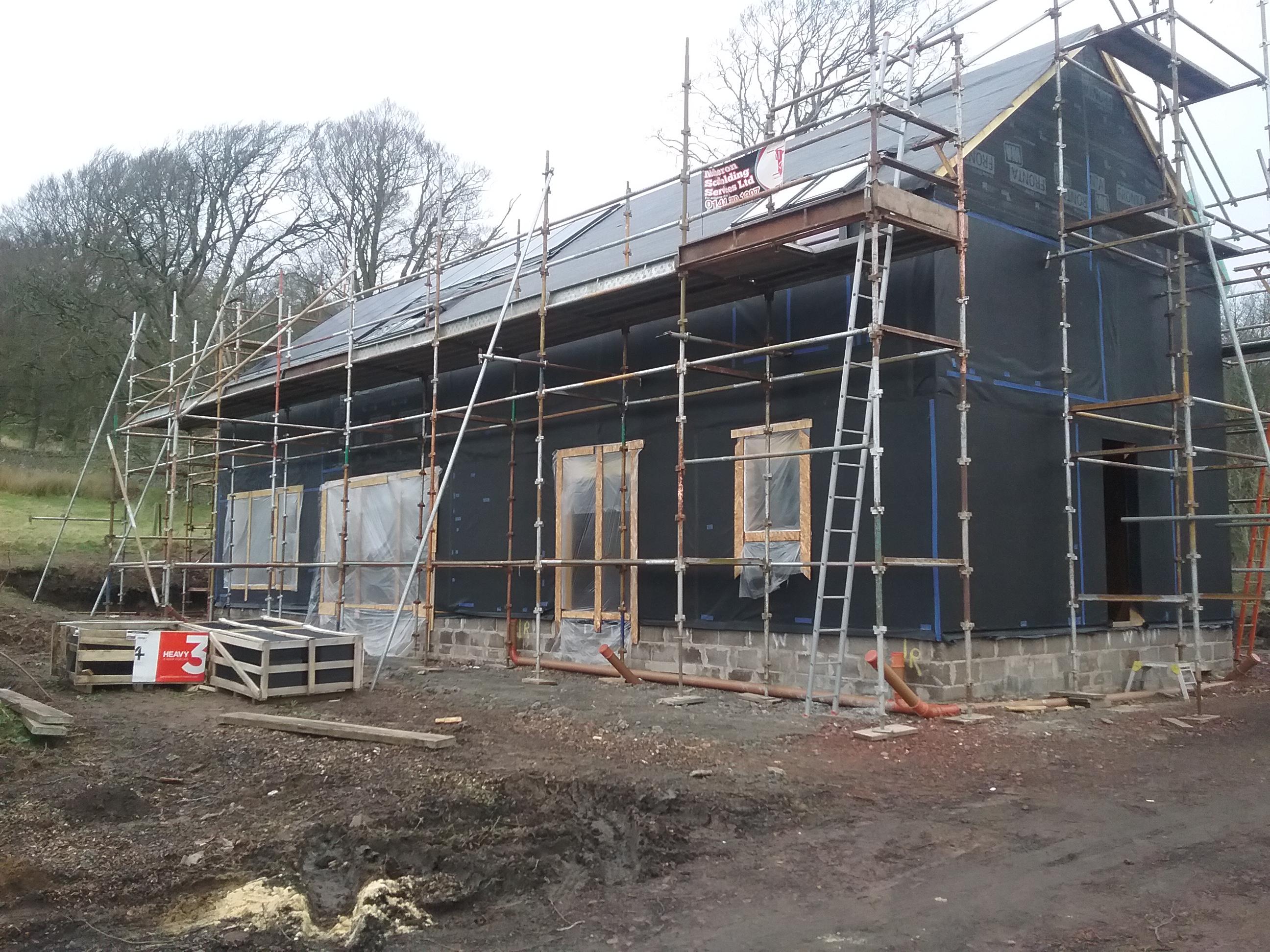

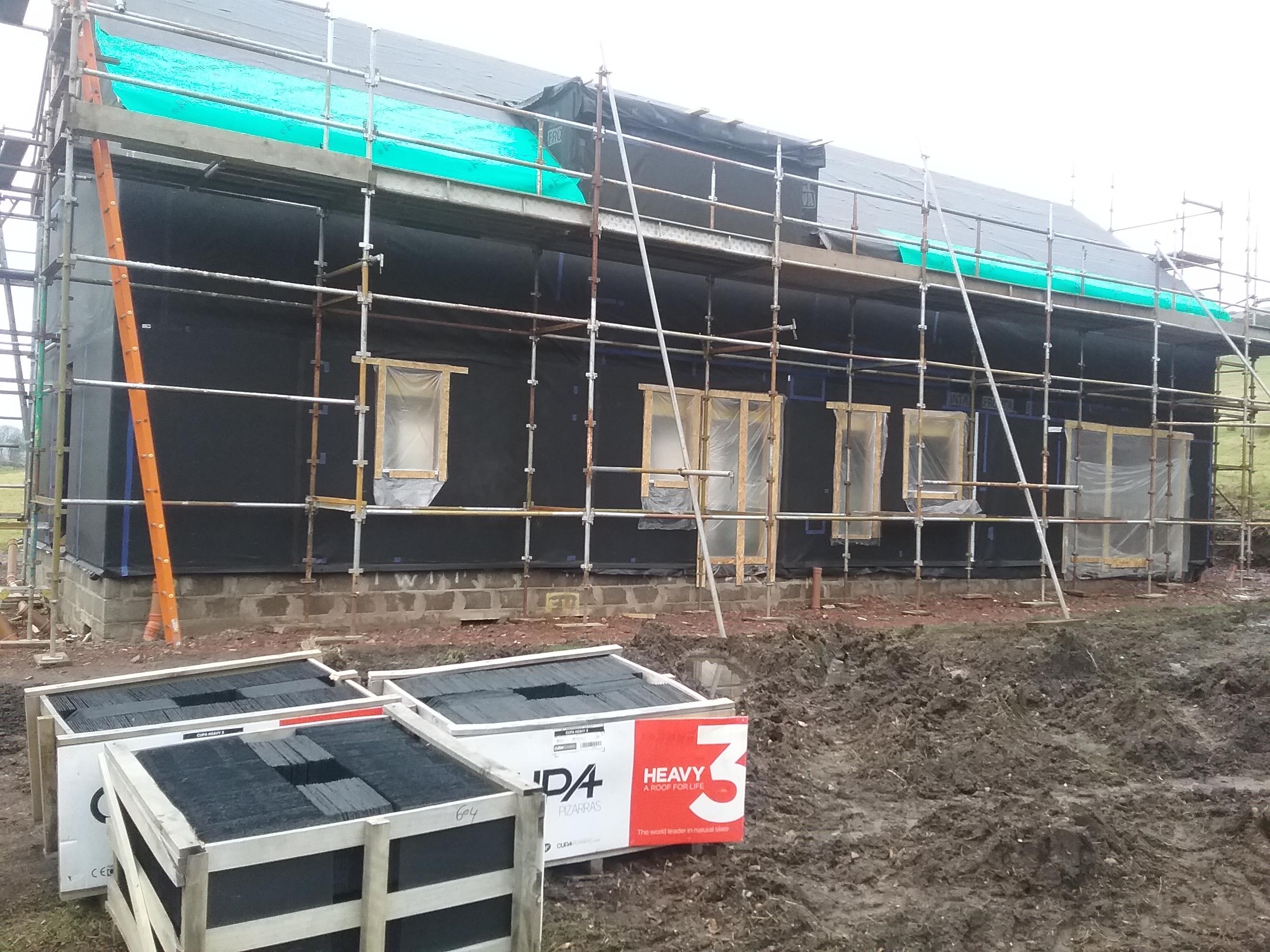

Thanks. The roofers are coming as a team, i'll be ensuring protrusions go in the right place; flue outlet, SVP, MVHR exhausts. I've had issues with the roof membrane; It was laid a month ago on a very cold morning; the sarking boards were saturated and frozen; i had the solar pv guys coming same day to fit the panel array, needing the membrane down first. Then it rained all afternoon and evening. All seemed fine until more rain a couple of days later; it then became evident the membrane was letting in water all over the place. Subsequent storms pre xmas resulted in the same issue. My conclusion is that the membrane has failed due the conditions when it was laid,,,,,,,,,, therefore i'm opting for a fresh layer of membrane to be laid on top before the slates go down!

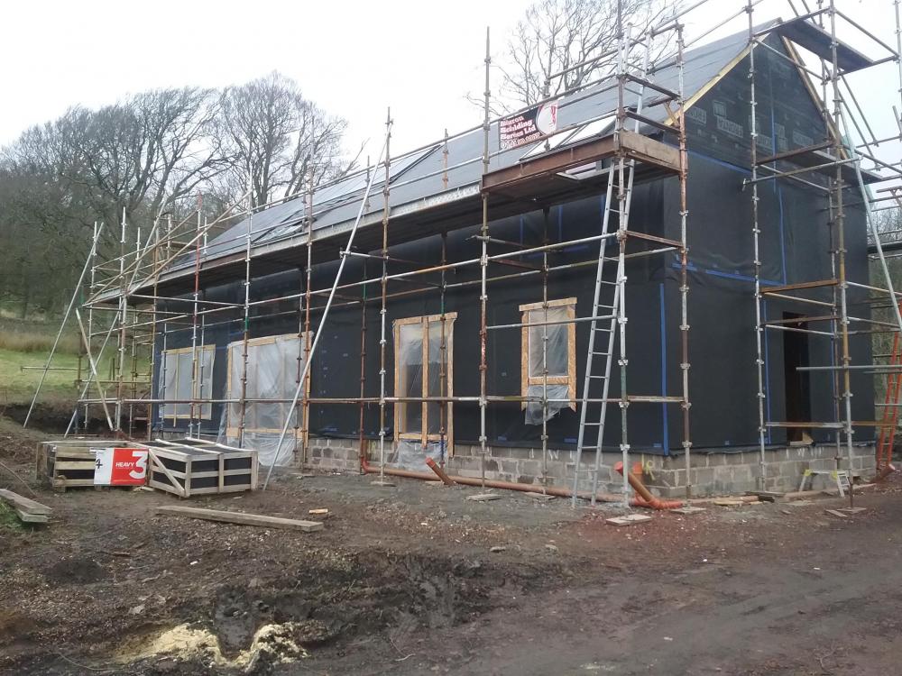

I only have single leaf blockwork to dpc supporting my timber frame......and everything else. See photos of current state, slaters here tomorrow.
