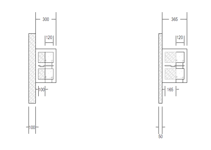

  8. Just in planning but am thinking of construction details. We are planning to use Ecobrix to construct the house and I have been thinking through the options. I haven't worked out u-values yet but will do that. I have attached a drawing of the two options, one using the 365mm width blocks, one the 300mm. The narrower has two advantages in that a) lighter, so easier to handle b) thicker contiguous insulation to outside Externally we will be going for timber clad on 3 sides, render on the other. I haven't worked out cost differences so that might have an impact but in the meantime would welcome thoughts. Please don't use this thread to discuss the merits or otherwise of Ecobrix, I know there are varying opinions, this isn't the place for that.
