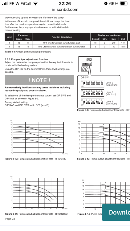

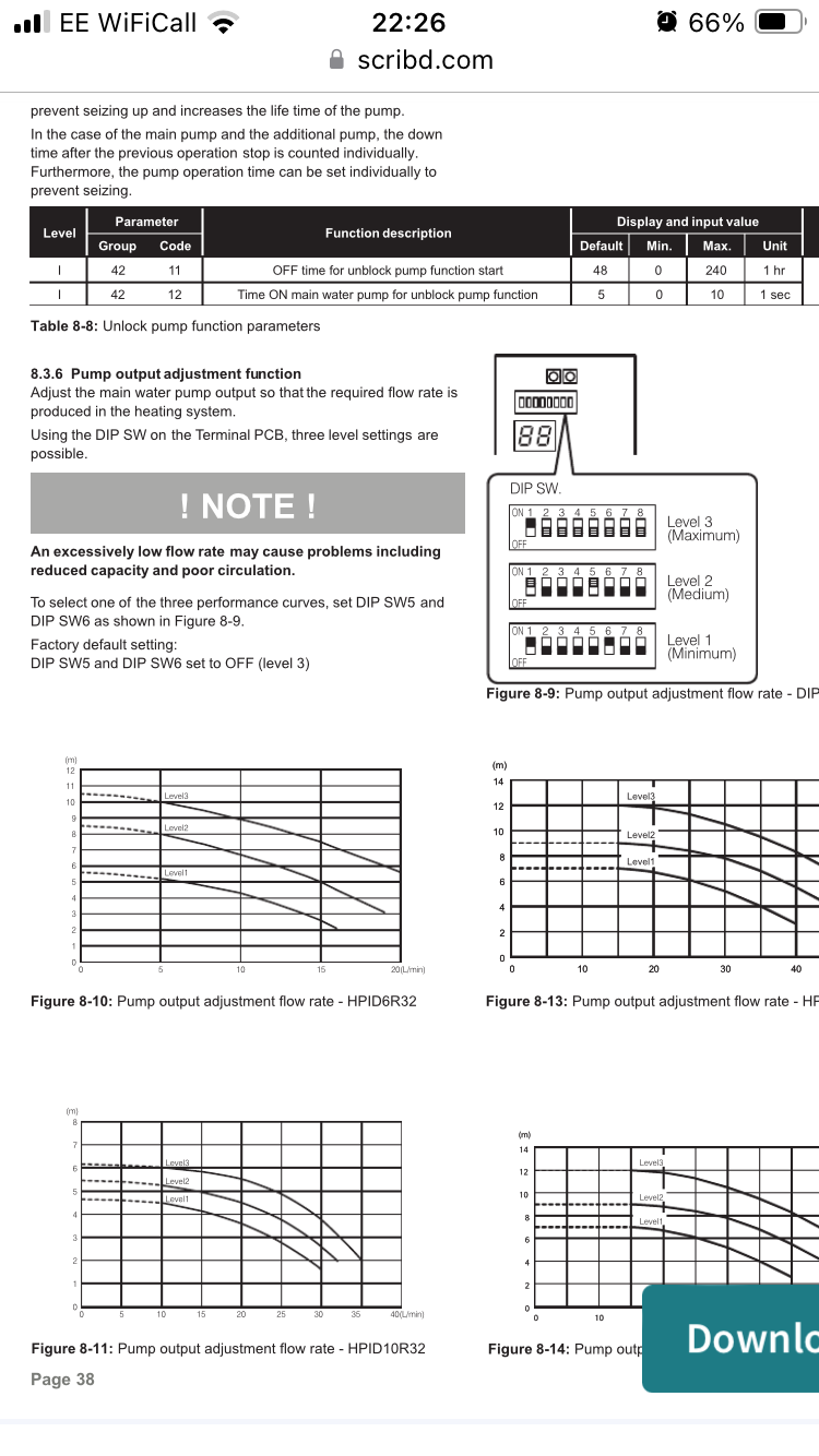

  3. Thanks. I don’t think it’s possible to decrease pump speed. It was already on the lowest setting.
  4. I switched dip switch 6 to off to take it from minimum to maximum. I think that increases the pump speed which would increase the volume? for the differential between flow and return, would that be a parameter setting or would additional volume make the difference? Normally it’s about 4 or 5 degrees but as you say should be higher.
  5. I got in this morning and it was set to minimum and also frost protection set to off. I have set it to max and left frost protection as it was for now.
  6. I’ll have a look into this in the morning. Thank you.
  7. Interesting, thank you. The difference I get tends to me about 5 degrees. I wonder if mine is at level 2 or 1. After a frost cycle in very cold temps, I find the flow temp struggles to get back up and will just about hit 40 before the frost cycle kicks in again and it has to start again.

  11. I do actually think it should have a volumiser retrofitted and I’m in discussions with Grant for making sure that’s done before next winter. I challenged them about the failure to reach 21 in very low temps. It’s supposed to deliver 22 at -5.4 degrees outside but it doesn’t. I found in their paperwork that it should have either a LLH or a volumiser, but my install seemingly doesn’t and their grade 1 installer had deemed it not needed due to the heat loss calculations and type of property.
  12. Yes I know, I just couldn’t be bothered to correct it. Do you mean the weather comp curve parameters? Pretty sure those are ok. It’s set to flow 50 degrees at 0.
