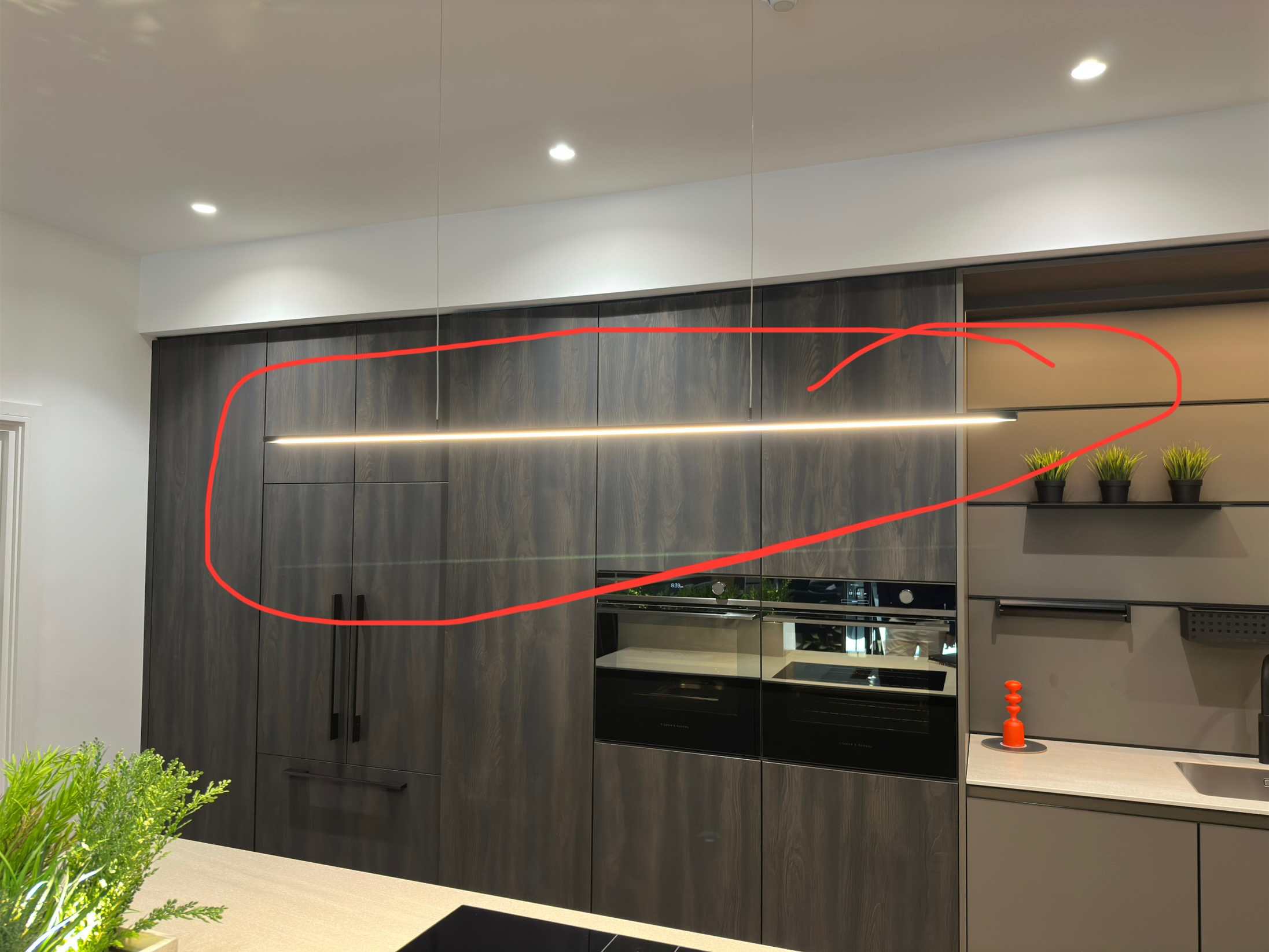

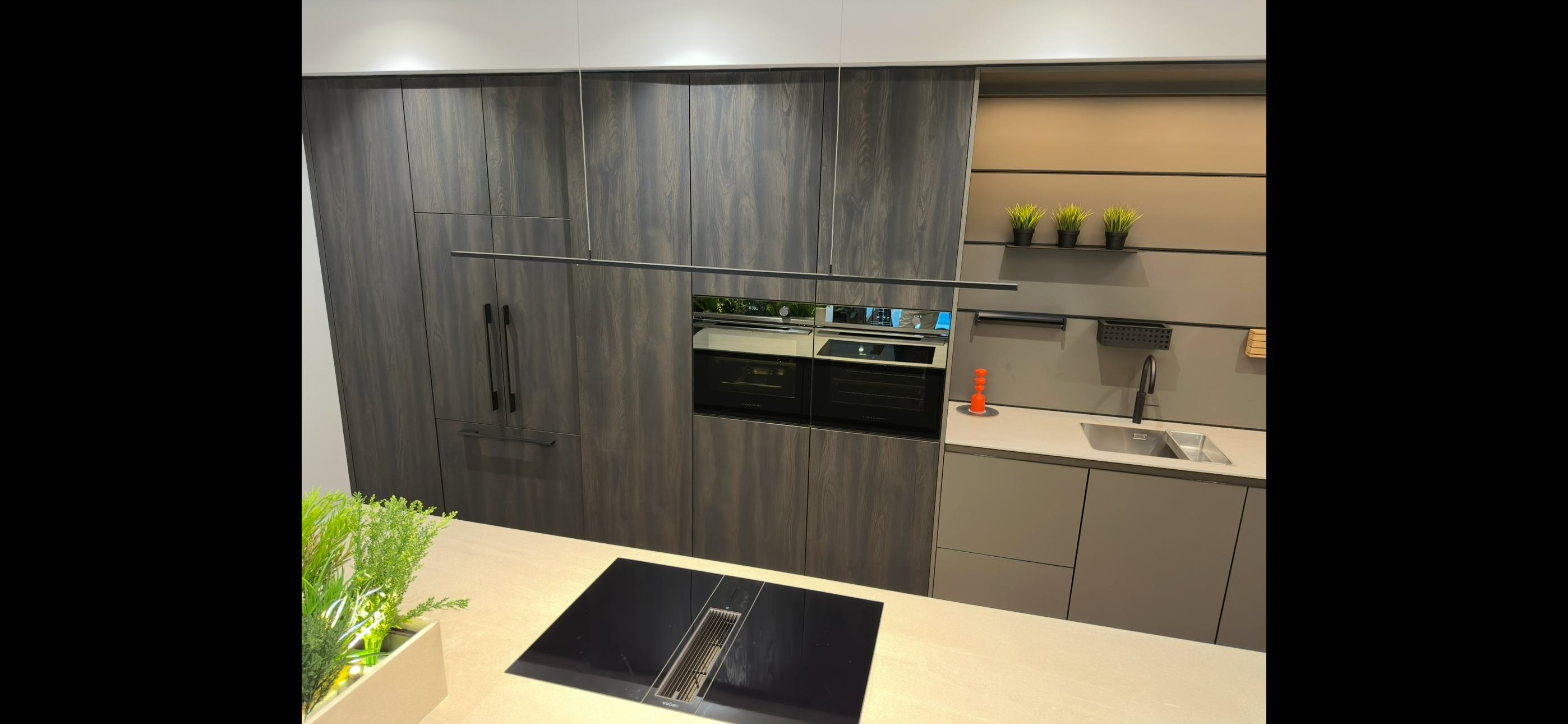

    a bit light that but no ceiling box at all . I can only assume that the driver is in the ceiling void ?
  2. Firstly anyone seen this light anywhere , it’s not the Bora light (frightening price) in a kitchen shop very slim no visible driver ( must be in ceiling) shop says it’s always been there and asked where it came from and nobody can tell me 😂 secondly is it your electrian who deals with your data cabling ( daft question I guess but only because I’m not sure 🤷🏼‍♂️)

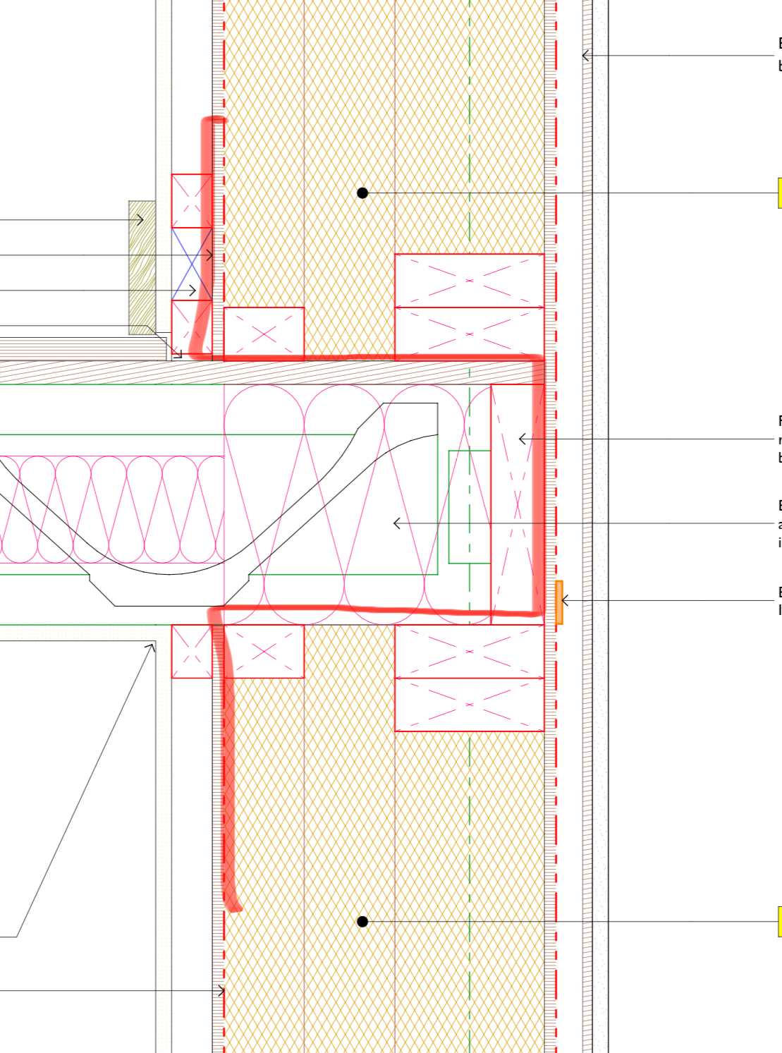

  12. Nic
    Airtightness
    This is a cross section of my build between floors sorted. I noticed that there was not a complete airtight barrier between first and ground floor floor. Would what I’ve drawn work ok ? Then obviously taped to the first and ground floor membranes

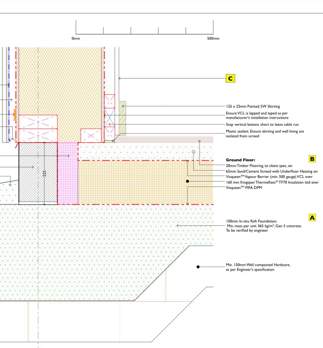

  22. thanks , and is there any type of wet UFH that is better when in screed ?
