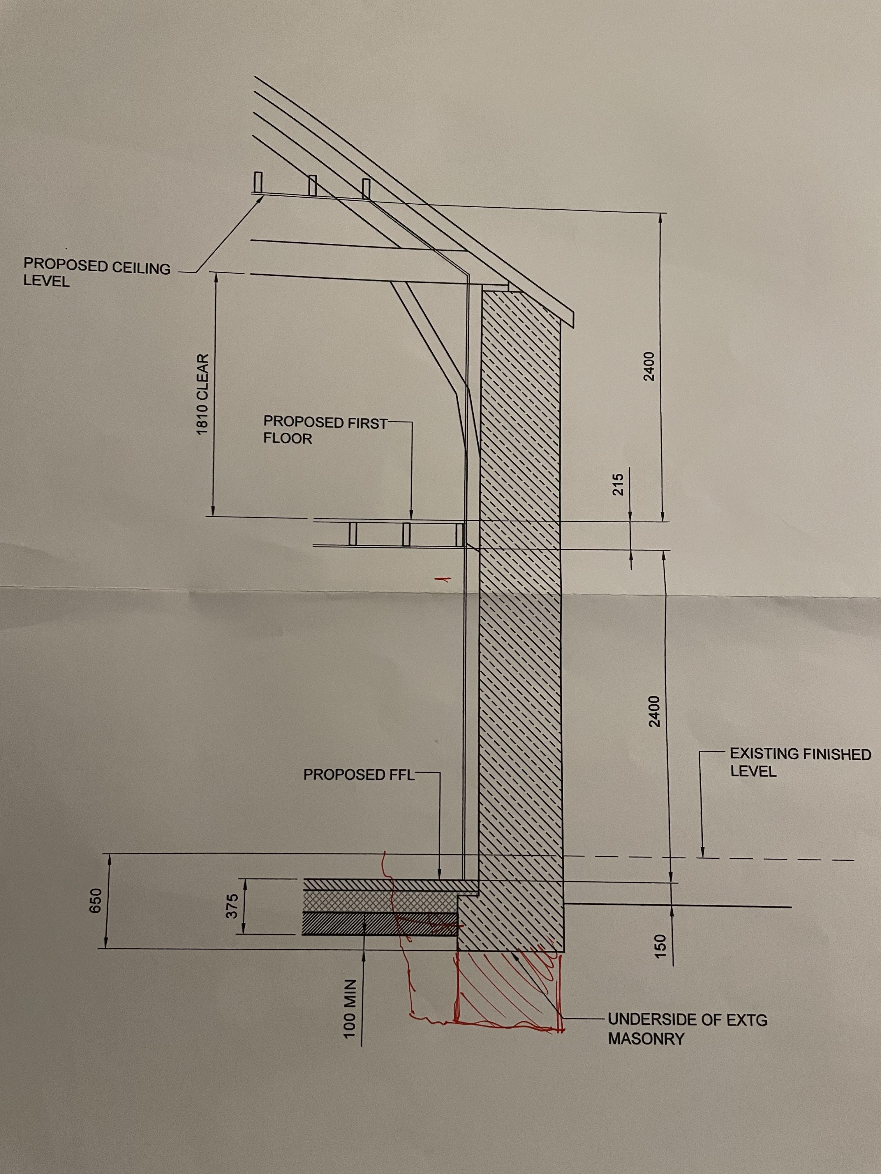

  1. I like the French analogy, but go gently on me as I'm new to this! Are you suggesting stepping back from the outer walls to dig down, or just going down in line with the outer walls? Would you then create the pad on which to place the XPS and then creating the layers beneath the FFL?
  2. This sounds very logical. How did you practically feather-in the lower edge of the new inner slab and can you remember what sort of space you were dealing with? Our challenge is the height of the timbers in what will be the 2nd floor as even if we are super creative we are struggling to get more than 1.8M under the main timbers (which are the original elm beams and have some listed restrictions on so can't be changed)
  3. No. There is no slab at the moment, so we were discussing how much could be scraped out without causing a problem. Had trial holes dug to test the ground. It looks like the barn was built on a shallow layer of hardpacked rubble so not a lot of foundations to play with
  4. We're still finalising details on our barn conversion, but in conversation with our SE and we have a bit of a dilemma since we have a very restrictive amount of total height available to us and this appears to have a significant impact on the amount of insulation we can put in below FFL (see his sketch attached). We are trying to avoid having to underpin the whole building and so I really need some of your combined experience and opinions to consider how we can achieve maximum insulation under the FFL.
