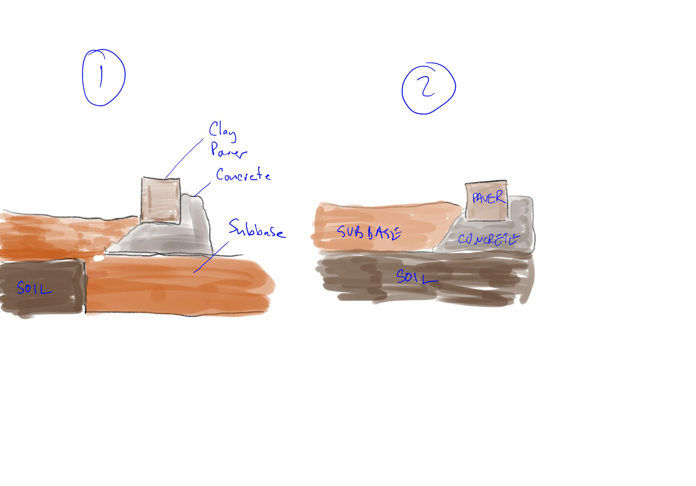

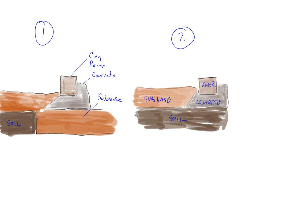

  5. Thanks, yes that’s what I thought. That’s what did when laying the edging sections for the patio area but saw something recently which seemed to suggest you can lay concrete on the sub soil. It won’t take long to dig a shallow trench so I’ll do that. 👍
  6. Hi, I’m mulling over the best way of laying clay paver edging at the perimeter of my garden (by the fence). I will be laying decorative gravel with a stabilisation grid and want the edging to restrain the gravel. Can I lay the edging on concrete which is laid directly on top of the soil or do I need to lay the concrete on a sub base? Basically deciding between option 1 or 2 below. Any recommendations/advice? cheers, Ed

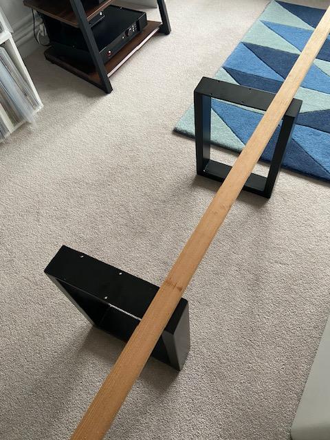

  7. Yes that sounds like a plan. I could put a number of stiffening cross beams along the length.
  8. Of course, I could buy more legs!
  9. Ahh I see. No the supports are a square section, so yes you're right they could be. I'm slightly concerned that there will not be enough strength in the cedar battens so might need to make a stronger frame for them to sit on underneath. This is the maximum span in the photo below:
  10. Hi! Thanks for the comment. Can you explain what you mean here please?
  11. Hi everyone, I'm planning to make a corner bench out of cedar like the one in the picture. I have a lot of spare cedar (18mm x 44mm section) from another project which I can use for the slats. I'm now looking into how I will assemble it. Cedar is very soft and I want a sturdy bench so I'm wondering whether it is best to use a different wood for the cross supports (indicated by the blue arrows in the second picture)?. What do you think? In the shown model I have used 18 x 68 mm section cedar but these cross supports won't be on show so I'm thinking of making them out of another material. The supports are directly attached to the legs Ed

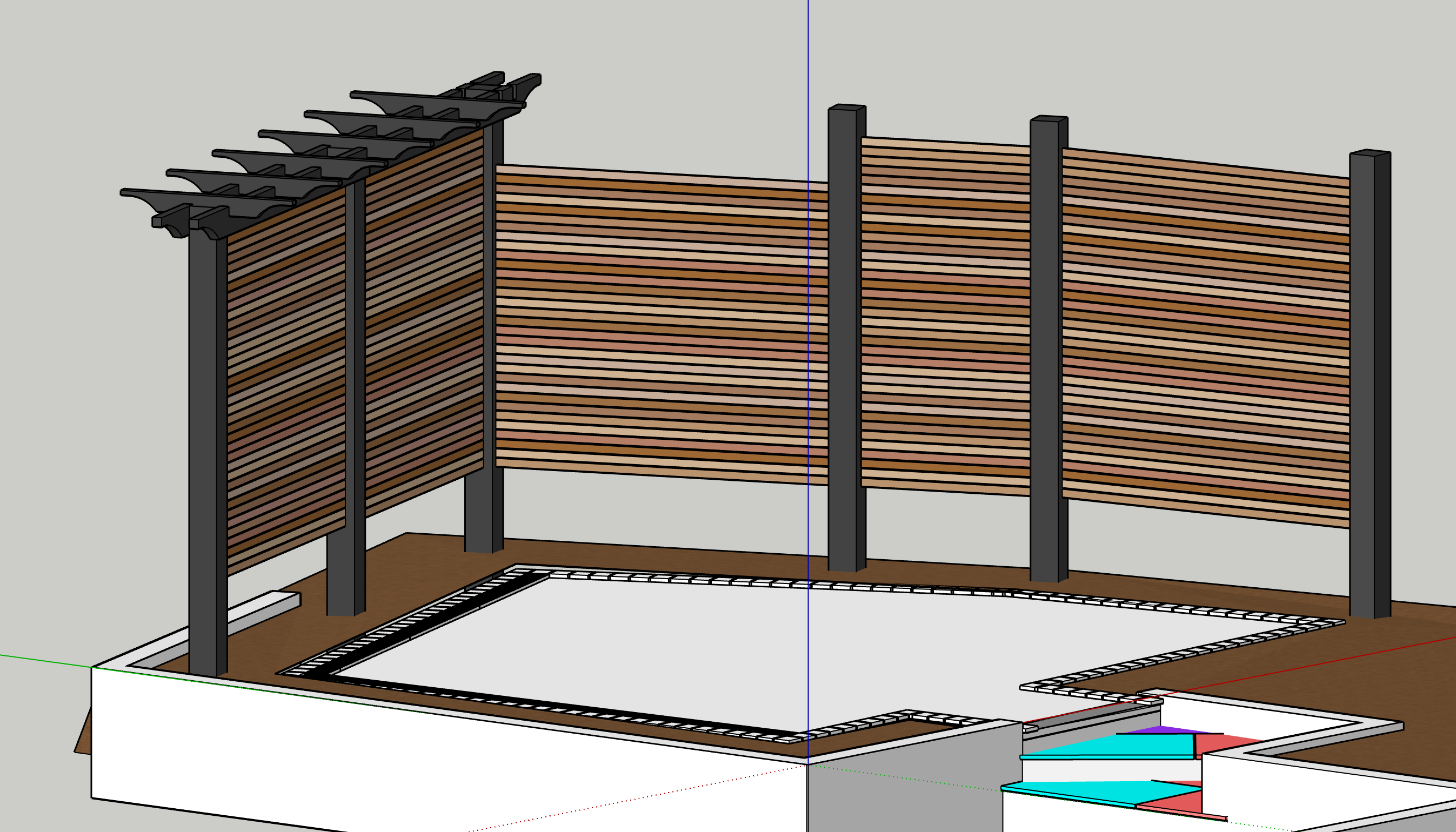

  12. Yes, I think this is the best way to ensure consistency of panel. We are going to planting flowers around bottom too so should be hidden. I will just have to reduce the height of the inserts to fit

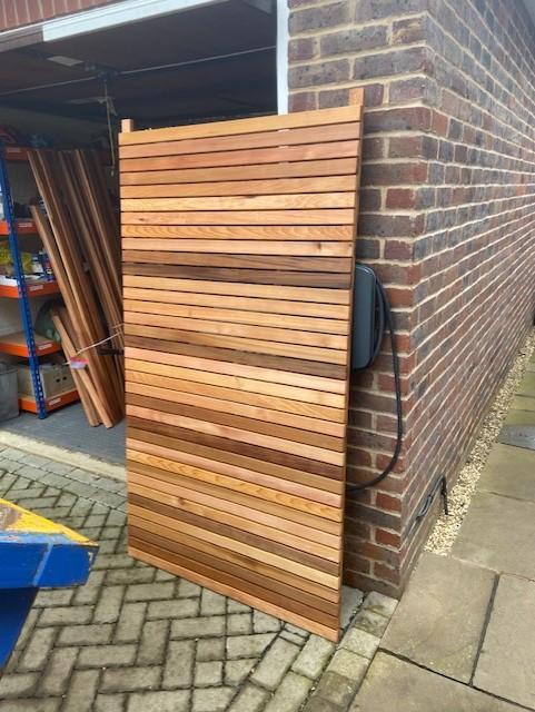

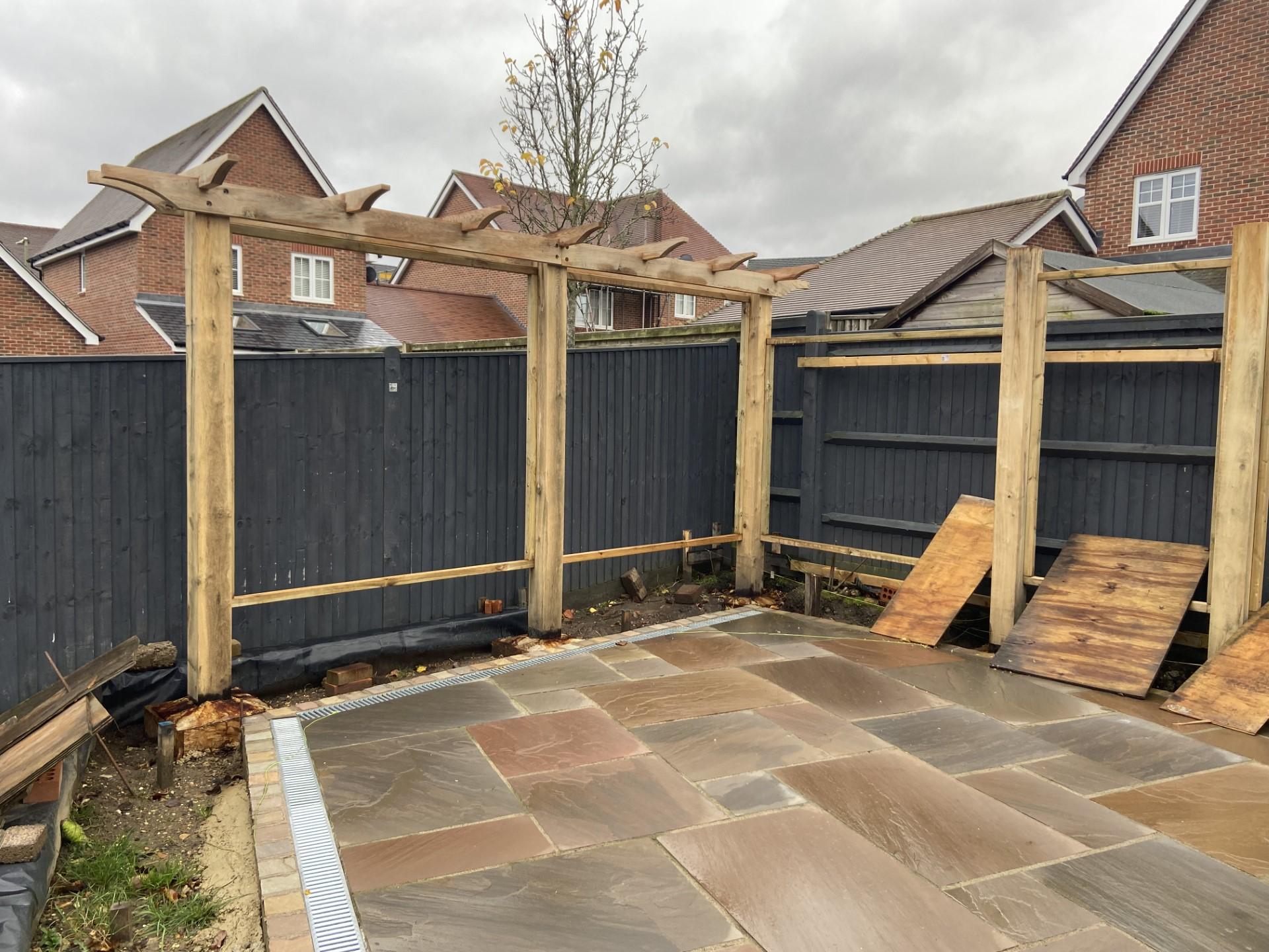

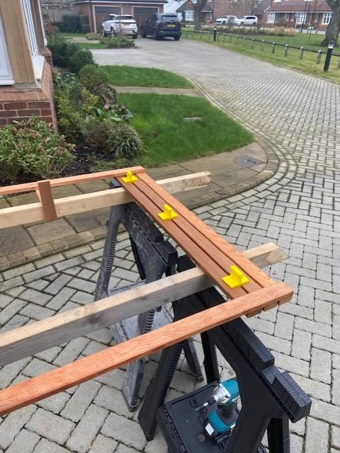

  13. Hi everyone, I'm ticking along with the garden landscaping and now starting to make up the cedar panels for the screen/pergola thing (See sketchup image).... I used a number of 150x150mm oak posts and made a frame that sits on the insides of the posts (See photo). The cedar battens are 44mm wide and with a 6mm gap between successive battens the planned height of each screen is 1794mm. I therefore made the frame 1794mm tall. I was toying with how I would make the screens and in the end I wanted a modular design so that I could remove the panels easily if I need to do maintenance on the fence etc, otherwise I could have installed each batten directly to the frame insert. Initially I was going to make each screen like this: Option 1 - https://youtu.be/isQc31uW2_0?si=PNjtrbVbdzPNVd3I. Here the vertical battens are marked with a tape measure where each horizontal batten should go and then the battens are positioned by eye on the marks before being screwed. This would ensure that the screen was perfectly the right height at the expense of getting an absolutely identical gap size. After chatting with my wife (not blaming her!) we discussed another method: Option 2 -whereby I used a 6mm spacer to lay the battens one by one and build it up that way. I opted for this method in the end to ensure a consistent gap size. However.....due to tolerances in the batten sizes etc the final panel size has come out at 1740mm for one panel and 1750mm for another. I kind of new this was going to happen so not sure why I opted for it. Anyway, the panels look great and the gap size is consistent but they are not as designed and will potentially all be different sizes. Given that I have 150mm Oak posts between the panels I think I could still use the panels as the difference is 10mm but I would have to modify the frame insert, which is doable. This could potentially be different for every screen and something inside of me doesn't like it, it'll basically be a bodge and rely on the viewer not noticing the difference in size of panel. I'm now toying with the idea of going back to option where I measure where each batten should be then manually place them at each location which will ensure the panel is the correct size. I should be able to reuse all the battens as everything is screwed from behind so you wont see any existing holes etc. Any recommendations/comments? Ed

  17. Hi! I'm having some cedar battens delivered tomorrow and will be starting to make the panels shortly. I have an Evolution 255DB+ compound mitre saw which has worked well for me so far. I currently have multipurpose blade that came with the saw on it. Do you think I should buy a fine wood cutting blade like this? https://shop.evolutionpowertools.com/collections/evolution-blades/products/255mm-fine-wood-blade-60t Seems fairly pricey. I'm setting up a stop block which should aid the cutting process. Any guidance/comments welcome. Many thanks, E

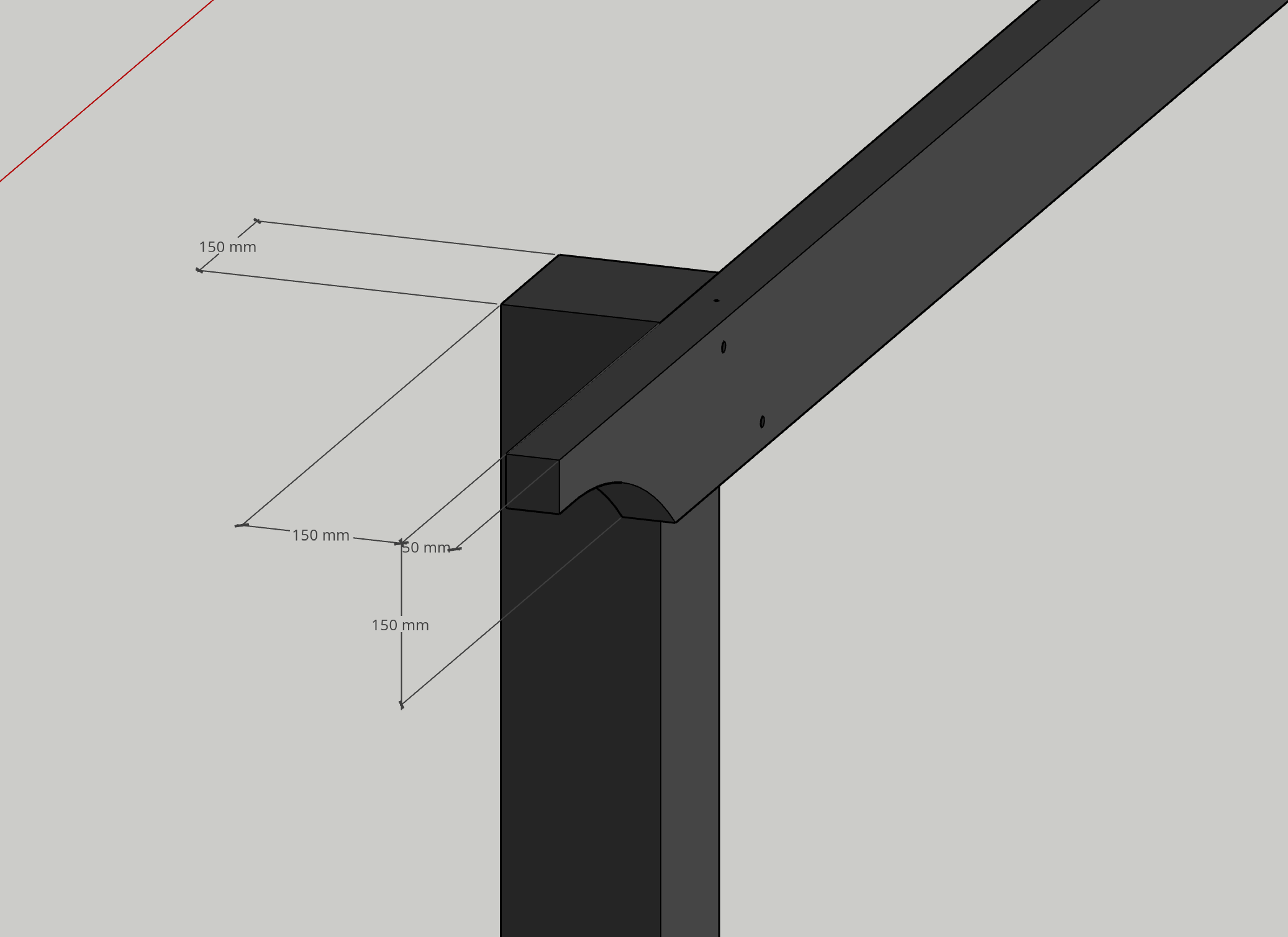

  23. What diameter of screw do you recommend?
  24. Thanks for the comment. Yes I’ve heard they are softer. I will try and use a normal steel screw to fix then replace with stainless steel as well as a generous pilot hole.
